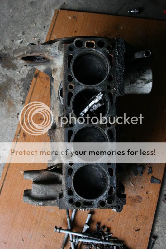

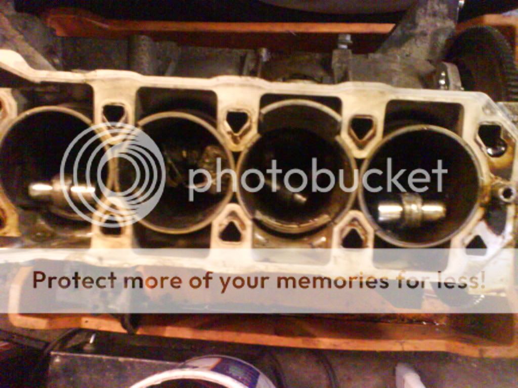

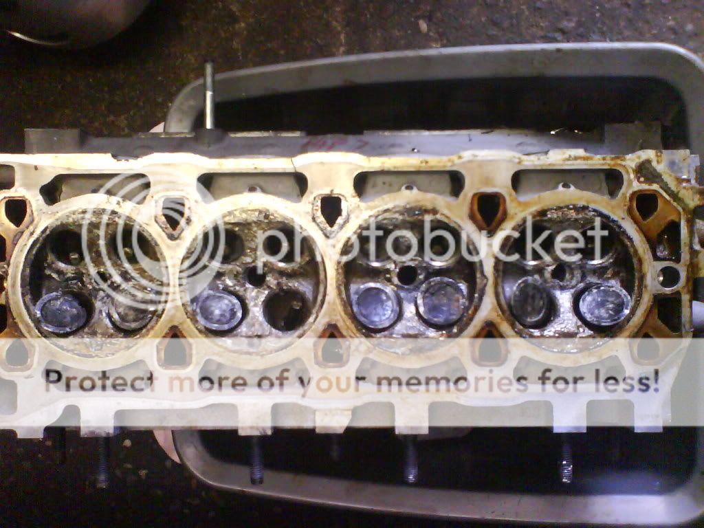

A lady my dad worked with had her MG TF from new, never had it serviced from the day it was bought. These are the results.
https://i302.photobucket.com/albums/nn82/mr_fisty/DSC00314.jpg
Every valve bent or missing
https://i302.photobucket.com/albums/nn82/mr_fisty/DSC00315.jpg
Every piston disintigrated, there is a huge hole in the block too.
https://i302.photobucket.com/albums/nn82/mr_fisty/DSC00316.jpg
Cambelt went causing a large scale piston/valve/everything interface.
All because she was too tight to get it serviced.[/img][img][/img]

Your telling me, 53 plate car with 38,000 miles and the bill is going to be around the 3K mark. Thats if a new engine can be found. She wont have a second hand one! tart.

Nice, still not servicing it didn't really kill it, just the not replacing the cambelt, if she'd done that it probably would've lasted another 80,000 or whatever it'd done. Though oil changes would help too, surely she did at least one, otherwise I would think she'd have run out of oil eventually as it got thinnner and burnt or leaked out.

A cambelt check/change is part of the service schedule. Also having it serviced regularly may have seen the frayed cambelt get noticed.

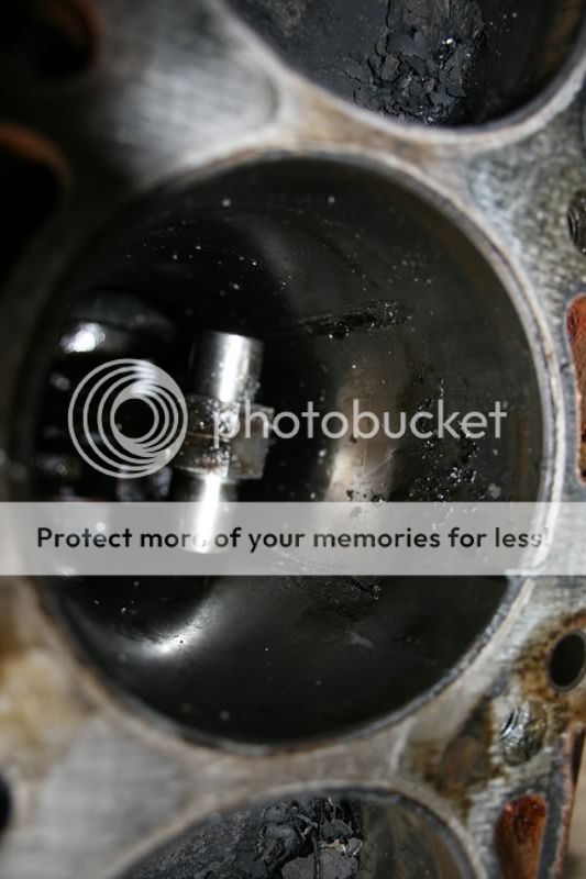

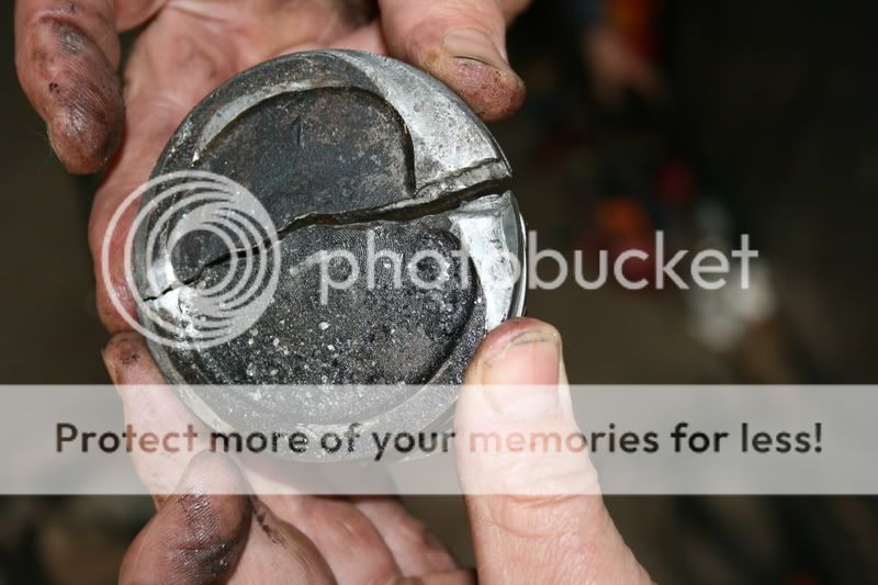

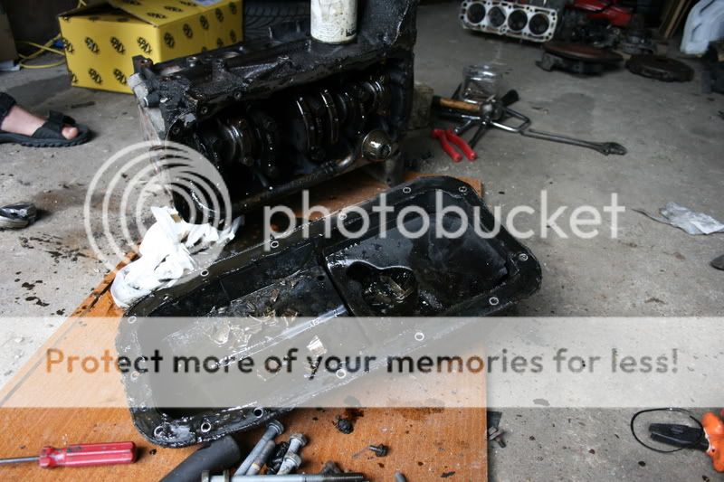

This is my old Corsa engine! When it went it was very boring, simply cut out, I was hoping to have rods through the blocks and all sorts!
https://i18.photobucket.com/albums/b112/GrahamVFR/Corsa/Engine%20Failure/IMG_3197.jpg
https://i18.photobucket.com/albums/b112/GrahamVFR/Corsa/Engine%20Failure/IMG_3217.jpg
https://i18.photobucket.com/albums/b112/GrahamVFR/Corsa/Engine%20Failure/IMG_3239.jpg
https://i18.photobucket.com/albums/b112/GrahamVFR/Corsa/Engine%20Failure/IMG_3249.jpg
