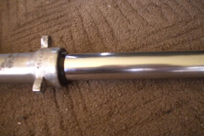

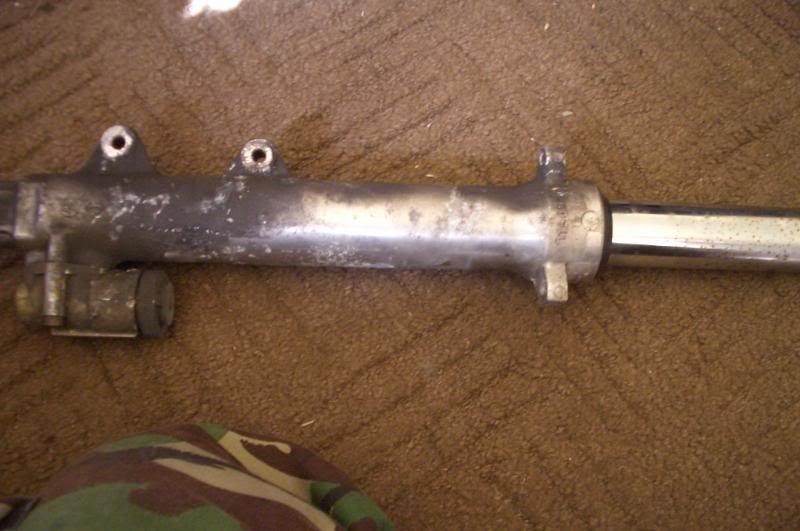

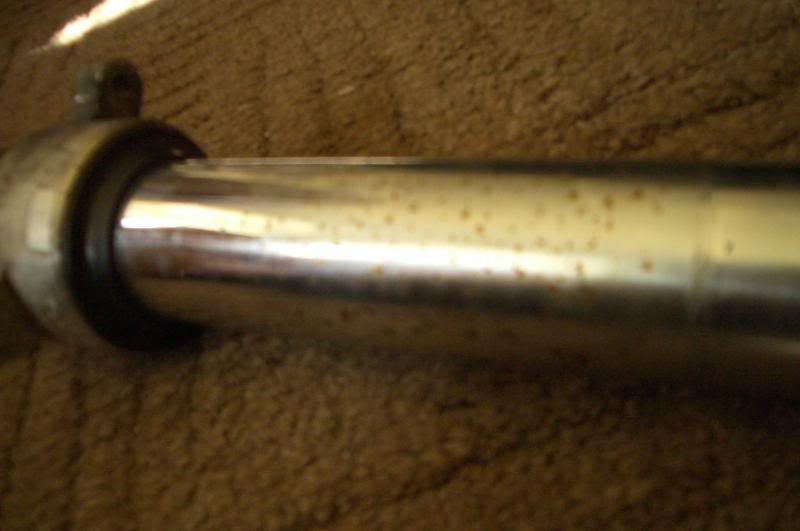

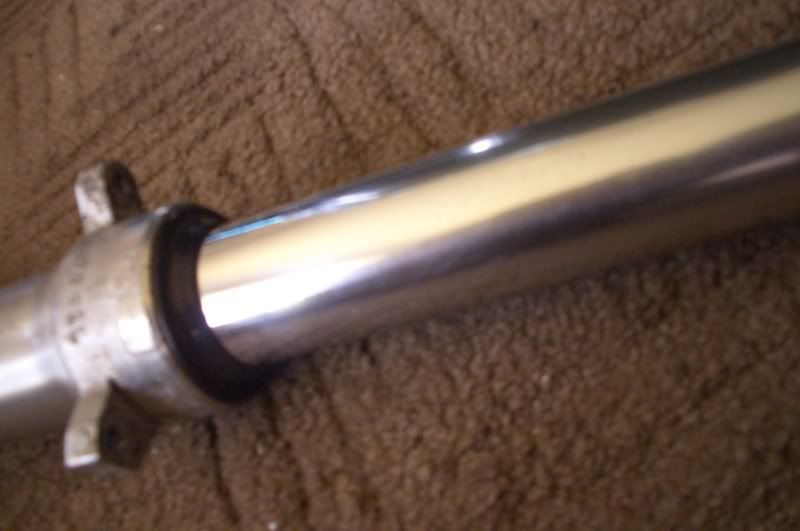

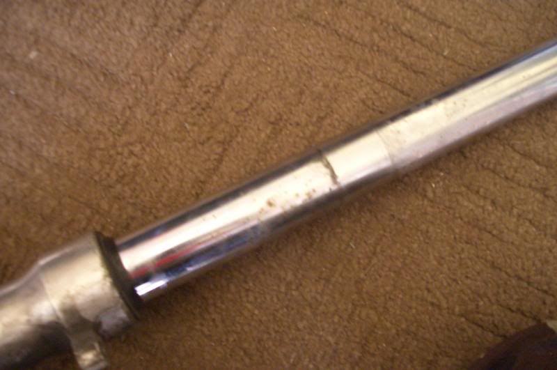

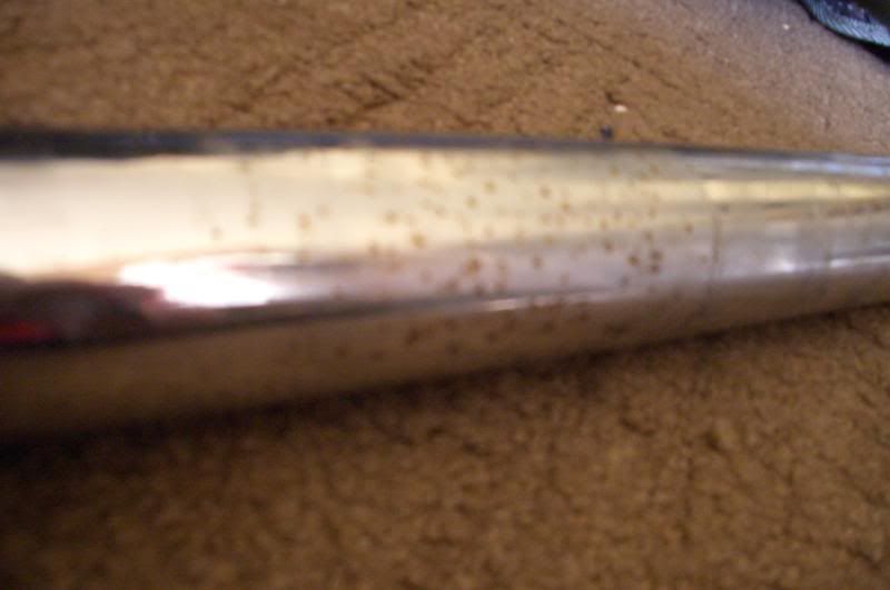

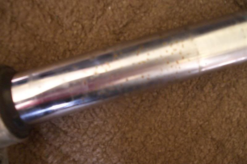

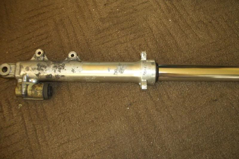

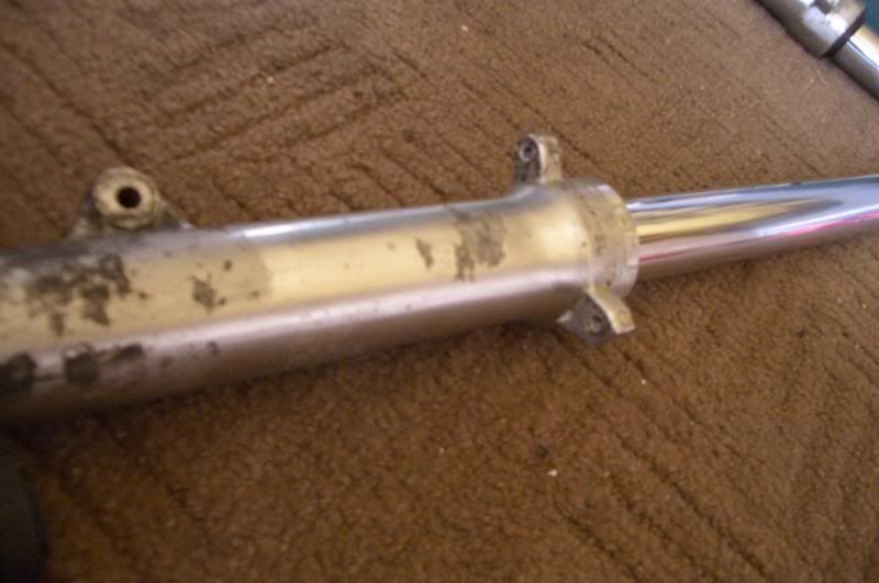

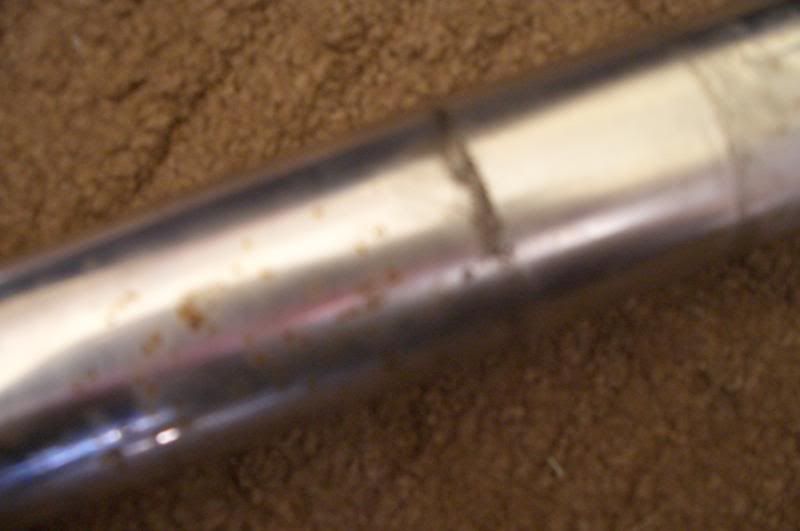

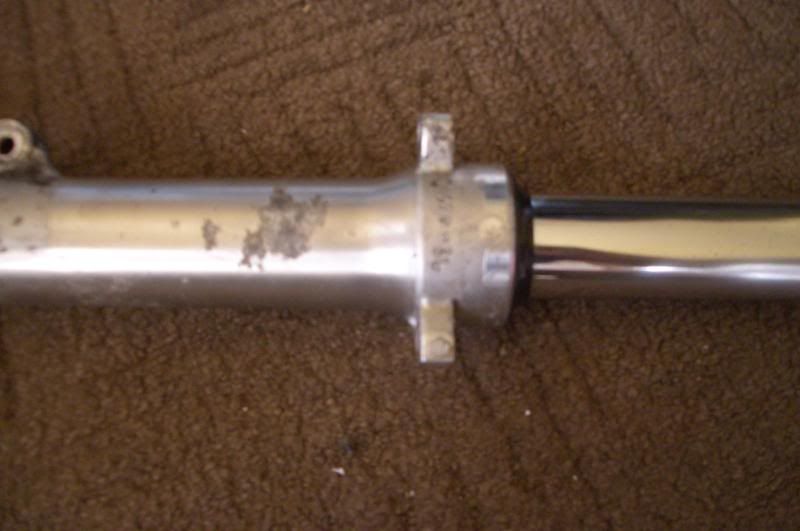

After a few weeks fuckabout with forks (I've learned not to take people's word for it that something will fit) I decided to try and use the original ones.
Looking at them, they weren't quite as bad as I'd thought. Majority of the rust spots are surface.
https://img.photobucket.com/albums/v246/super_jo/forks_b4-1.jpg
https://img.photobucket.com/albums/v246/super_jo/forks_b4-2.jpg
https://img.photobucket.com/albums/v246/super_jo/forks_b4-3.jpg
https://img.photobucket.com/albums/v246/super_jo/forks_b4-4.jpg
https://img.photobucket.com/albums/v246/super_jo/forks_b4-5.jpg
https://img.photobucket.com/albums/v246/super_jo/forks_b4-6.jpg

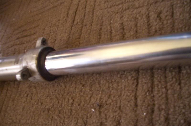

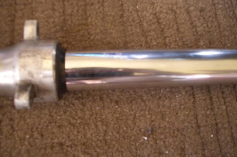

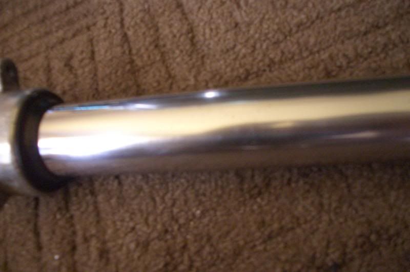

Went at them with autosol, a couple of tiny pits had made it through on one fork so that got the 240 wet & dry.
All smooth to the touch, hopefully keep the seals in the good condition they are now.
https://img.photobucket.com/albums/v246/super_jo/forks_after-1.jpg
https://img.photobucket.com/albums/v246/super_jo/forks_after-2.jpg
https://img.photobucket.com/albums/v246/super_jo/forks_after-3.jpg
https://img.photobucket.com/albums/v246/super_jo/forks_after-4.jpg
https://img.photobucket.com/albums/v246/super_jo/forks_after-5.jpg
https://img.photobucket.com/albums/v246/super_jo/forks_after-6.jpg
https://img.photobucket.com/albums/v246/super_jo/forks_after-7.jpg
https://img.photobucket.com/albums/v246/super_jo/forks_after-8.jpg
https://img.photobucket.com/albums/v246/super_jo/forks_after-9.jpg

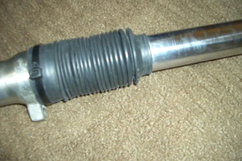

Gaitors on for protection and to be sure at MOT time.
https://img.photobucket.com/albums/v246/super_jo/gaitor1.jpg
https://img.photobucket.com/albums/v246/super_jo/gaitor2.jpg

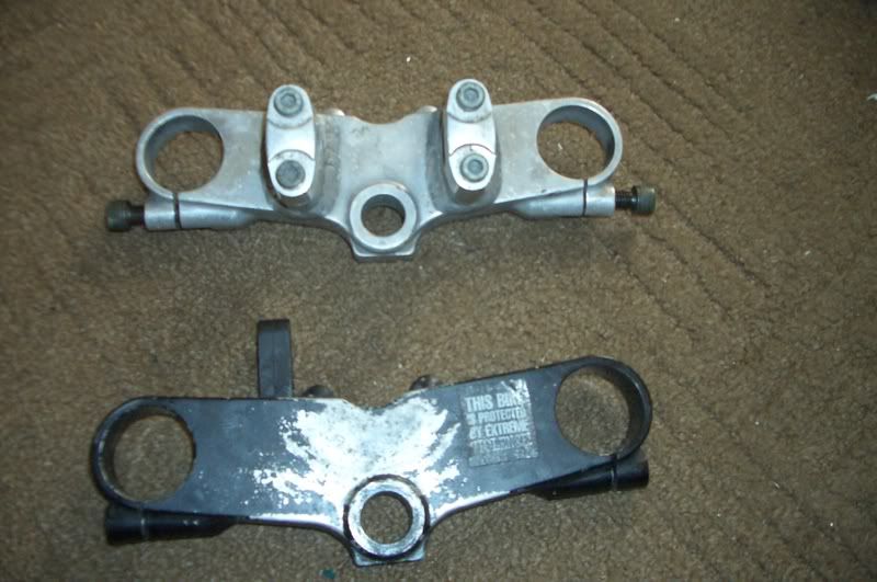

Also got a new top yoke in the post this morning, with risers welded on. I know it's not the tidiest job in the world, but it will do for now!!
https://img.photobucket.com/albums/v246/super_jo/topyokes.jpg
https://img.photobucket.com/albums/v246/super_jo/topyoke1.jpg

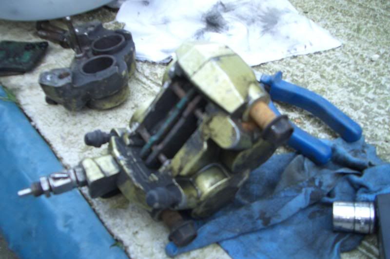

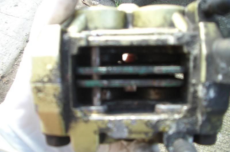

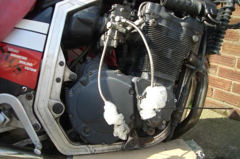

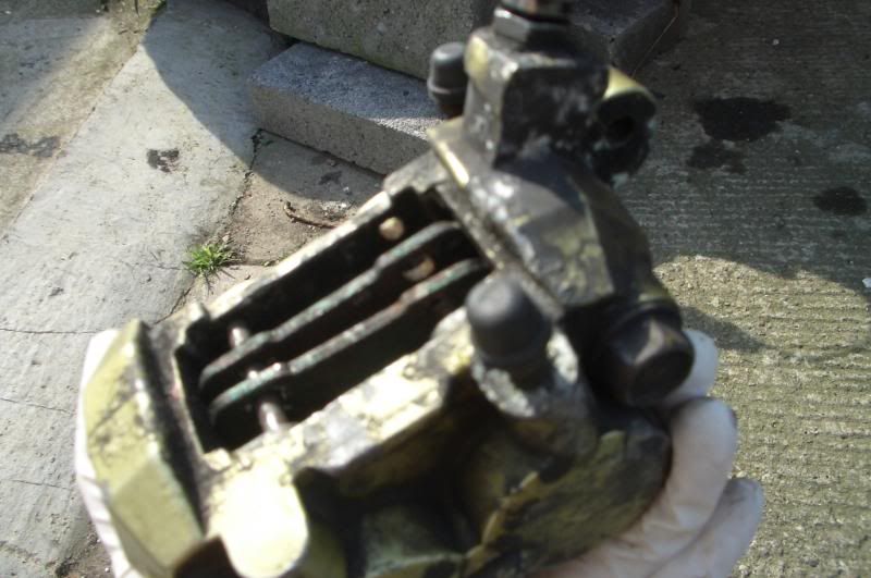

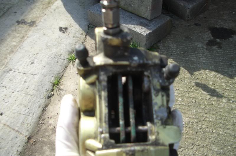

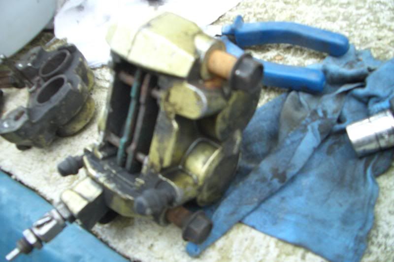

Front calipers, well they were a twat to remove when I took the wheel off. Only got round to looking at them properly now. Took them off the bike after struggling for a bit with them still attached. Put plastic bags over the hoses to stop drippage/contamination.
https://img.photobucket.com/albums/v246/super_jo/brakehoses.jpg
And so, can I now say for the first time in my biking life, and I suspect not the last, FUCKING SUZUKI CALIPERS!!! Laughing
https://img.photobucket.com/albums/v246/super_jo/caliper_b4-1.jpg
https://img.photobucket.com/albums/v246/super_jo/caliper_b4-2.jpg
https://img.photobucket.com/albums/v246/super_jo/caliper_b4-3.jpg
https://img.photobucket.com/albums/v246/super_jo/caliper_b4-5.jpg
https://img.photobucket.com/albums/v246/super_jo/caliper_b4-6.jpg

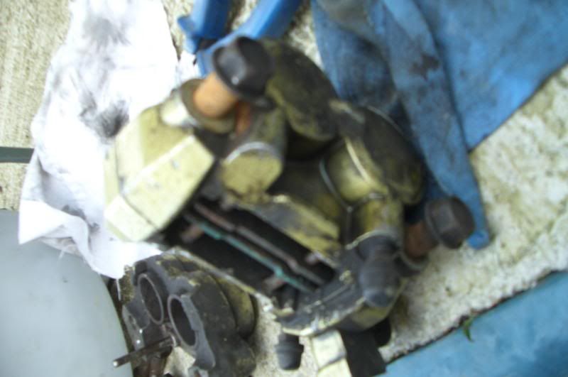

Pins were seized to buggery, even after splitting the first one I could only get one pin out.

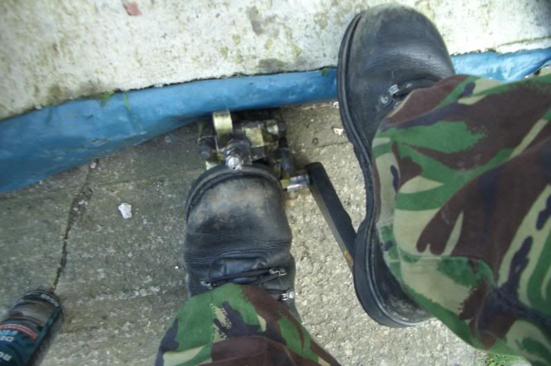

It was tough getting the bolts out to split them, however. I had no vice so had to improvise:
https://img.photobucket.com/albums/v246/super_jo/caliper_hmadevice.jpg
This worked ok for the first caliper (with lashings of loctite freeze n release), but I struggled keeping the second one balanced correctly. Eventually had to stand full on it, with it propped between the kerb thing and a an old door, and STAMP repeatedly on the ratchet handle...it bloody worked though! Razz
Here's the second one, this photo shows the particularly stubborn bolt, and it's little cosy bed of powdered rust Shocked
https://img.photobucket.com/albums/v246/super_jo/caliper_b4-8.jpg
After doing that, I downed tools and went inside for a beer and fag. Got a knock on the door, seems a lad who is training at the bike school downstairs clocked the calipers strewn outside, and offered to take them away and sort them!
He's an engineer apparently, either he'll tip up tomorrow with shiny unseized calipers for me, or they'll come back ruined!!! Worth a gamble I reckon, there was no way those pins were coming out for me and it was frustrating me and pissing me off.

Why did you want to remove the pins once split? No need once split surely, can easily change the pads without.
Having worked on sv650 calipers before recently, I'll never bother to touch suzuki pins again and just split em! Laughing
Mudskipper
PostPosted: 18:58 - 17 Sep 2008    Post subject: Reply with quote
To clean/grease them so next time I can hopefully change the pads without splitting!!! Laughing
Lad who took them did an ace job, they are lickable now. Have put them all back together so they are ready to go back on once headstock/brake line sorted. Very Happy
