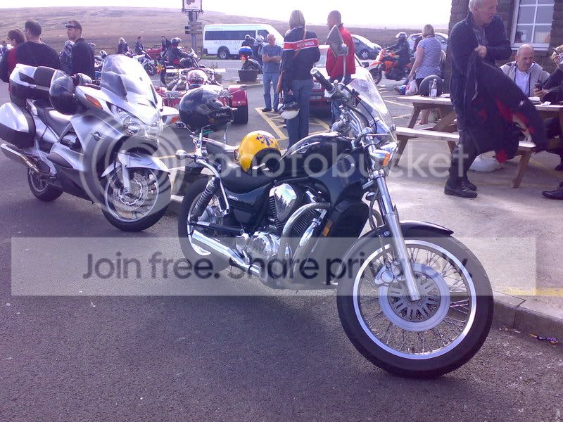

Here is a pic of the offending blob taken yesterday at the Cat & Fiddle...........
https://i12.photobucket.com/albums/a229/Yambabe/21092008204.jpg

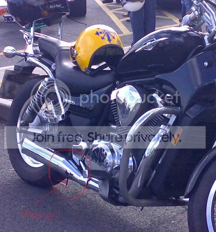

Here's a close-up pic:
https://i12.photobucket.com/albums/a229/Yambabe/blob.jpg
PostPosted: 21:31 - 22 Sep 2008    Post subject: Reply with quote
Autosol is chrome and metal polish. I suggest white spirit. That's what me and my dad used on his RD exhaust when his boot melted to it Thumbs Up
