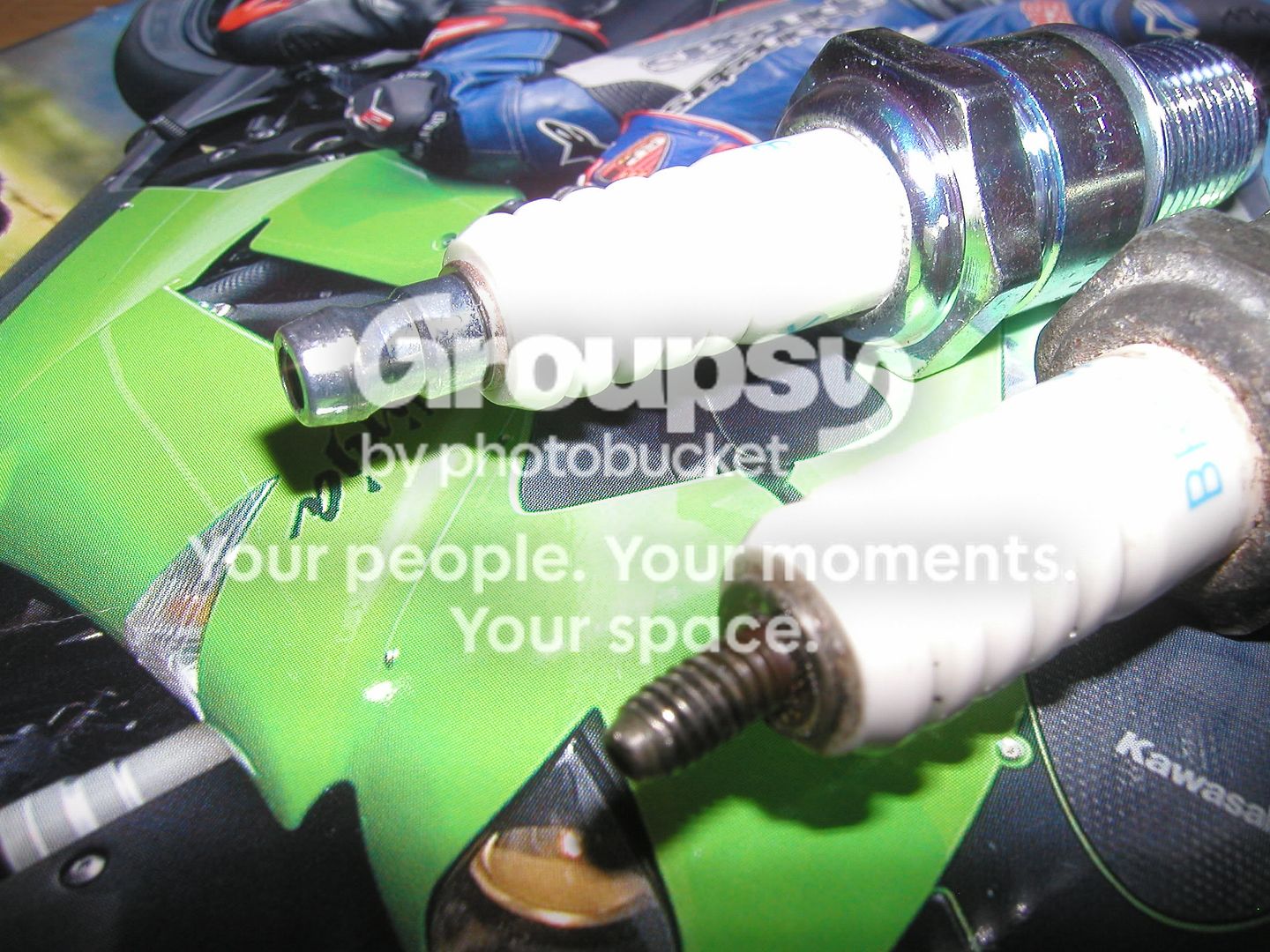

https://i298.photobucket.com/albums/mm255/DeclanJ/P1030417.jpg

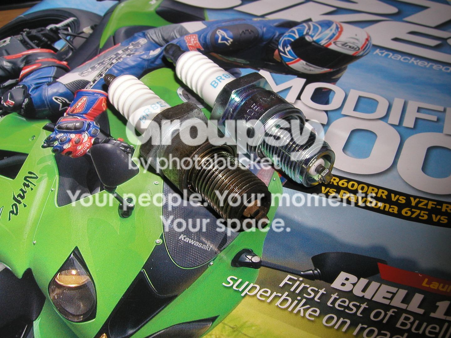

https://i298.photobucket.com/albums/mm255/DeclanJ/P1030419.jpg
Bought the same spark plug but the bit where the HT lead goes over is different.
Help?
Was I meant to ask for a different type?

The nipple screws off, grab it with a pair of pliers.

unscrew the silver bit on the top.
The little O ring around the threads compresses when you put the plug in.
And next time you take a photo of a part, try on a plain background rather than a fast bikes magazine...
