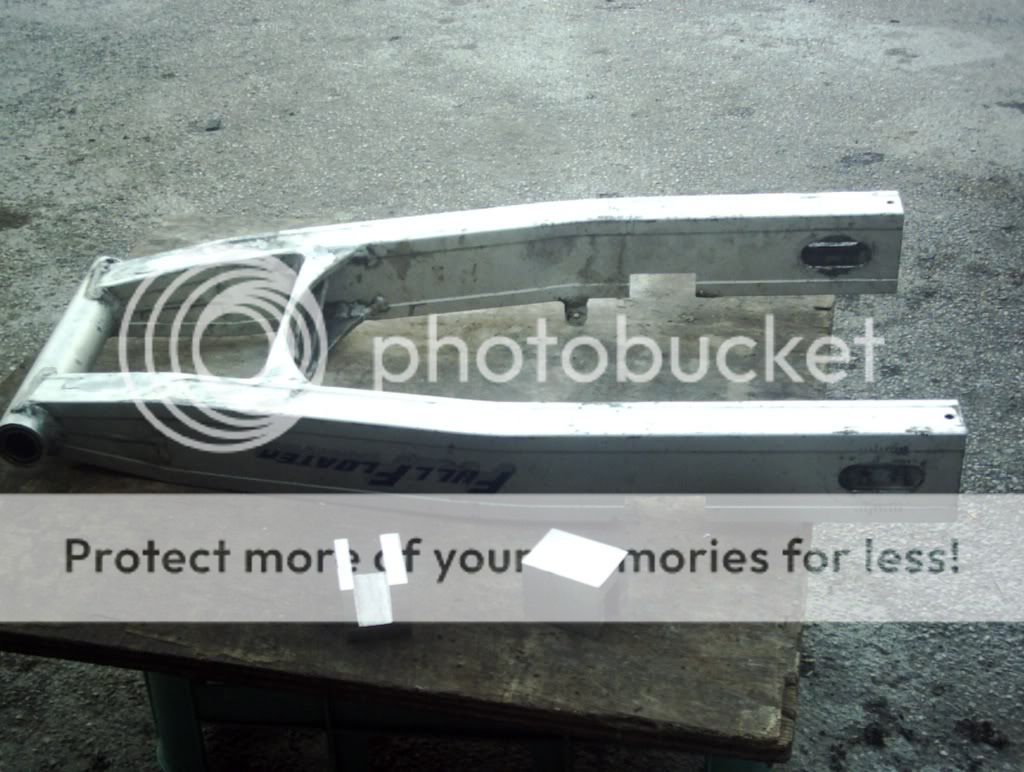

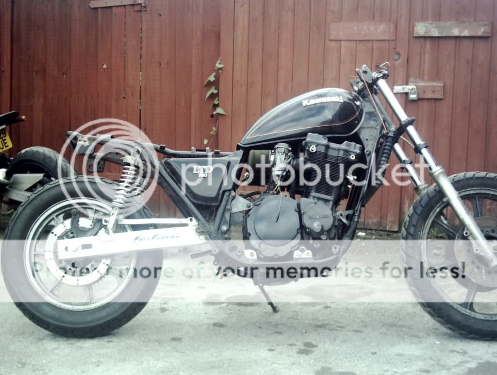

i've just fitted a GSXR1100 engine into an old Z750ltd chassis, i then fitted a modified Slabby 750 s/arm into the frame (had to ease the pivot points in the frame by 2.5 -3mm each side), i then used a Z1000ltd rear wheel but i then found the sprockets don't line up (expected) so i've had to turn a spacer for the rear sprocket carrier to offset the rear sprocket , plus i had to make spacers to centralise the wheel itself in the wider s/arm...
none of this has been overly awkward (and minimal expense) for me as i have access to the required machinery/tools, how are you fixed in this way ?
some s/arms are harder to fit than others depending on what you wish to use
a couple of pictures of the things i've done ...
milled up new mounts for the suspension after chopping off the original suspension (had to pay for the welding)
https://i259.photobucket.com/albums/hh311/NiteMare_08/100-0037.jpg
sprocket offset spacer
https://i259.photobucket.com/albums/hh311/NiteMare_08/100-0042.jpg
s/arm fitted
https://i259.photobucket.com/albums/hh311/NiteMare_08/100-0047.jpg
