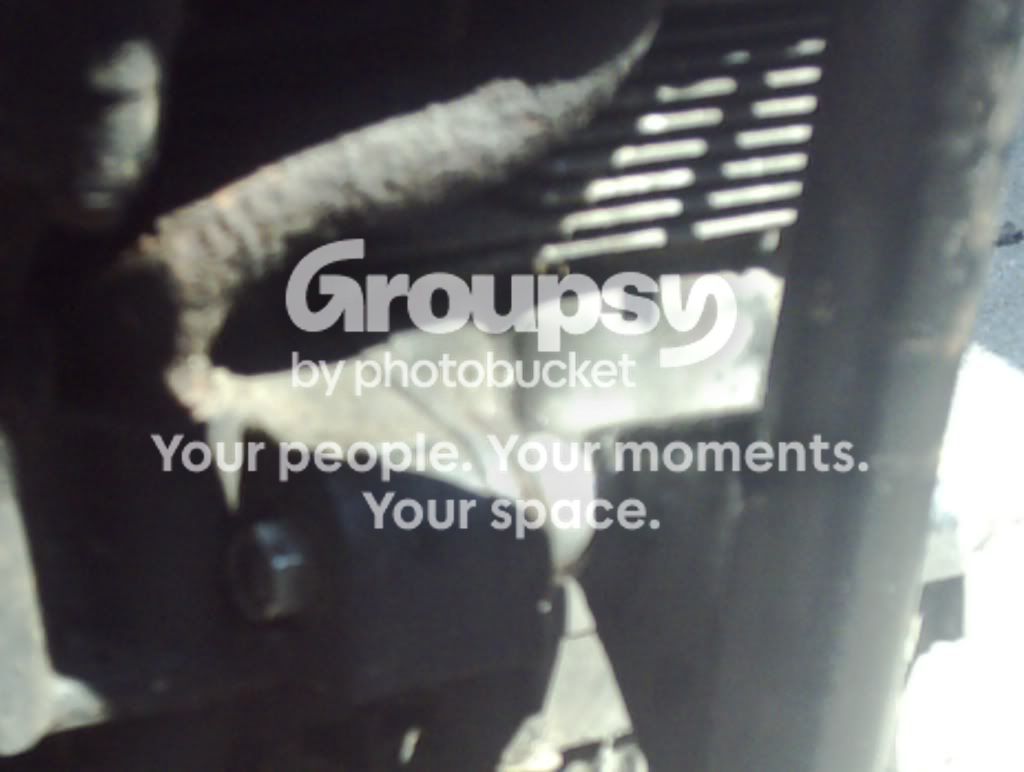

one of the things to consider when fitting oil cooled engines in air cooled frames is do you want to make exhausts from scratch or not, if not i advise setting the motor as far forward in the cradle as possible, i still had to make adaptors for my exhaust ports....
https://i259.photobucket.com/albums/hh311/NiteMare_08/100-0062.jpg

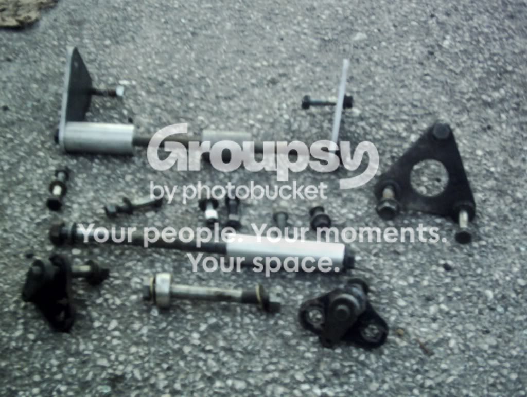

you could possibly/probably mount your engine to the original front mounts of the cradle (might need centering), i made a 9mm spacer to move my engine across the cradle (crappy picture)....
https://i259.photobucket.com/albums/hh311/NiteMare_08/100-0023.jpg

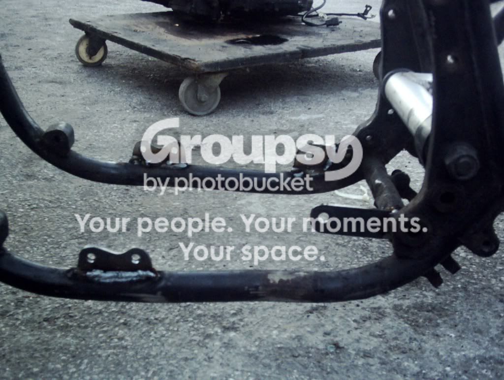

the next question to be asked is do you mind welding new mounts to the frame ?? (4welded in mounts)..
https://i259.photobucket.com/albums/hh311/NiteMare_08/100-0011.jpg
i used pair of 1100wp bottom mounts to bolt to mounts i cut and welded to the lower frame rails, which gave me a little bit more space for removing/refitting the engine...

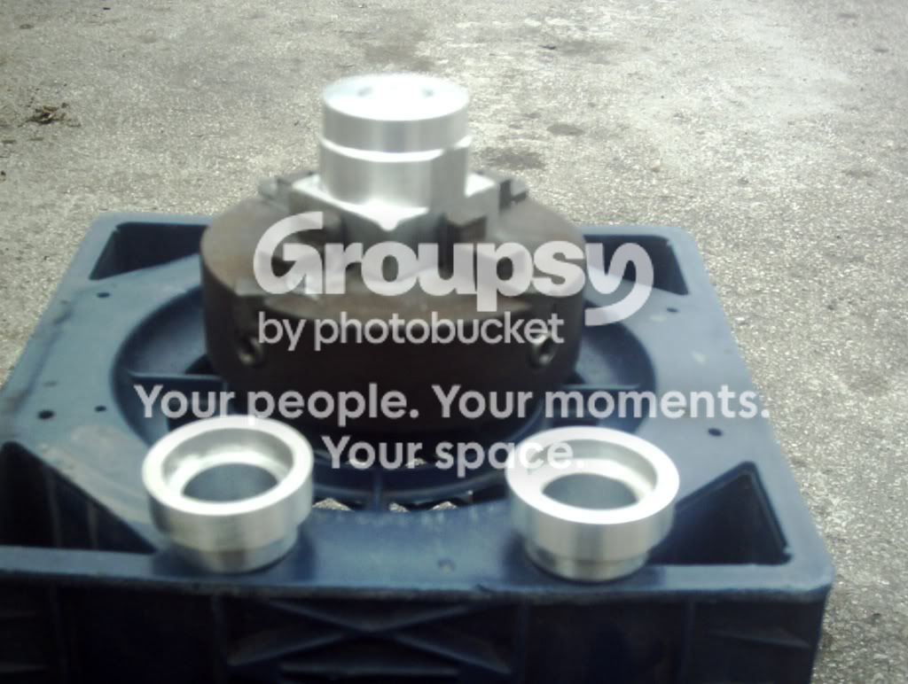

https://i259.photobucket.com/albums/hh311/NiteMare_08/100-0012-2.jpg
take your time before welding to make sure everything is sitting square, central and inline with the frame...
