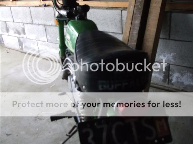

may i present.... dun dun dun
https://i58.photobucket.com/albums/g257/hmmmnz/79673809_full.jpg
mini buffalo
and just to how you how small this wee smokey beast is
https://i58.photobucket.com/albums/g257/hmmmnz/DSCF1840Small.jpg
(excuse the moustache, its MOvember and all my work mates are growing mo's)
https://i58.photobucket.com/albums/g257/hmmmnz/DSCF1841Small.jpg
https://i58.photobucket.com/albums/g257/hmmmnz/DSCF1842Small.jpg

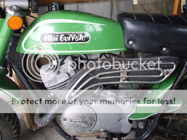

she's a 1975 60cc 2 stroke, with 1323 miles on the clock,
she has been sitting under a house since 1977,
and needs some work, she has frozen solid,
i was hoping it was a cold seize on the top end, but unfortuanatly its the bottom end Sad

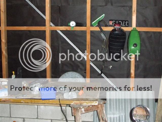

i have stripped the engine down to the crank cases,
https://i58.photobucket.com/albums/g257/hmmmnz/DSCF1856Small.jpg
https://i58.photobucket.com/albums/g257/hmmmnz/DSCF1857Small.jpg
https://i58.photobucket.com/albums/g257/hmmmnz/DSCF1858Small.jpg
but will have to drop the bottom end off, for the bike shop to split the cases for me... (i just dont have the tools to do it myself)
https://i58.photobucket.com/albums/g257/hmmmnz/DSCF1851Small.jpg
well thats the progress so far,
im not sure what the bike is, the prevous owner seemed to think it was based on a old step through yamaha engine (apparntly the Taiwanese bought the tooling from yamaha, and started building there own bikes)
if you can think of any engine that is similar then let me know..
the carb is inside the right hand side cover..
very weird,
it also looks like you have to premix yourself,
fuck knows the mixture

It probably has a discvalve rather than reed valves, that is why the carb is underneath the crankcase.
I used a 32:1 mixture in my Raleigh Runabout. With modern day oils 32:1 should be fine, back in the days it was first made though it would have probably been run on something closer to 20:1.

yeah it is a rotary disc valve system.
ive never come across that before, i ve always only dealt with reed valve smokeys. Mr. Green
