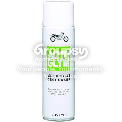

Just wondering how many of you lot totally strip your chain of skanky old lube and give it a good clean.
Was going to get pics but i forgot.
I was wondering if it can cause any shortage on the chain life i did lube it uip rather well afterwards
And this degreaser is the absolute bomb this shit actually is amazing works well on wheels to just make sure you hose it off well Thumbs Up
https://i210.photobucket.com/albums/bb259/Squeaky_86_2007/motorcycledegreaser.jpg

Dubious about using any degreasant on a chain. Any gets past the O rings it is likely to remove the grease sealed in there, and no chance you will get any in to refresh it.

Hmm might have to buy me some diesel then Confused Would never of thought of that
But hey you learn something new every day
But on the upside that auto glym stuff work wonders on my wheels or is that a no go too ?
