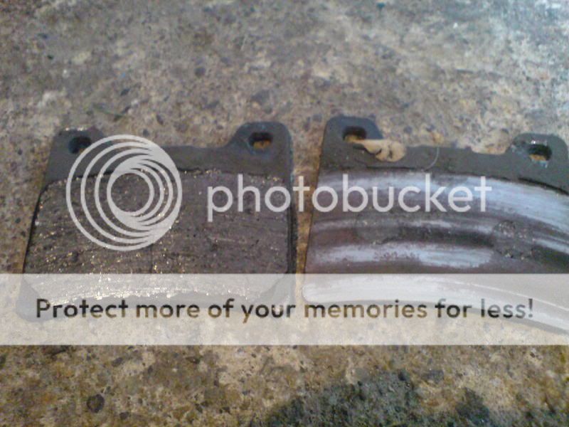

Also ordered some new pads and caliper seal kits my brakes seem to be binding like mad
Do these need changing ?
https://i210.photobucket.com/albums/bb259/Squeaky_86_2007/Gix002.jpg
Previous: K1 GSXR 1000
PostPosted: 11:36 - 12 Feb 2009    Post subject: Reply with quote
You can still see the wear lines so they are alright. Wink

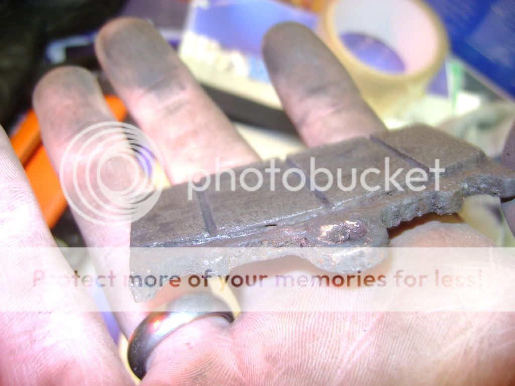

This is what my back one's looked like last time I changed Very Happy
https://i36.photobucket.com/albums/e2/Dechant/DSC00269.jpg
...I do not reccomend letting them get this low as it can damage the brake disc.
