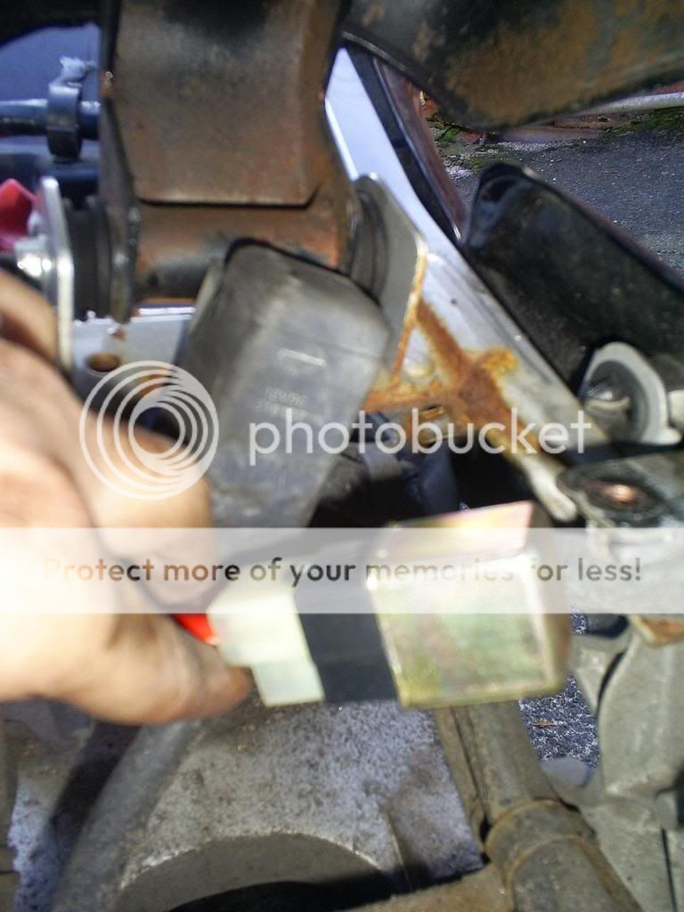

https://i181.photobucket.com/albums/x313/xanthicflex/S5030802.jpg
And what does it mean when it buzzes horribly and your bike doesnt start?
Shocked
And also, to remove the starter motor, do I go in through the left side and remove the engine casing first?
Thanks in advance!

Probably the relay for the starter motor so your starter motor may be o.k. if the relay is knackered.

It's the starter relay. If it buzzes it means that your battery is either flat of completely dead. I wouldnt muck about with the starter motor until you have sorted the other problems first.
