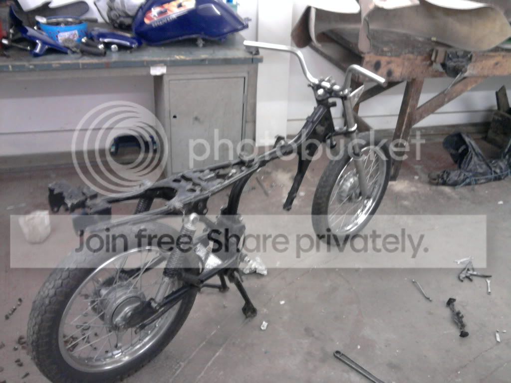

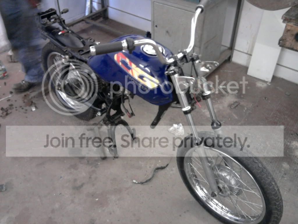

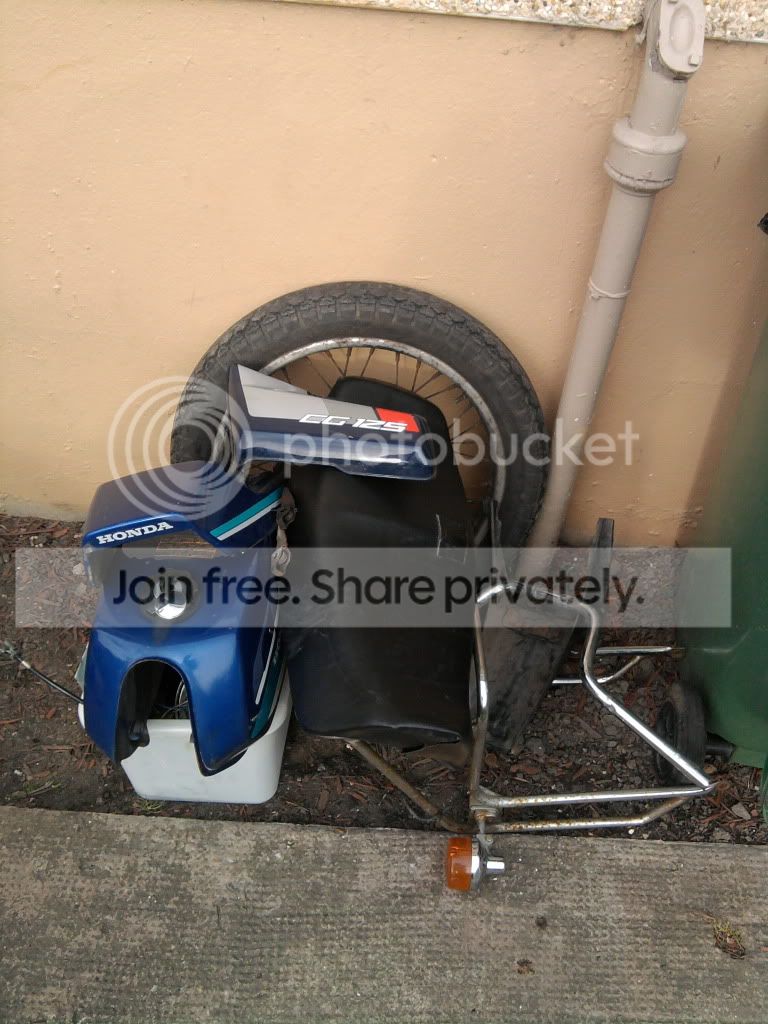

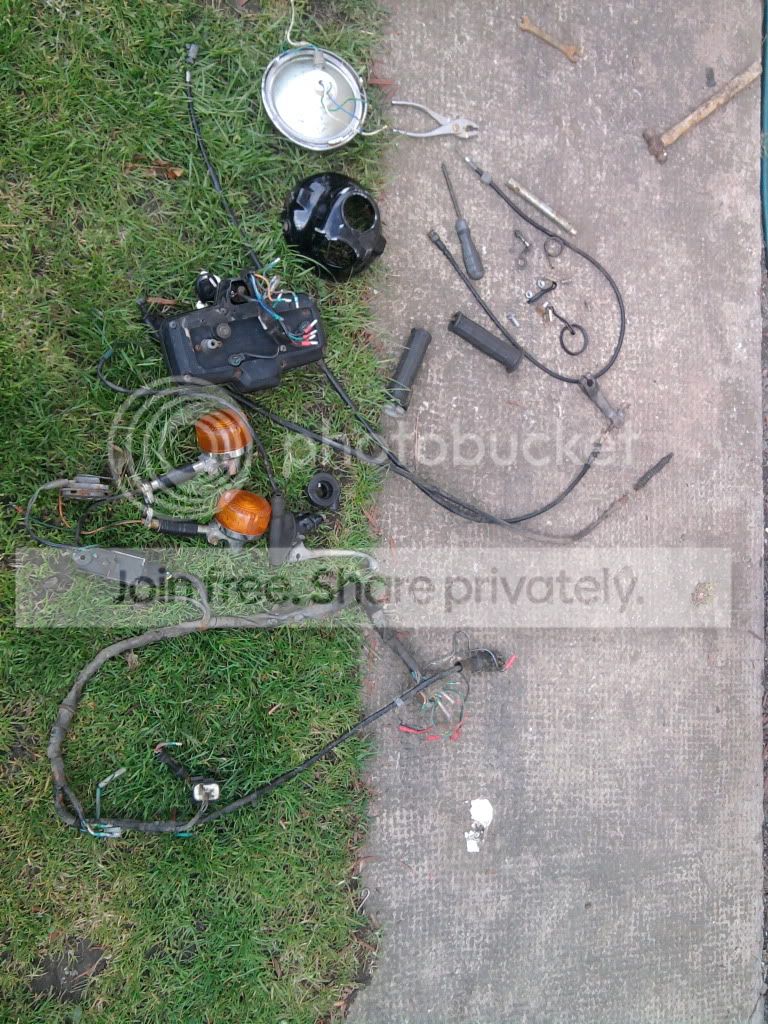

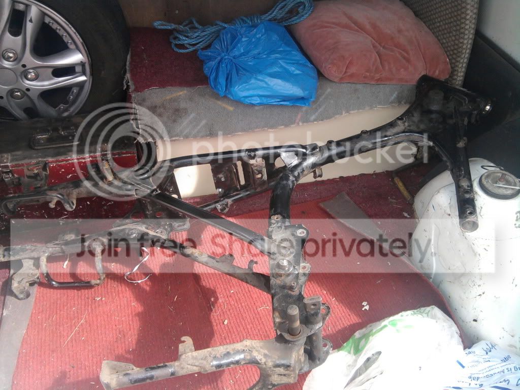

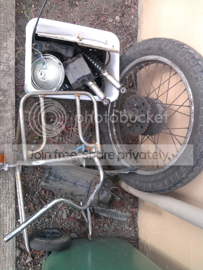

So i made a start today...
Got most of the stuff i need off, then i got most of the stuff i don't need off.
Couldn't get the swingarm, engine or forks off today, so i'll have to wait till the weekend to get them off and take them up to the garage where my other frame is to fit everything to the new frame.
HOW FUN!

https://i624.photobucket.com/albums/tt325/duncdmc/DSC00251.jpg
https://i624.photobucket.com/albums/tt325/duncdmc/Photo0151.jpg?t=1271697915
https://i624.photobucket.com/albums/tt325/duncdmc/Photo0152.jpg?t=1271697918
https://i624.photobucket.com/albums/tt325/duncdmc/Photo0153.jpg?t=1271697921
https://i624.photobucket.com/albums/tt325/duncdmc/Photo0154.jpg?t=1271697923
https://i624.photobucket.com/albums/tt325/duncdmc/Photo0155.jpg?t=1271697925
https://i624.photobucket.com/albums/tt325/duncdmc/Photo0156.jpg?t=1271697927
https://i624.photobucket.com/albums/tt325/duncdmc/Photo0157.jpg?t=1271697928
https://i624.photobucket.com/albums/tt325/duncdmc/Photo0158.jpg?t=1271697929
https://i624.photobucket.com/albums/tt325/duncdmc/Photo0159.jpg?t=1271697929
Everything is packed away just now waiting till next week.

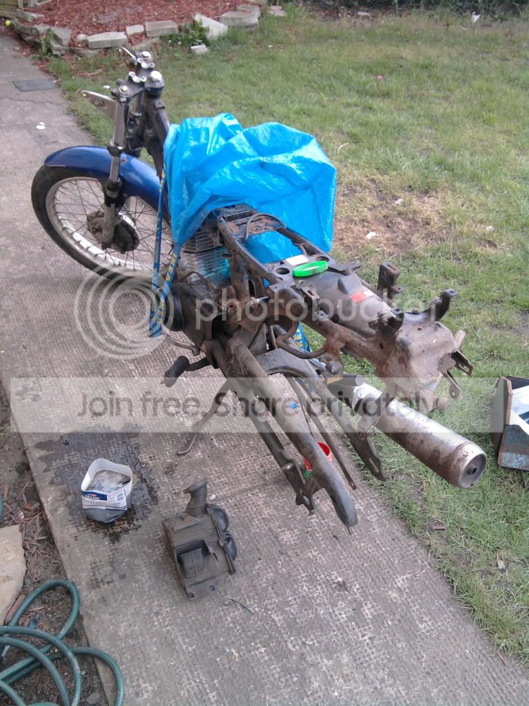

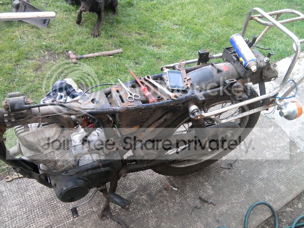

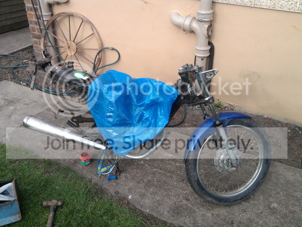

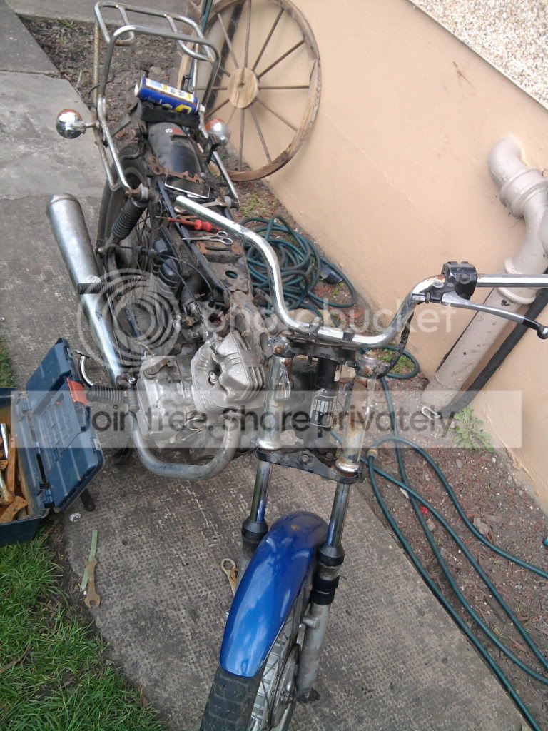

Well i've had a lot of progress over the past wee while in the short amount of time i get to play with it.
Turns out theres a few more differences than a bargained for with the new frame... in that some of the wiring brackets... well... they aren't there. So i'll be making some up over the next week.

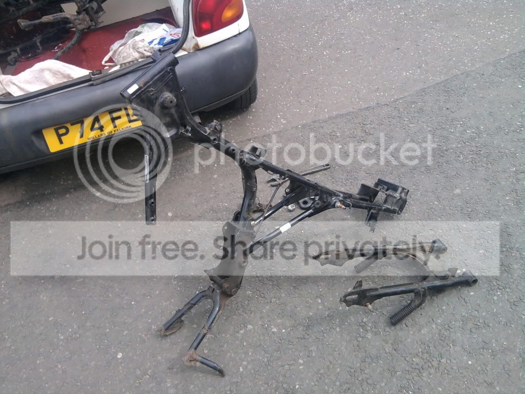

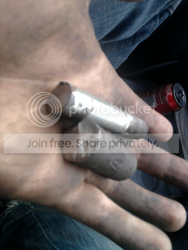

Right, so from where i left off, i got the swingarm off after a bit of trouble, one of the bushes was seized to the spindle, so i got an awesome looking angle grinder and cut the bastard off, and ordered a new spindle and bushes.
https://i624.photobucket.com/albums/tt325/duncdmc/Photo0170.jpg?t=1272757117
So once the swingarm was off, i dumped old frame in the back of the van, and started on the steering head.
https://i624.photobucket.com/albums/tt325/duncdmc/Photo0171.jpg?t=1272757234
https://i624.photobucket.com/albums/tt325/duncdmc/Photo0172.jpg?t=1272757261

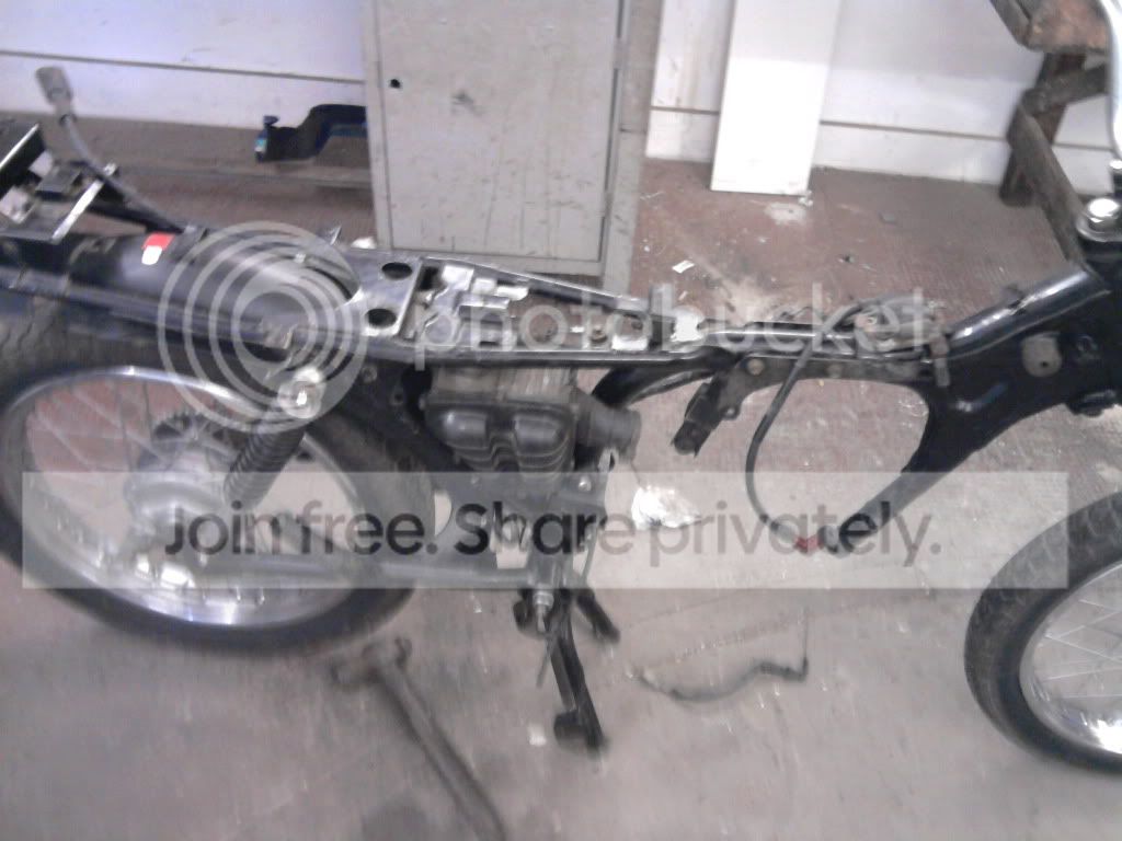

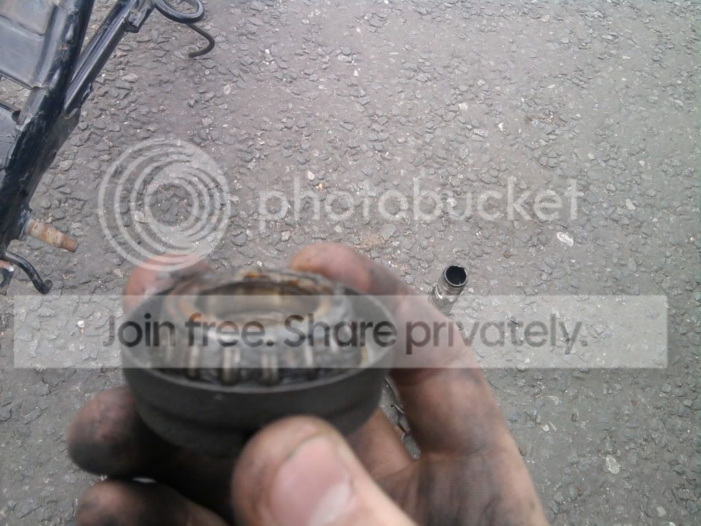

Once i had it off, i gave it a right good clean before putting it all on the new frame.
https://i624.photobucket.com/albums/tt325/duncdmc/Photo0173.jpg?t=1272757289
https://i624.photobucket.com/albums/tt325/duncdmc/Photo0174.jpg?t=1272757374

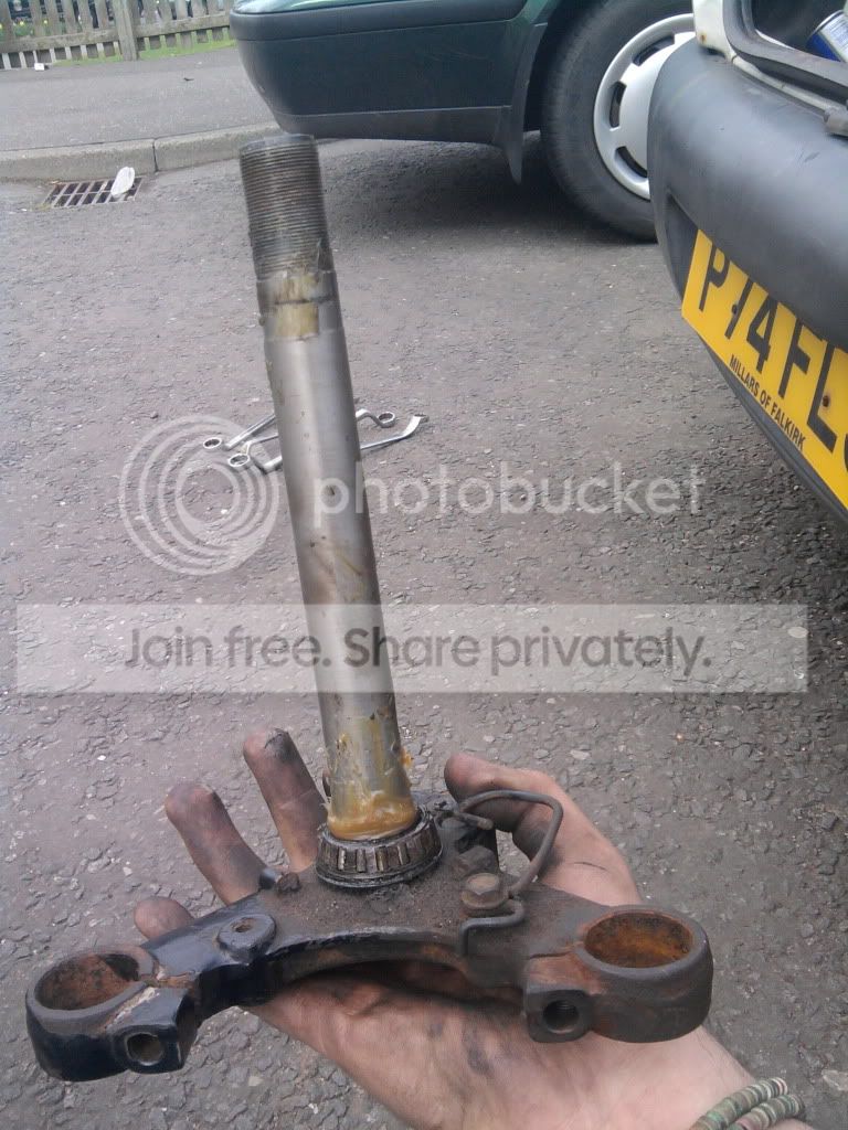

Races were fine, no need to replace them... gave it a good greasing then put it all back together again.

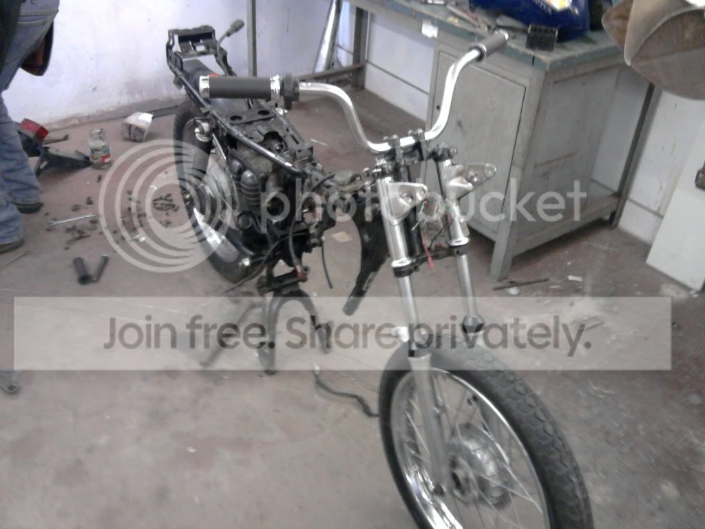

Once that was all together again, i set to work on the fork seals. At this point my phone decided to die, so no pics i'm agfraid till i had the forks and wheels on in the workshop.
https://i624.photobucket.com/albums/tt325/duncdmc/Photo0185.jpg?t=1272757407
I managed to get a new spindle and bushes, fit the swingarm, get the rear shocks on, then when putting the rear wheel on i realised i was missing a spacer. bugger. i'll get one from somewhere.
Anyway, forks fitted, Wheel fitted, Bars fitted with some kind of ghey chopper style grips on (will have to do as they were free Wink)
Everything got a good clean before going back in the frame, so it looked kind of sexy i think... compared to the last set of pictures anyway.
https://i624.photobucket.com/albums/tt325/duncdmc/Photo0186.jpg?t=1272757539

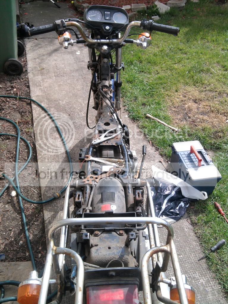

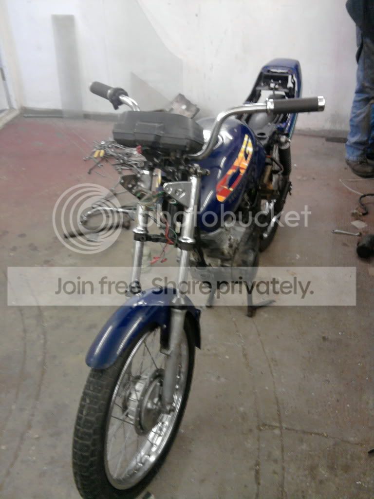

Next job was to fit the leccy.
Got it all hooked up to where it's supposed to be, realising half the fixings are different, and there is nowhere to hold the battery. But i'll make the mounts for it at some point and get them on the frame.
https://i624.photobucket.com/albums/tt325/duncdmc/Photo0187.jpg?t=1272757609
I then got the mudguard on, and got the airbox on.
https://i624.photobucket.com/albums/tt325/duncdmc/Photo0188.jpg?t=1272757674
Next was time to check the tank i had bought actually fitted the frame.
https://i624.photobucket.com/albums/tt325/duncdmc/Photo0189.jpg?t=1272757716
Bingo.
When going through to get a trolley jack, i stopped to admire one of the old cars in the warehouse bit. Lovely old car here, a 1954? SS jaguar, apparently the first jaguar to be made, not even by jaguar... if you know your history Wink
https://i624.photobucket.com/albums/tt325/duncdmc/Photo0191.jpg?t=1272757867
It's apparently worth somewhere in the region of £25,000 - £30,000...

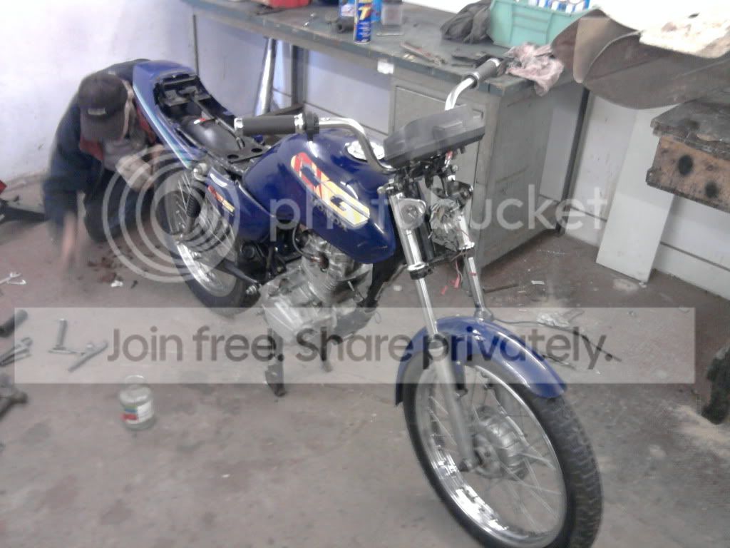

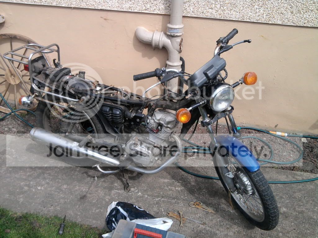

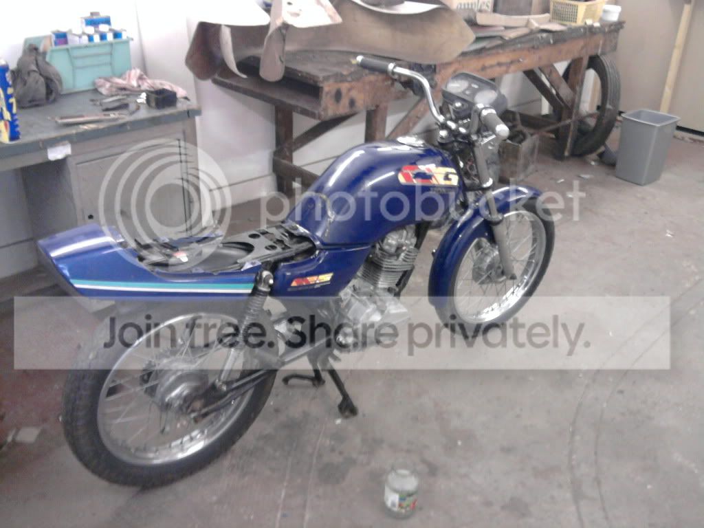

Then got the engine in, And fitted the tank, mudguard, and seat cowl.
https://i624.photobucket.com/albums/tt325/duncdmc/Photo0194.jpg?t=1272758037
https://i624.photobucket.com/albums/tt325/duncdmc/Photo0195.jpg?t=1272758090
https://i624.photobucket.com/albums/tt325/duncdmc/Photo0197.jpg?t=1272758206
You can see from the pics above that the side panel isn't sitting right, seems it's not the right mounts for it so i'll have to get a different one i think.
Anyway, i pushed it up against the wall to come back another day and get the rest of the work done.
By the progress of things, i think it'll be back on the road soonish, won't take too much longer to get everything fitted and cleaned/painted.
