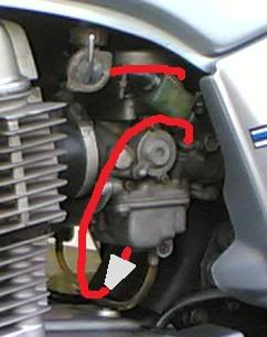

This is a quick paint illustration of the currect set-up. The original picture shows the old set-up which turns out to be too short a route, if run with an in-line filter, as it kinks.
New set-up (as shown in pic) is pipe from tap, round the back of the carb and underneath the bottom of the carb, then filter, then back up straight to carb spigot.
https://i101.photobucket.com/albums/m62/ant-147/carbset-up.jpg
I could check for any crap in the carbs, but the fuel tank is immaculate inside now and new fuel lines and filter, i find it hard to believe that crap would have got it, but possible so i will check. The in-line filter looked full of fuel when i broke down, i pulled the pipe off and petrol came out freely. Thumbs Up

WTF .... dude, you have an air lock ... plain and simple!! Very Happy
You might be able to 'flick' the air bubble out, but with it like that its bound to cause problems ...
The tap itself should have a little gauze filter in it ... the in line is a good idea, but shouldn't really be needed and with the line ran like that ... well you now know what can happen!! Laughing

I think its asking for trouble ... again, it might be ok, but having now seen that, I'd deffo try putting a straight bit of pipe in and see if it clears your fault ... having established what we have to this point (that you have cleaned the carbs etc) ... I bet a shiny e-Penny Coin that fuel line routing and filter position is all your problem is!! Wink

You shouldn't need a filter ... it was a nice idea, but if you cant get a clean run, then its a no-go I am afraid ....
I think if you 'snaked' the run from the tap to the carb (but always in a downward direction) you should be able to get the filter in there (horizontal ish - try not to get 100% horizontal or we might get another air lock problem). Bur for now, just run a straight bit of pipe and see if your fault clears ...
you can always retro-fit a filtered 'snake' run ... but we need to ensure this is deffo your problem first ...
p.s. Isn't that a 'square' inline filter in there in the original pic??? ... can't you just get another one of those?

Right, im just going to fit a straight bit of tube tomorrow as i know the bit you mean in the tap, i checked that before re-fitting the tap and its clean.
I will take it on a nice long run tomorrow and hopefully it will be ok Smile Will let you know. Thumbs Up
Edit: I could get another square filter but the thing is, with it fitted, the fuel line is kinked on the end. I do have a smaller filter somewhere, i'll try and sort it out and if i can fit it without any kinks then i'll leave it be. Smile

Here is the old set-up, its not very clear but the red line shows the bends.
https://i101.photobucket.com/albums/m62/ant-147/tapset.jpg
The yellow line shows where the tap spigot ends so i cant shorten that tube anymore to try and stop the kink. The sharp bend towards the end shows how the fuel tube kinks. Thumbs Up
