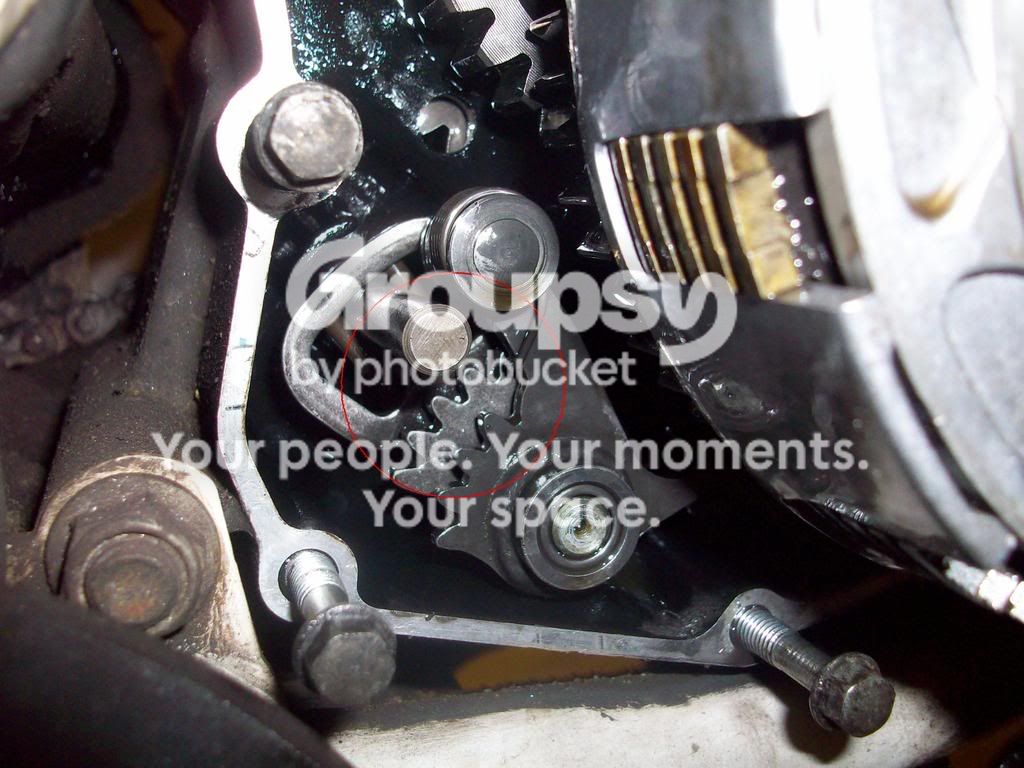

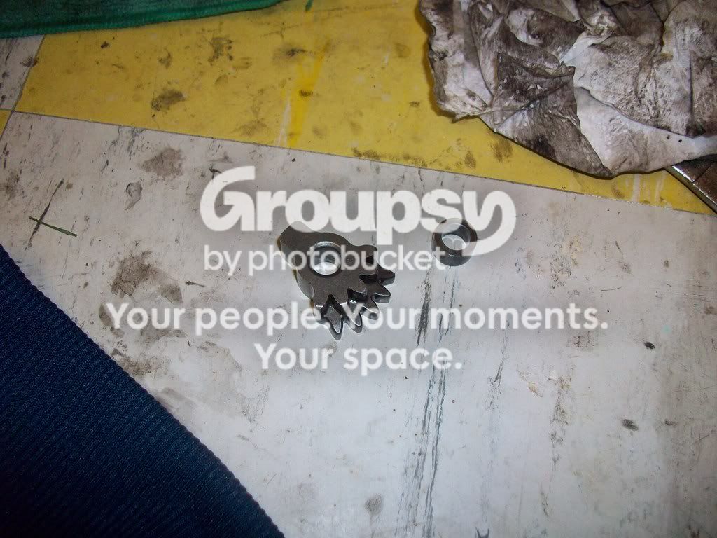

When i replaced my cltuch plates on my mtx i had a similar problem.
What is was, was the little tooth'd thing that had fell out when i took the clucth cover off. You have to make sure it is lined up properly other wise you cannot select gears. Took me ages to get it right including having to take it all apart again as i could not change up gears but down was ok.
https://i154.photobucket.com/albums/s241/VR_XRAY/Picture001-1.jpg
https://i154.photobucket.com/albums/s241/VR_XRAY/Picture002-1.jpg
top picture shows the shaft and the teeth that need lining up correctly.
2nd picture shows the tooth'd gear that was the main cause of my problem's.
I am sure somebody will be here with the correct names and stuff but from my past experance with this i think you should check this out???

Thanks for the reply and uploading the pictures, it's greatly appreciated.
Can I just check that you had the same problem as me - that you couldn't only select one gear (2nd gear) - and not that you couldn't select any gears?
Also, did you have any problems selecting the gears when the bike was not running?
Thanks.

PostPosted: 21:21 - 18 Jan 2009    Post subject: Reply with quote
Yeah could only get 1st and no higer though the box than neutral, that was even with the bike running or not running. May be your problem but as you may or not know 2nd gear on the mtx was not the best and even an older field bike version i had @ 15 had 2nd gear replaced twice in the 8 months i had it.
