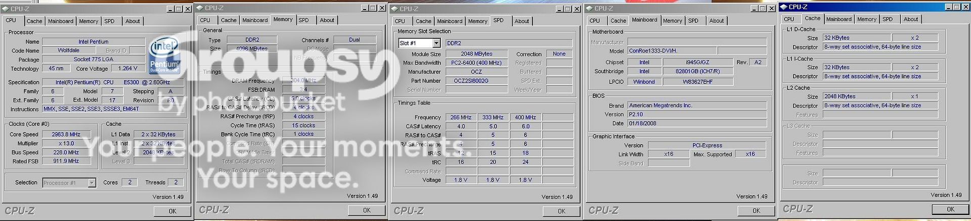

PC has been quite unusual in the past couple of days and I have no idea what is going on.

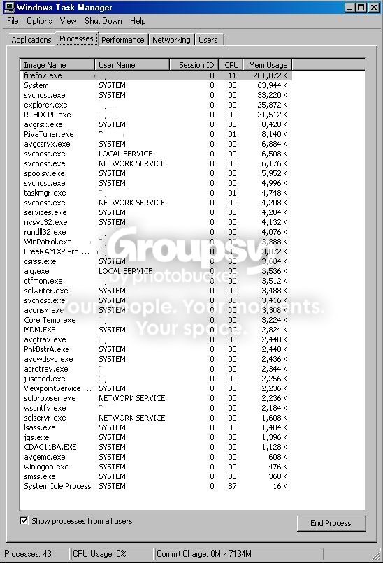

Process list in the task manager doesn't update properly, specifically the Mem Usage. Normally the figures are jumping about and changing constantly but now they're pretty much fixed and sometimes the process doesn't clear after I exit a program and it won't let me end it manually.
The CPU and Page file graphs under the performance tab haven't worked ever since I upgraded my ram to 4gb, I've put this down to windows being pissy with it's 32-bit wall.
I think firefox updated yesterday and now cookies and sessions won't save. Every where I would be automatically logged in I'm logged out and need to log in manually when I open the browser. Usernames and some passwords are still saved in the textboxes in the login menus. Everything in the options looks set ok and hasn't changed from before. It managed to hit over 1,000,000K usage last night somehow with less than 50 tabs open, I'm not sure I have seen it go that high even with 300 tabs open. Google suggested finding the cookie file in the profile and changing the extension to .tmp, didn't help.
Got a random BSOD and restart when I booted up today. Wasn't doing anything in particular, hasn't happened before and hasn't happened again just yet.

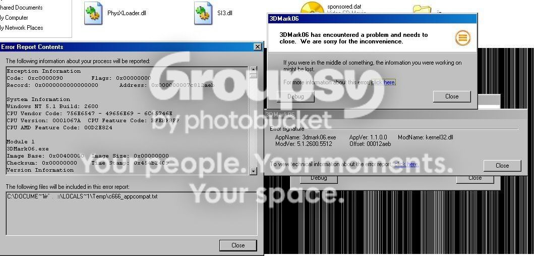

Some programs 'encounter a problem' and need to close. Windows media as soon as I open a file, you could move the error and it worked properly, this has stopped though. Fallout 3 is completely random when it does it can happen after several minutes or several hours. 3dMark06 everytime I click to view my results, reinstalling did not help. This has been happening longer than the task manager problems.
Have ran Memtest86 and OrthosPrime95, passed both no problems. Tried windows system file checker and that didn't reveal any problems.
AVG, Spybot, SuperAntiSpyware, Avast, Malwarebytes are all updated and finding nothing except the odd tracking cookie.
The 500w power supply I have at the minute is borderline for my system but everything was working fine for a few weeks, a new one is on it's way.
Do my problems sound familiar to anyone? Googling hasn't found me anything. Confused

I'm not sure what to say. Firefox sorted itself out over the weekend and is working normally again.
Got the PSU, put it in last night and didn't notice any immediate difference. Couldn't clock the memory up as I hoped, task manager and everything else stayed the same. Fair enough, it was a failure.
Today my task manager is working properly. Processes are updating and shuffling about like they should but the performance tab is working too Surprised. CPU and PF usage are showing up for the first time since installing the memory as if by magic. Yay they're working but I've no idea why Neutral.

Got 2x new 1gb sticks of RAM to try last night and it looks like everything is sorted now. Can set its speed to the full 667 and can overclock the CPU to 3016mhz now, up from 2964.

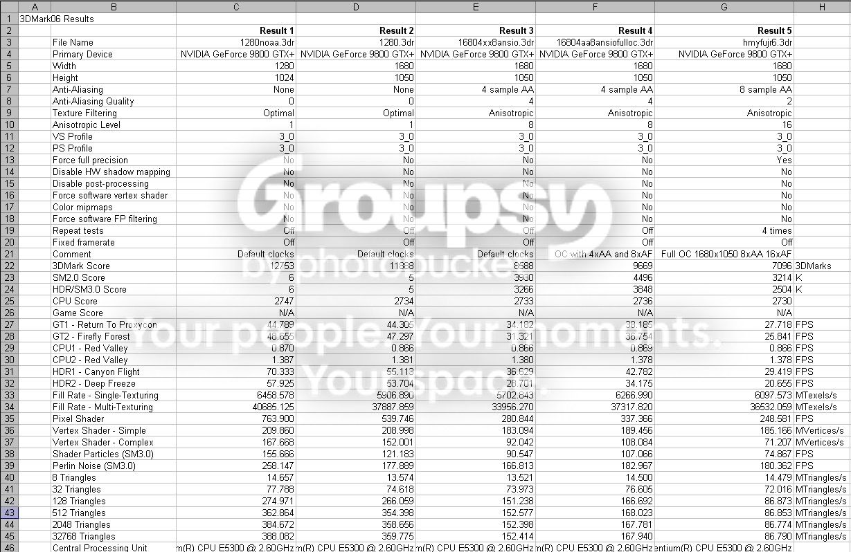

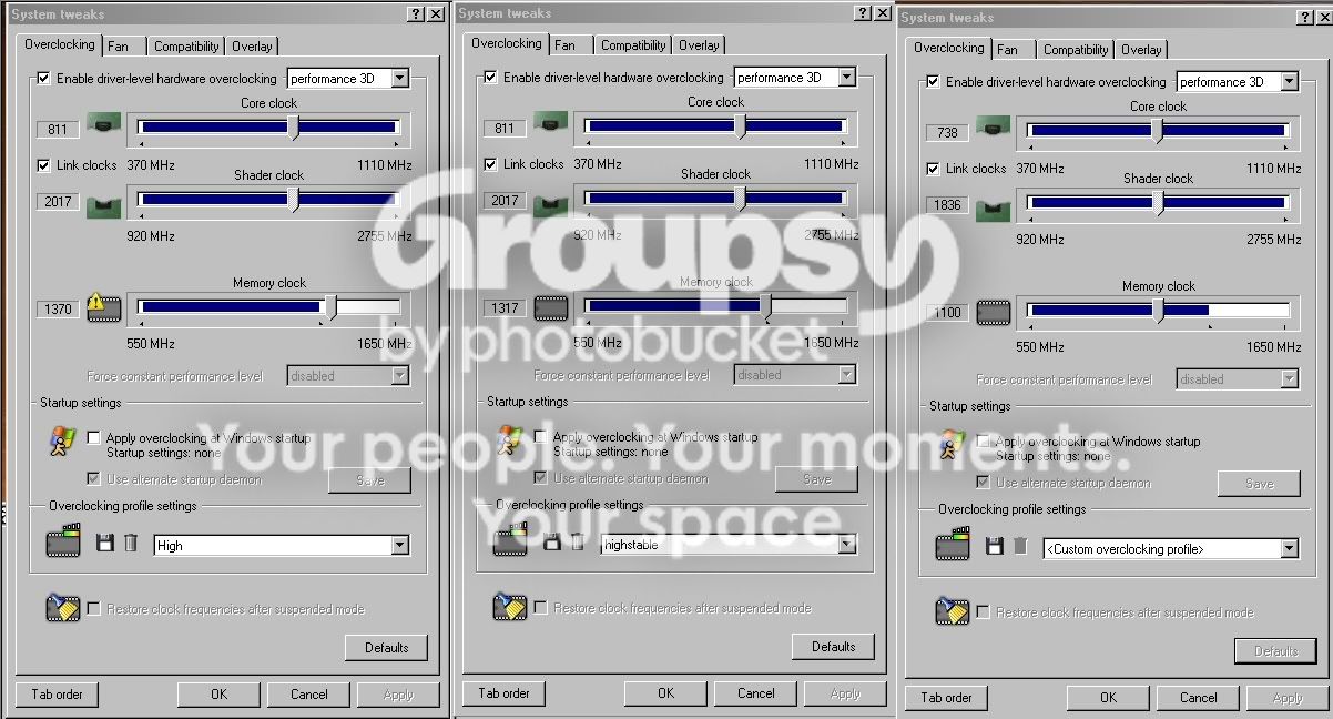

3dMark stopped giving me errors so I bought the advanced version to really stress the card. Could turn the memory on the card up to 1370 and run all tests except 1680 x 1050 with 8x anti-alias and 16x af. When the pixel shader test was repeated temps hit 68ºC and it froze. Had to scale it back to 1317 and it worked fine and temps didn't go above 61.
Haven't ran 1680 x 1050 overclocked without aa or af or 8x aa 16x af on default.
Overclocking the cpu made a big difference but it still runs 100% in a lot of the tests.
Card is a Inno3D 9800 GTX+
