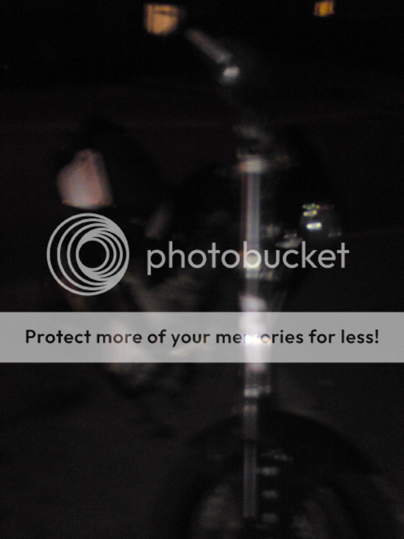

If so why do they do it?
Ive just whipped the plug out of my RS, and its a BR10EIX and compared it to a BR9ES from my old bike, and the electrode is very very small.
Some pics of the plug, What ya rekon sposes to be like this?
First pic is my plug, note electrode in centre size

I think it may be because someone has fitted an iridium plug to the bike.

What that its got a small electrode by getting too hot?
or by plug design?
I cant work out whether the plug is just about to give up from the electrode or not...

Plug design.
As you can see, they have smaller electrodes.

Google that plug, they have small center electrodes!! Wink
But yes, electrodes do wear.
Its the arcing, normally the center electrode goes from flat top to rounded.
