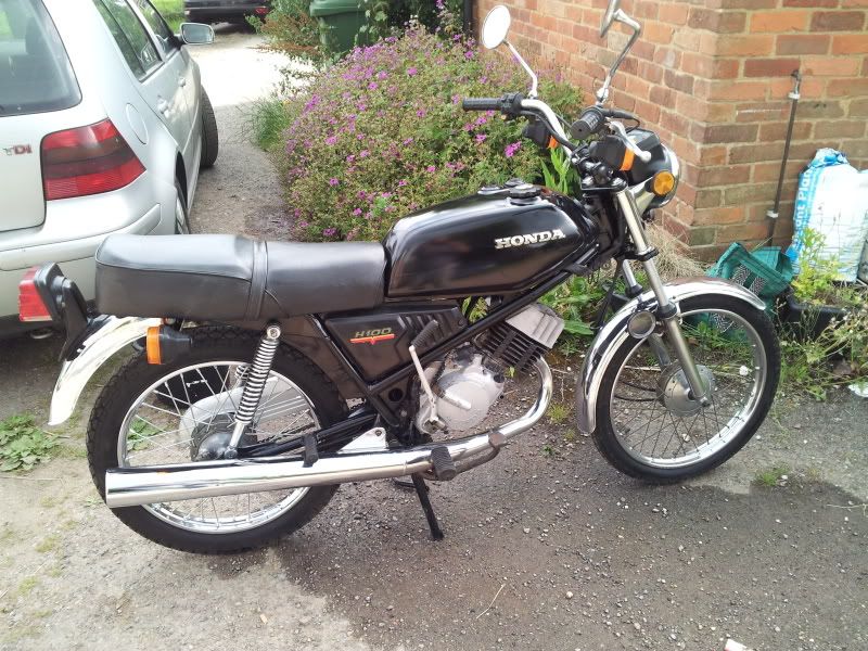

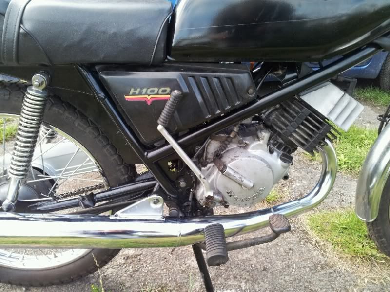

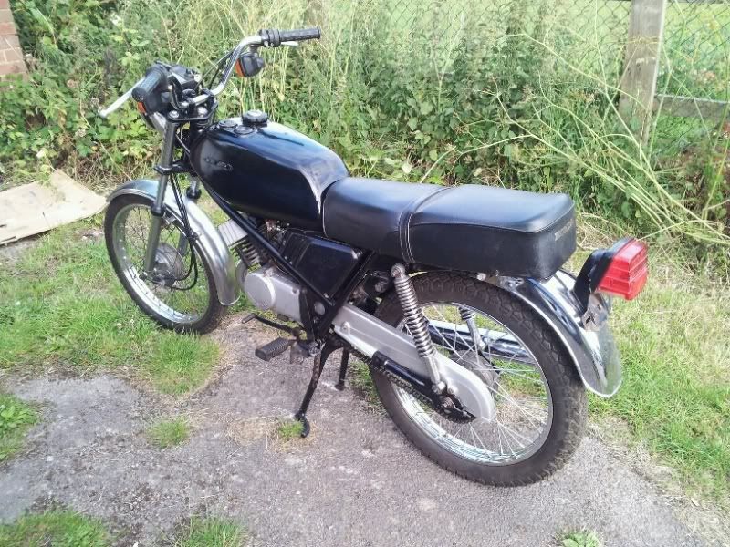

Well i bought this bike as a heap (!) to do up as a winter project...two winters later lol it's starting to come together. I've rebuilt the engine, fitted new stanchions, replacement seat, powdercoated and painted frame, swing arm etc, a few other new odds and ends here and there.
Long story short, tonight was the moment of truth for engine! I couldn't actually believe it but turn the petrol tap on, pull the choke out, ignition on, one good kick and away she went!
Still needs a bit of tweaking as i can't get it to idle correctly when it's warm (maybe more rust in the carb...i'll post that in the workshop section) but it sounds really sweet!
Lots more still to do...sort the electrics, rear indies, one or two lamps but it's almost ready for an MOT. Chuffed to bits am I !! Smile
