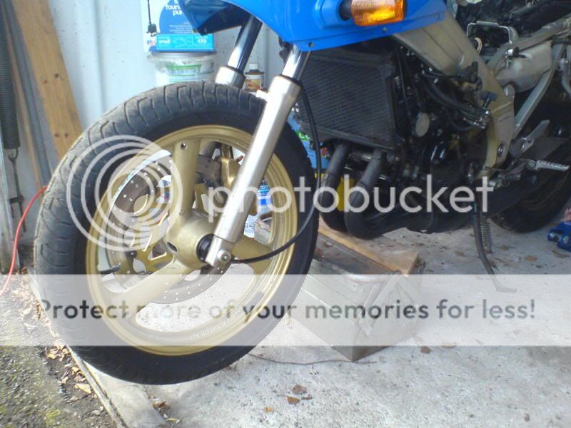

PostPosted: 13:10 - 05 May 2009    Post subject: Reply with quote
Toolbox and some wood under the downpipes. Supported under the swingarm with some house bricks.
