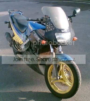

I favour "stitching" the inside of the crack using a hot soldering iron then putting a large splat of epoxy resin over the top of that.
Actually, that's not true. I favour epoxying and pop rivetting a piece of aluminium sheet across the inside of the crack which utterly prevents it opening up again. All that shows on the outside are the heads of the pop rivetts.
If the crack doesn't terminate at the hole, it is sometimes worth drilling a small hole at the "point" of the crack to stop it spreading further.
I once repaired an extensively smashed to bits fairing by gluing and rivetting copper sheet to the outside of it. Certainly a "different" look.
https://i48.photobucket.com/albums/f216/stinkwheel/fairing.jpg
https://i48.photobucket.com/albums/f216/stinkwheel/gpzrat.jpg

well impressed with that gpz stinkwheel although the only reaosn i plan to repair the divvy is to maintain its resale value Razz

I think stinkwheel has been watching one to many Madmax movies! Laughing
PostPosted: 21:17 - 11 May 2009    Post subject: Reply with quote
I did. Bought it for £800. Rode it for three years. Put 30k miles on it. Had it crashed by a mate. Sold it for £360. Those are the photos I uploaded to ebay when I sold it.
