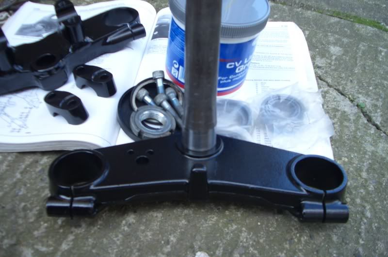

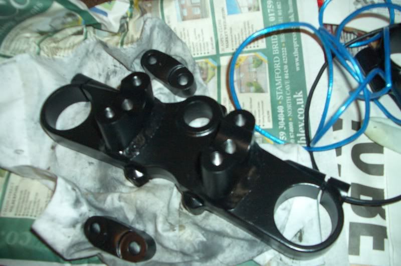

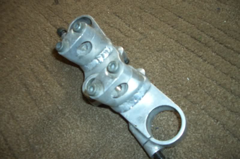

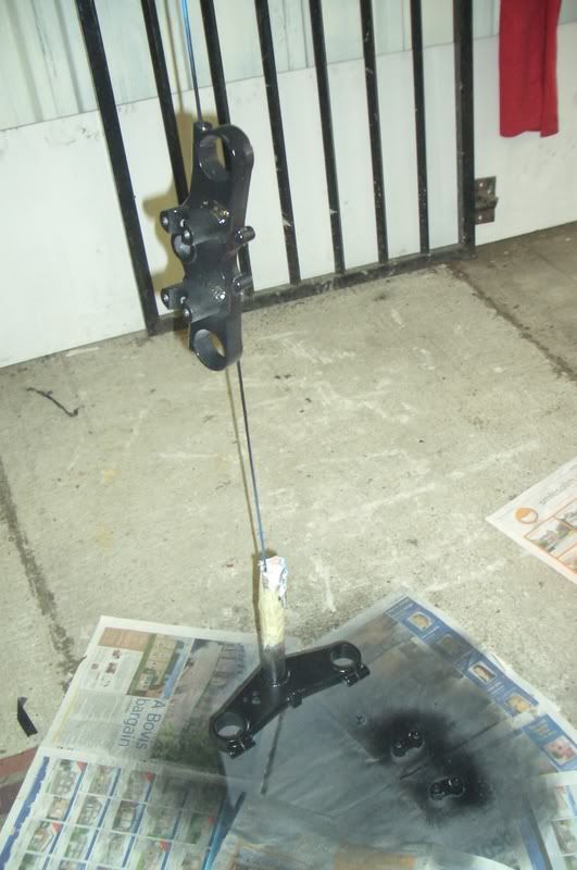

Ok, so I bought this top yoke with risers scruffily welded on for a tenner off eGay.
https://img.photobucket.com/albums/v246/super_jo/topyoke1.jpg

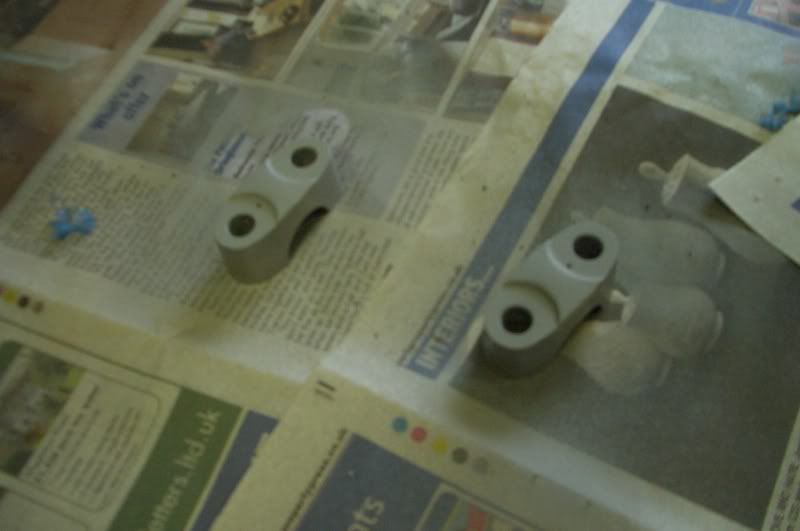

Decided to tidy it up as I had some satin black and lacquer hanging around.
I hate waiting for coats of paint to dry!! I have no patience Mr. Green

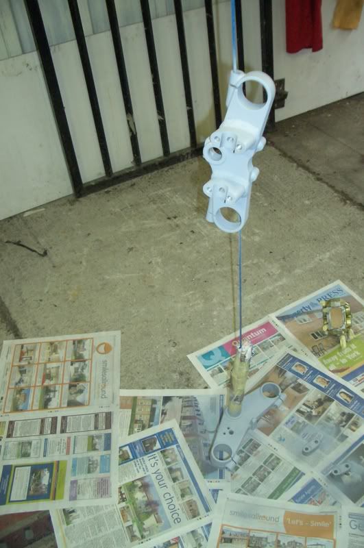

Primer:
https://img.photobucket.com/albums/v246/super_jo/gix15sep082002.jpg
https://img.photobucket.com/albums/v246/super_jo/gix15sep082004.jpg
4 coats of black, I think:
https://img.photobucket.com/albums/v246/super_jo/gix15sep082006.jpg
https://img.photobucket.com/albums/v246/super_jo/gix15sep082009.jpg
https://img.photobucket.com/albums/v246/super_jo/gix15sep082010.jpg

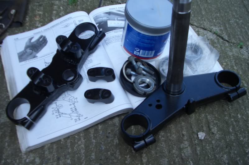

Lacquered up and ready to put the front end back together!
https://img.photobucket.com/albums/v246/super_jo/gix15sep082016.jpg
https://img.photobucket.com/albums/v246/super_jo/gix15sep082018.jpg
https://img.photobucket.com/albums/v246/super_jo/gix15sep082019.jpg

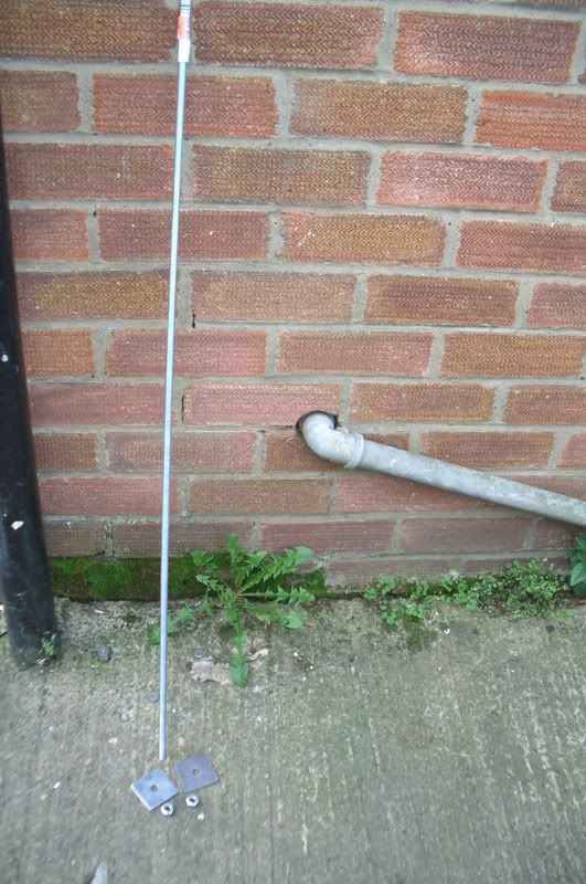

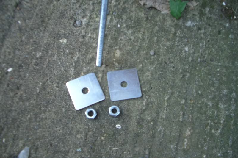

Here is my home-made bearing press (patent Stinkwheel):
https://img.photobucket.com/albums/v246/super_jo/gix15sep082021.jpg
https://img.photobucket.com/albums/v246/super_jo/gix15sep082022.jpg
Cost £1.55 for the threaded bar. Sure better than £30 for a 'proper' tool and worked a treat!
Yay!
https://img.photobucket.com/albums/v246/super_jo/gix15sep082023.jpg
https://img.photobucket.com/albums/v246/super_jo/gix15sep082024.jpg

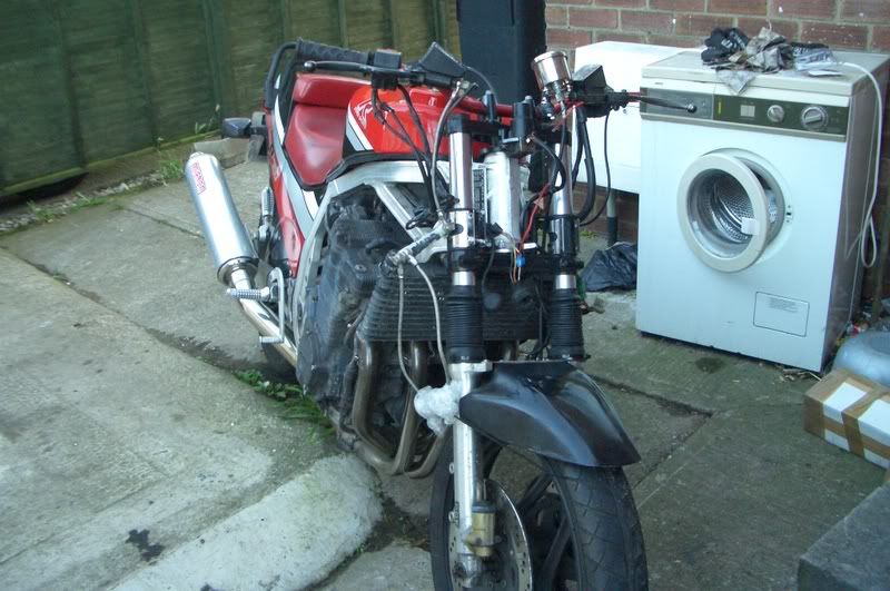

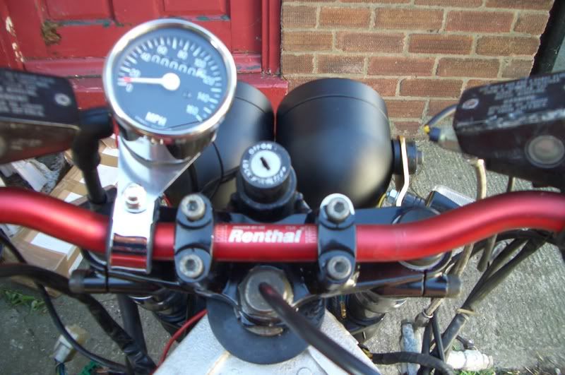

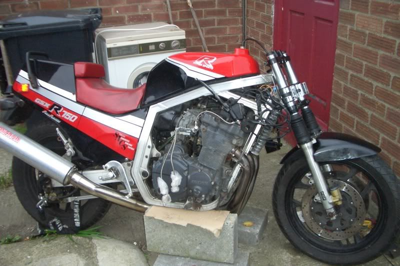

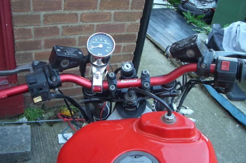

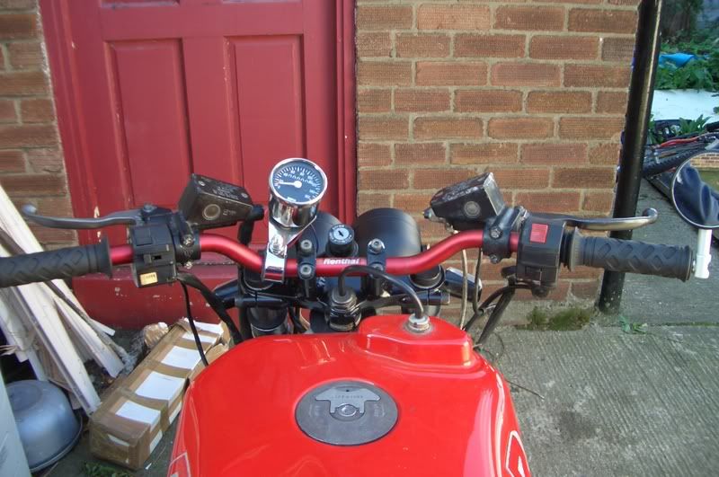

Time for handlebars:
https://img.photobucket.com/albums/v246/super_jo/gix15sep083003.jpg
https://img.photobucket.com/albums/v246/super_jo/gix15sep083007.jpg
https://img.photobucket.com/albums/v246/super_jo/gix15sep083009.jpg

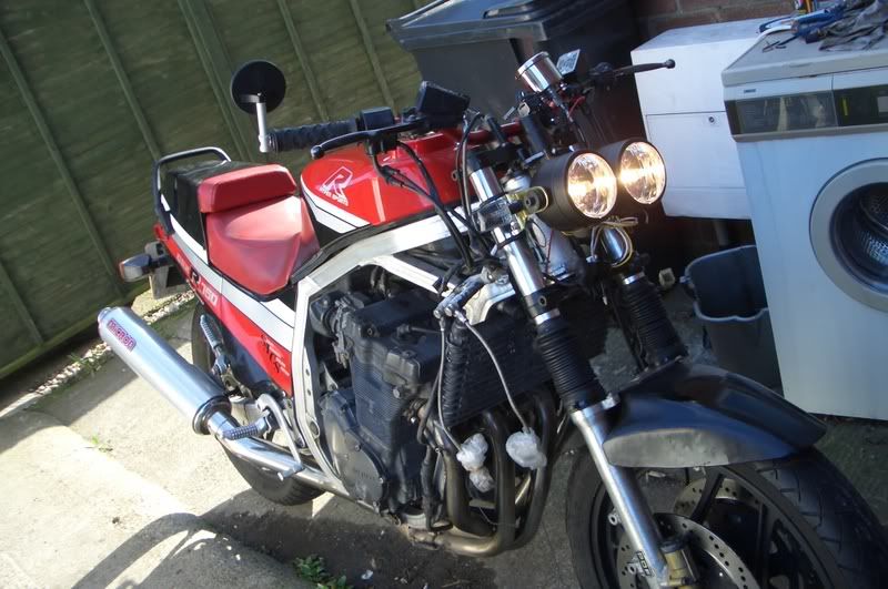

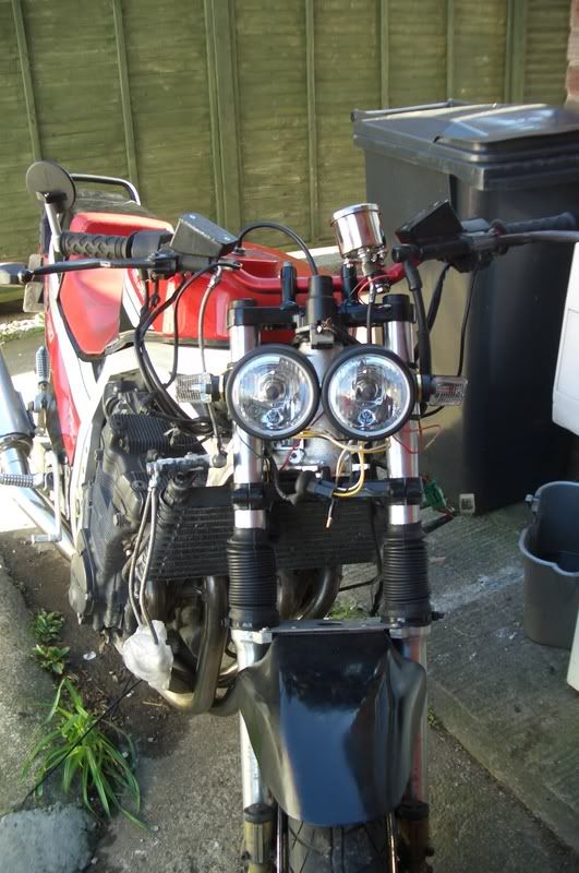

And headlights!
https://img.photobucket.com/albums/v246/super_jo/gix15sep084001.jpg
https://img.photobucket.com/albums/v246/super_jo/gix15sep084003.jpg
https://img.photobucket.com/albums/v246/super_jo/gix15sep084005.jpg
https://img.photobucket.com/albums/v246/super_jo/gix15sep084006.jpg
And they bloody work too Laughing
https://img.photobucket.com/albums/v246/super_jo/gix15sep084007.jpg
https://img.photobucket.com/albums/v246/super_jo/gix15sep084008.jpg

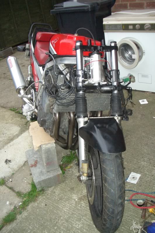

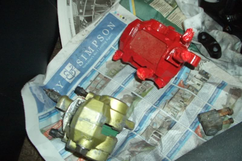

I also decided to 'spruce up' my front calipers which had just been serviced...well the red hammerite spray was on offer!!! Shifty
https://img.photobucket.com/albums/v246/super_jo/gix15sep082011.jpg
Need to finish the other one, I have an extended top brake hose on order so once that's done I can fit and bleed them.

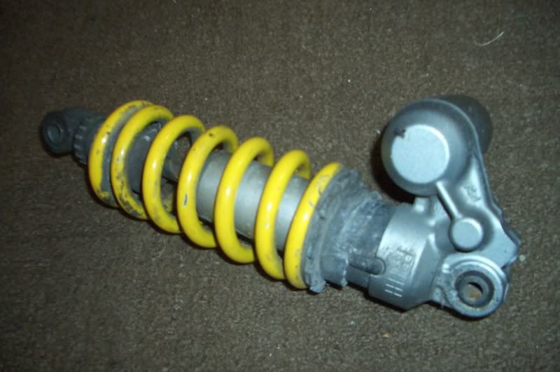

Also received this:
https://img.photobucket.com/albums/v246/super_jo/gix15sep083001.jpg
off our very own LukeVFR, it will go on eventually but I'm gonna try to MOT it with the shit original one on...

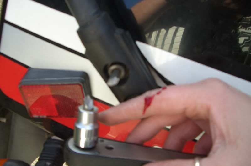

Oh, and taking the seat off to get to the battery, I got in a fight with a grabrail bolt, resulting in this:
https://img.photobucket.com/albums/v246/super_jo/gix15sep084012.jpg
Ow. Crying or Very sad Even worse once I realised it wasn't a Halfords Pro socket, so I wouldn't get a free replacement Laughing

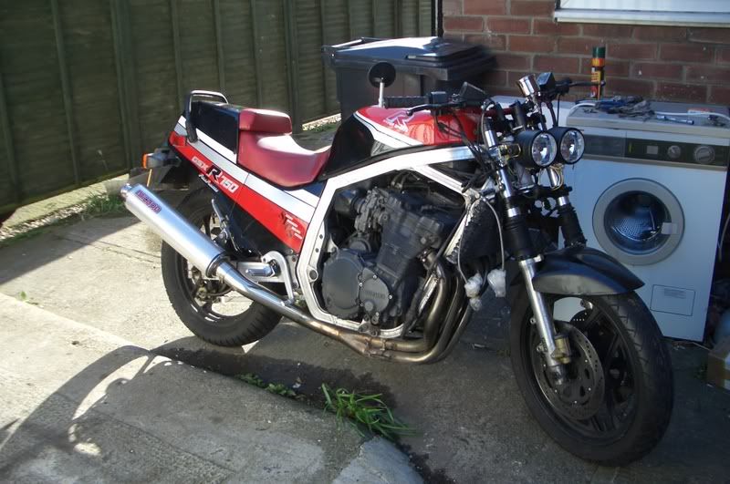

Errrr....kinda like it (even though I'm sick of seeing GSXR streetfighters). Just don't matt black what bodywork is left! Only things I don't like are the fork gay-ters and the presence of one of those god awful universal speedos. Didn't you have the standard clocks? Cause you can still buy all the rubber bits if they are a bit wobbly.
Gaitors are a bit ming, but as it'll get some motorway miles this winter I thought I'd better protect them Laughing
I'm not sure on the speedo myself - I do have the original clocks, but gave the bracket away.
Don't really want bulky clocks though. I did pick up a bicycle speedo for 3 quid from tescos yesterday, am contemplating that. Thinking Smile
Matt black is staying well away from this machine Hand Laughing I was gonna do shiny black with some fancy airbrushing on the tank, but the original colours have really grown on me.
Need to fill the dented tank and touch up the paint, then I think it will stay red and black for now Thumbs Up Cool

Also gonna chop a couple of inches out of the seat and recover it in black leather. Mr. Green

I was thinking of commenting on the seat, on the one hand it is old skool 80s cool, but on the other it is faded and essentially now pink... I think it'll look better in black.
One thing that I'm ashamed to say is really bothering me is your bar furniture, space it out properly, the gaps between grips and switchgears and levers is really annoying me Embarassed
Mudskipper
PostPosted: 15:22 - 07 Oct 2008    Post subject: Reply with quote
Don't worry, I sorted that after the last pics were taken. Switchgears were just finger-tightened on for fixing the bars on, and I just stuck the left grip on for the last photos.
Then saw the awful gappage Shocked Laughing

petemell
Joined: 01 Apr 2008
PostPosted: 22:06 - 07 Oct 2008    Post subject: Reply with quote
Hi, it looks like you got a really good bike coming on. But just wondered if I could ask if the front brake master cylinder and clutch master cylinder are sitting at a bit of a steep angle now they are on the Renthal bars.
The tops of the master cylinders normally sit a lot flatter when they are on the standard bars. My main concern would be that the front brake doesn't get an airlock in the master cylinder piston chamber when the bike is leaned over on the sidestand.
It probably is a quick easy fix, either adjusting or changing the bars, hopefully someone else will be along in a bit to varify if this is ok or not, as I am not sure. There is a pic below of a similar GSXR streetfighter and you can see the difference.
Well spotted.
Depends where the pick up holes are though. If they are on the insides, Then its probably okay. But if they are on the Out side's, I'd be watching those sight glasses like a hawk!
Back to OP.
Gixxer's looking good though. 10000x better than it did when you first got it! Cool
I'm with Jake on this one though. It's crying out for some 1100 forks.
Mudskipper
PostPosted: 08:18 - 08 Oct 2008    Post subject: Reply with quote
Thanks Pete, I'll bear that in mind and have a good look when I'm putting the brake system together. That's one of these things that you just don't know when it's my first (proper) project! Thumbs Up

As long as you can lean the bike right over to fill the resevoirs and bleed the systems they should be alright, but if you tried doing it with the bike upright it looks like you'd only get about 1/2 as much fluid in as you should.
If it doesnt work for whatever reason I have a resevoir and master cylinder off an NTV knocking about that you can have for p&p.

Luke, I was at least expecting the shock to arrive wrapped in a photo of your cock. Neutral

i'm using the standard slabby mastercylinders on my rethalled fighter with no problems...
only awkward bit is bleeding the systems due to the "on the piss" angle of the reservoirs, but once done they're fine

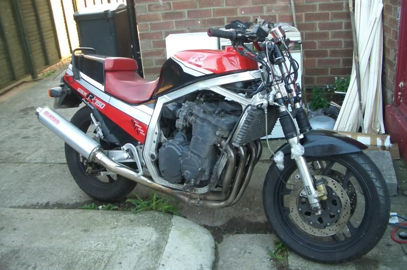

NC30 Pilot | NO2ID Worcester Coordinator

Got the front calipers back on, they look cool (from a distance, get too close and you can see all the drips Laughing ) so I 'm happy there.
Got a longer top braided hose cheap off ebay.
Couldn't bleed them though, rounded master cylinder cap bolts which I will be able to sort in the next couple of days hopefully.

Looks wank though, anyone know of a (cheap) mini horn that will pass an MOT?
Had a proper look at my rear brake disc, realised it was worn to fuck. 3.5mm thickness when MINIMUM is 5.5!!! Shocked It was probably the original from 1986 Laughing Got a cheap replacement on the way. Thumbs Up
Need to strip the rear caliper and see if it's usable next, I assumed it was the problem with my rear brake not working, but more likely is the combo of worn disc and dead pads. Probably.
Might need a new battery as it doesn't last long after charging (when stood) and these bikes need a good battery or they'll refuse to start.
Then I can test ride and MOT the bugger!! Finally! Only taken 3 bloody months. Rolling Eyes I've got riding withdrawal soooo bad. Laughing

Good progress. Very Happy When is the MOT? Does the R6 shock fit straight on? I still have the bolts if it makes it any easier... I was in hospital and asked my mum to post it so couldn't tell her what bolts to include... Let me know if you want me to dig 'em out if it'll make your life any easier... Wink
Cheers Luke, will be checking out how the shock needs to go on after the MOT (hopefully Laughing )...pipes are pretty solid, dunno when they were put on since it's a replacement system. It's just the fact they all move around independantly while I'm trying to line them back up!!
