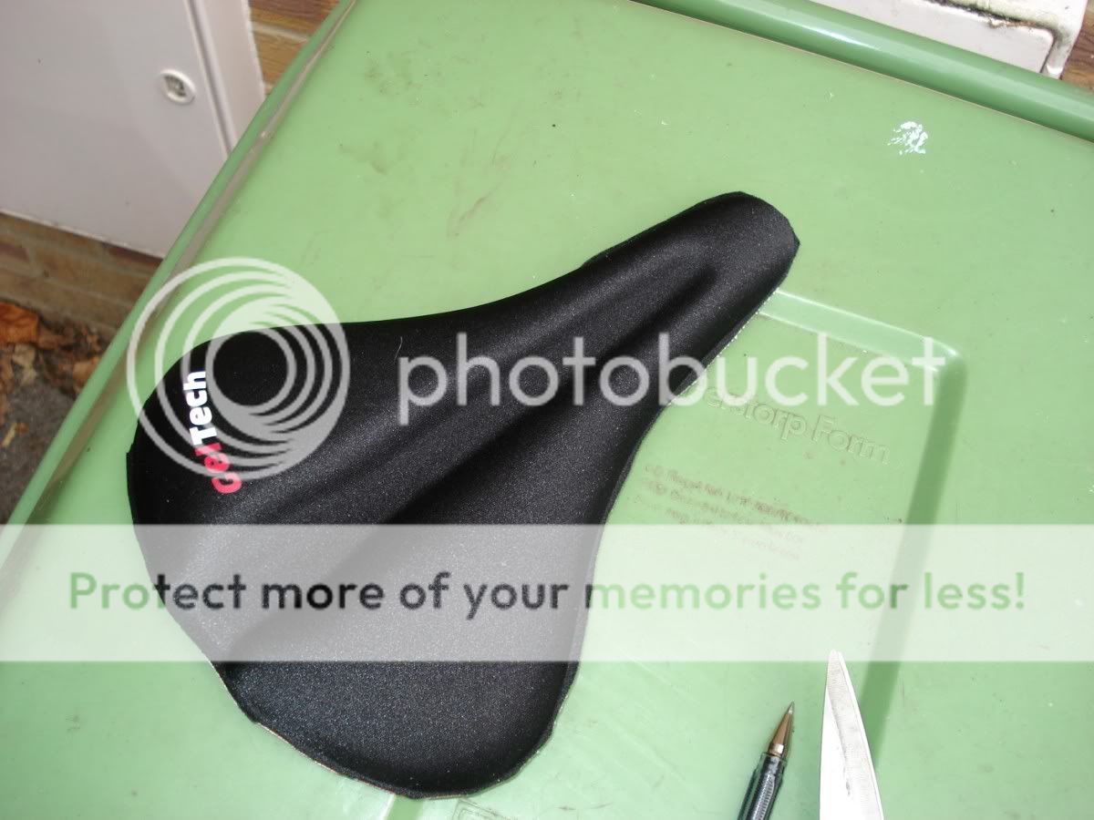

i) The gel cover used (cut back to gel only) :
https://i15.photobucket.com/albums/a392/martinthorn/DSC00855.jpg

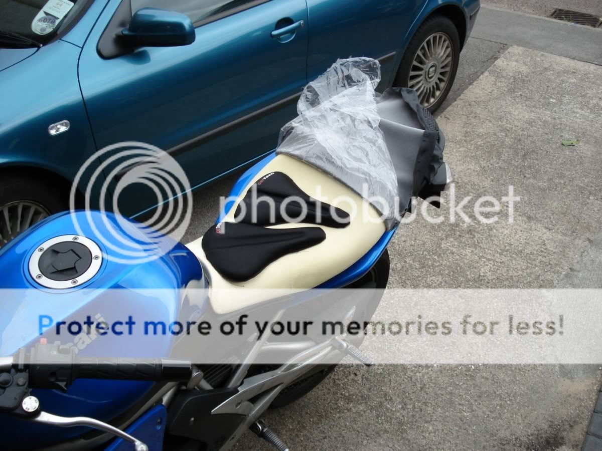

ii) In position (tried them in a few different places before
super-gluing to foam)
https://i15.photobucket.com/albums/a392/martinthorn/DSC00859.jpg

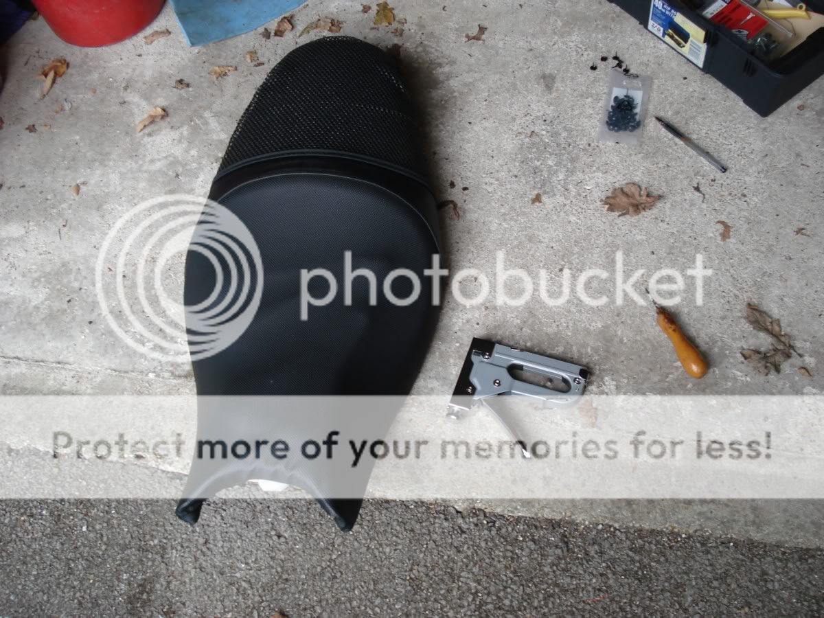

iii) Nail/staple gun used to fix the seat cover back on, yes you can
still see the gel covers !
https://i15.photobucket.com/albums/a392/martinthorn/DSC00863.jpg

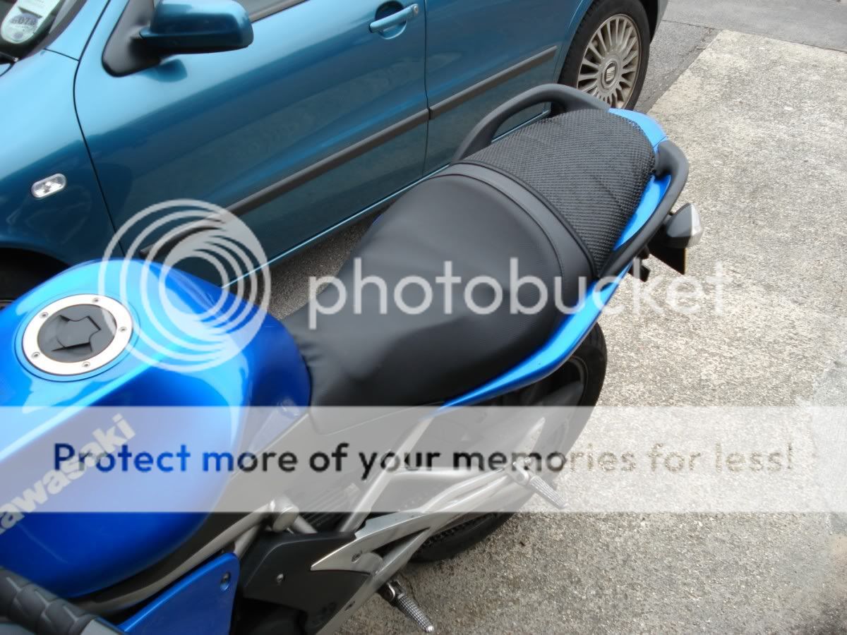

iv) finished seat on the bike
https://i15.photobucket.com/albums/a392/martinthorn/DSC00864.jpg
