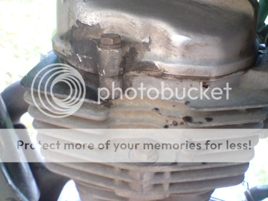

Hey guys.
Had a wee problem with the CG today, decided to cut out on me half way home.
Started up fine after a few kicks and rode fine all the way home, except it was jumping about in 5th gear.
So i got the thing home and took the chain cover off. And the chain was tight, and the sprockets were fine as far as i could see.
Turned the wheel round a few times and all was good.
Then had a look at the engine....
Shocked
Oil everywhere.
Help! Sad

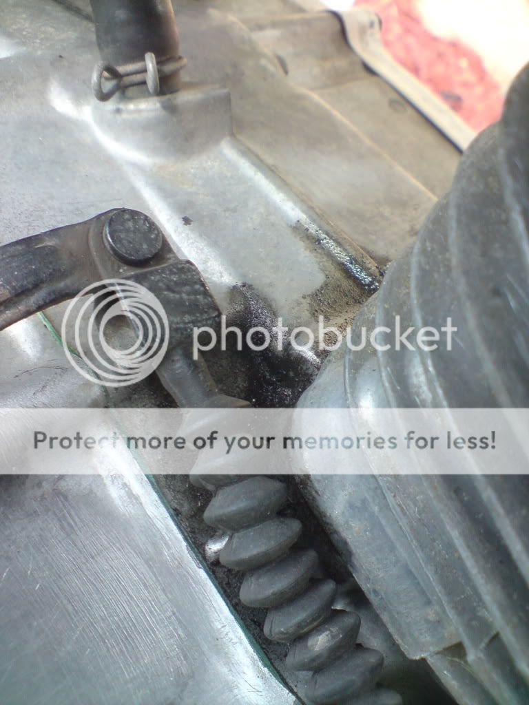

under the cluch cable.
https://i624.photobucket.com/albums/tt325/duncdmc/DSC00011.jpg?t=1245166956

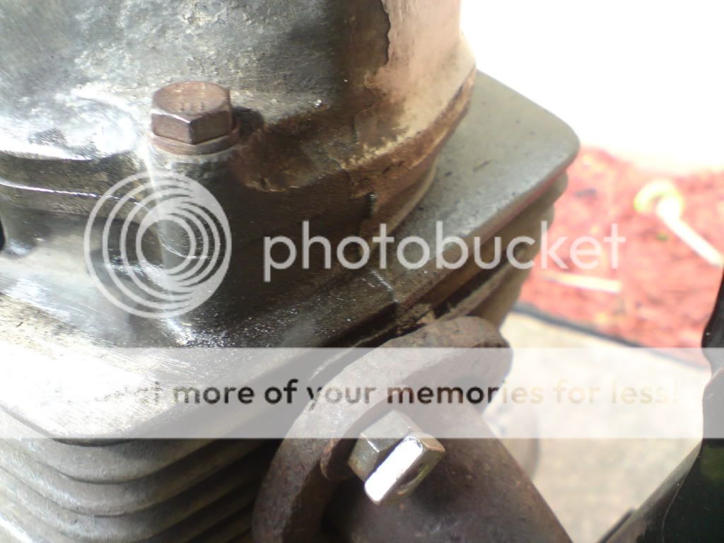

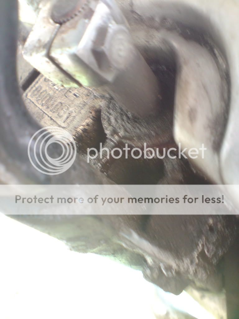

My guess is the gasket is gone.... And not really surprised seeing as the guy before me hadn't been near it with a touch of oil never mind a spanner.

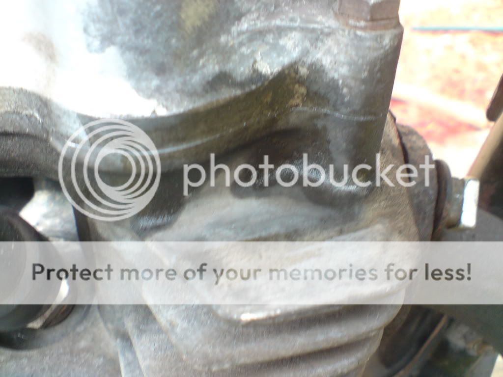

Then decided to check the Oil level as it was HOT.
https://i624.photobucket.com/albums/tt325/duncdmc/DSC00012.jpg?t=1245166913
Only topped up the oil yesterday, was just under the max indicator.
Done about 100 odd miles today i think.... been out for quite a while, but no way should it have drank all the oil.

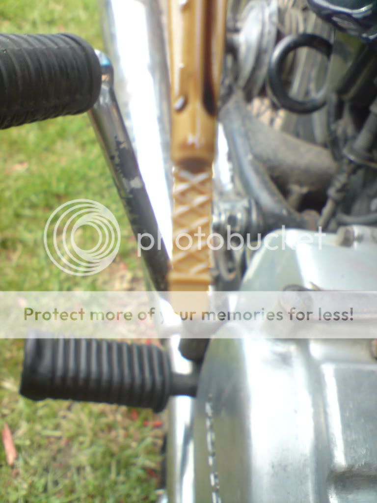

And this is under the gear lever, pretty mucky with oil.

Just looks like the head gasket has gone, i think its just a rubber ring on top.
The last picture if that is the gear selector doesnt look bad as the front sproket throws oil or whatever lube you put on off around that area and it runs down to there and then onto the stand, its why i remove my front sproket cover each month and clean around mine.
The oil around the base of the cylinder could just be the leaking head gasket, replace the rubber ring clean it all of including the area down below and top up oil see how you go from there.
Hope it helps. Remember theres only about a litre of oil in there.

It looks like the base gasket and the valve cover gasket is leaking. The head gasket looks fine but i would replace it anyway if you are going to do the base gasket.
What do you mean by the chain been tight? Have you set the chain free play? If it is too tight it can cause the surging you are talking about and strange gear change problems.

By the look of it the rocker cover seems to be the worst part of it. Check its not leaking down the and resting on the crankcase before you decide its the base gasket too.
The base gasket is an easy fix and if it drinking oil then there is your oppurtunity for a bit of a top-end overhaul. There still seems to be oil on the dipstick so just make sure you are testing it fairly by wiping off all the excess oil and then resting disptick in and not screwing it in (might be the opposit though and thats why you are not getting a reading, im not sure of how it is on the CG)
Gear level seal is probably worn aswell, again an easy fix. Thumbs Up

I have a CG too, when I saw the oil around the gear lever and underneath I too thought I had an oil leak but when you take off the front sprocket cover it's fairly obvious its all just getting flung off from there, I wouldn't worry about that too much Thumbs Up
