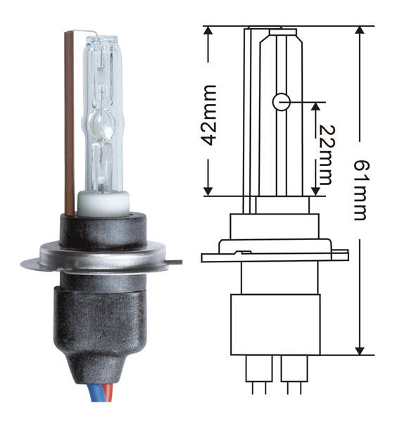

But from what I have to say, I think the 35 W jap import bikes use H4 terminals BUT you may have to bend the pins on the headlight collar or use the appropriate spaces because if you look at here:
https://my.frooition.com/080612/images/H7%20metal%20base.jpg
On the 400/250's, the prongs that stem from the ring to locate the position of the bulb in the headlight unit are spaced equally, i.e. every 120 degrees. I'd check to see with your manual or cradley kawasaki first to determine your connectors because a poorly aimed beam will piss people off no end.
It MAY be cheap if you buy from china, but you've got to remember that if it does go wrong, it'll cock up big time. Secondly, you might get stung with Customs charges. My HID's on my 6R cost me 30 quid inc delivery, but now, since the exchange rates don' favour the pound, they've gone up to 40 inc del... So i opted for a UK seller. Digital ballast = plug and play - literally 2 wires!
