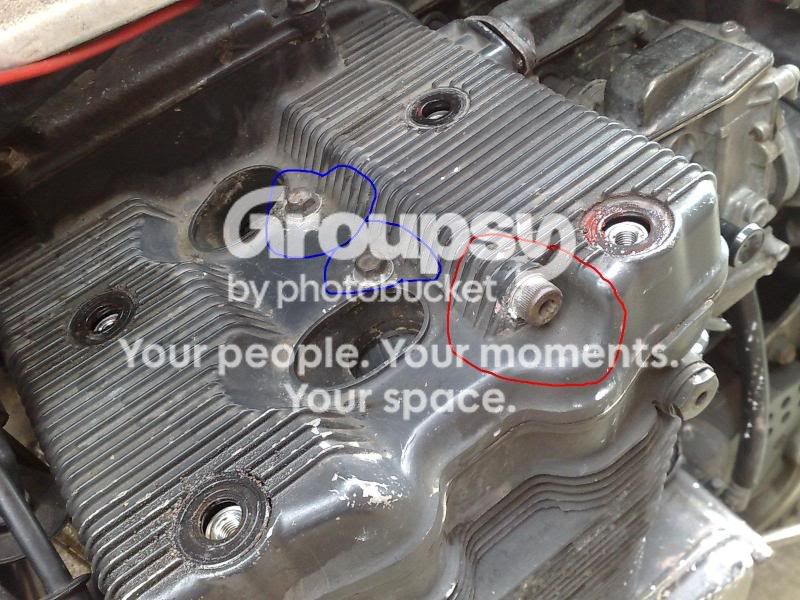

I'm trying to do my tappets on the slabby (GSXR750 G [86]) and having undone the valve cover bolts, the cover wont budge. Even with rubber mallet taps. Mad
Now Haynes did not mention these two bolts, are they also vavle cover bolts? I don't want to remove them and then find they hold something else on which has then dropped into my engine Rolling Eyes
There's one either side:
https://img.photobucket.com/albums/v246/super_jo/valvecoverbolt-1.jpg
Remove or no?
Cheers for any help. Thumbs Up
PostPosted: 11:49 - 10 Jul 2009    Post subject: Reply with quote
Assuming it is the same as the Bandit you do not need to touch those. They are just blanking bolts for an oilway across the cover.
There are 2 locating dowels which are probably what is holding the cover in place.
Mudskipper
PostPosted: 11:50 - 10 Jul 2009    Post subject: Reply with quote
Excellent, thank you so much for the quick reply Keith.
Any idea how i can budge the cover? Book of Lies says don't pry it off, obvously to avoid damaging the gasket. It's not moving at all.
PostPosted: 12:05 - 10 Jul 2009    Post subject: Reply with quote
In the Bandit manuals it does tell you to remove the 4 bolts (Banjo bolts) that are near the plug wells.
Mudskipper
PostPosted: 12:09 - 10 Jul 2009    Post subject: Reply with quote
Ahh, ok. Will they be the ones marked in blue then? Smile
https://img.photobucket.com/albums/v246/super_jo/valvecoverbolt-2.jpg
PostPosted: 12:24 - 10 Jul 2009    Post subject: Reply with quote
Yes, they bolt down through the cover into the head.
You can see the threaded holes they go into here:-
https://www.alfa-pages.co.uk/TempPicture/BanditHeadUnderCover.jpg
Mudskipper
PostPosted: 13:35 - 10 Jul 2009    Post subject: Reply with quote
Excellent, thanks Keith.
I got the cover off easily after removing those bolts. Turned the engine so the cam lobes were in the right position etc.

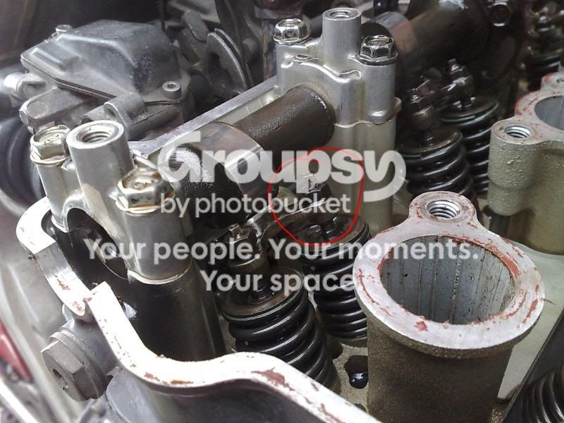

Started checking the actual clearances, and now have another problem.
How DO I actually adjust them? Confused
It says screw and locknut, yes there's a locknut, but where on earth does the screwdriver go to adjust them?!? It's just a square nobule thingy, there's nowhere to screw!?!
Am I being completely thick? Confused Brick Wall Embarassed Sad
https://img.photobucket.com/albums/v246/super_jo/valves.jpg
PostPosted: 13:41 - 10 Jul 2009    Post subject: Reply with quote
You need a square nobule thing spanner.
Once the locknut is undone, you should be able to twiddle them by hand.
If you need a tool, looks like a bicycle spoke key would fit those nicely. Or a bit of flat bar with a small notch filed into the end.
Mudskipper
PostPosted: 14:08 - 10 Jul 2009    Post subject: Reply with quote
You are a legend Sir.
4 down, 12 to go!! Thumbs Up Very Happy
Mark65
Joined: 16 May 2008
PostPosted: 14:16 - 10 Jul 2009    Post subject: Reply with quote
Same as the ones on my ybr, you can turn them by hand once lock nut is loose or as i did use an old bike spanner and file or grind a little groove into it. But to be honest finger tight or a slight turn with pliers will do it, it doesnt take much really.
Mark
PostPosted: 14:34 - 10 Jul 2009    Post subject: Reply with quote
Stinkwheel has answered you well, but just a triffle concerned that the nearest valve in the picture appears to already have the locknut undone.
Mudskipper
PostPosted: 16:43 - 10 Jul 2009    Post subject: Reply with quote
Don't worry, that's the first one I undid and then was stumped as to how I turned the screw.
(I know the cam lobe for those two valves is set wrong for checking - I realised this halfway through, so had to re-do them all! Laughing )
