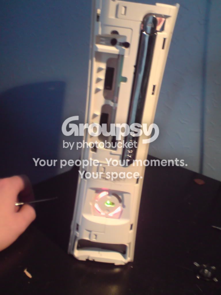

started it up the other day and it had the RROD.
Did the towel trick, and it worked till this morning...
So i took it to bits Smile
https://i624.photobucket.com/albums/tt325/duncdmc/DSC00239.jpg?t=1255965638
https://i624.photobucket.com/albums/tt325/duncdmc/DSC00231.jpg?t=1255965652
https://i624.photobucket.com/albums/tt325/duncdmc/DSC00232.jpg?t=1255965670
https://i624.photobucket.com/albums/tt325/duncdmc/DSC00233.jpg?t=1255965684
https://i624.photobucket.com/albums/tt325/duncdmc/DSC00234.jpg?t=1255965716
https://i624.photobucket.com/albums/tt325/duncdmc/DSC00235.jpg?t=1255965725
https://i624.photobucket.com/albums/tt325/duncdmc/DSC00236.jpg?t=1255965751
https://i624.photobucket.com/albums/tt325/duncdmc/DSC00237.jpg?t=1255965763
https://i624.photobucket.com/albums/tt325/duncdmc/DSC00238.jpg?t=1255965796
Fun fun.
Just waiting on the new screws now...
Dunc

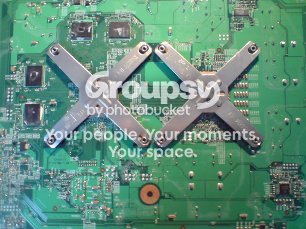

The x clamps aint tight enough to hold the heatsink onto the processors, and the processors onto the motherboard.
So when it heats up, the motherboard bends by a tiny fraction, and the cold welds on the GPU break...
If this don't fix it, it's a microsoft job.
you can buy new screws for the board, mines should be here tomorrow.

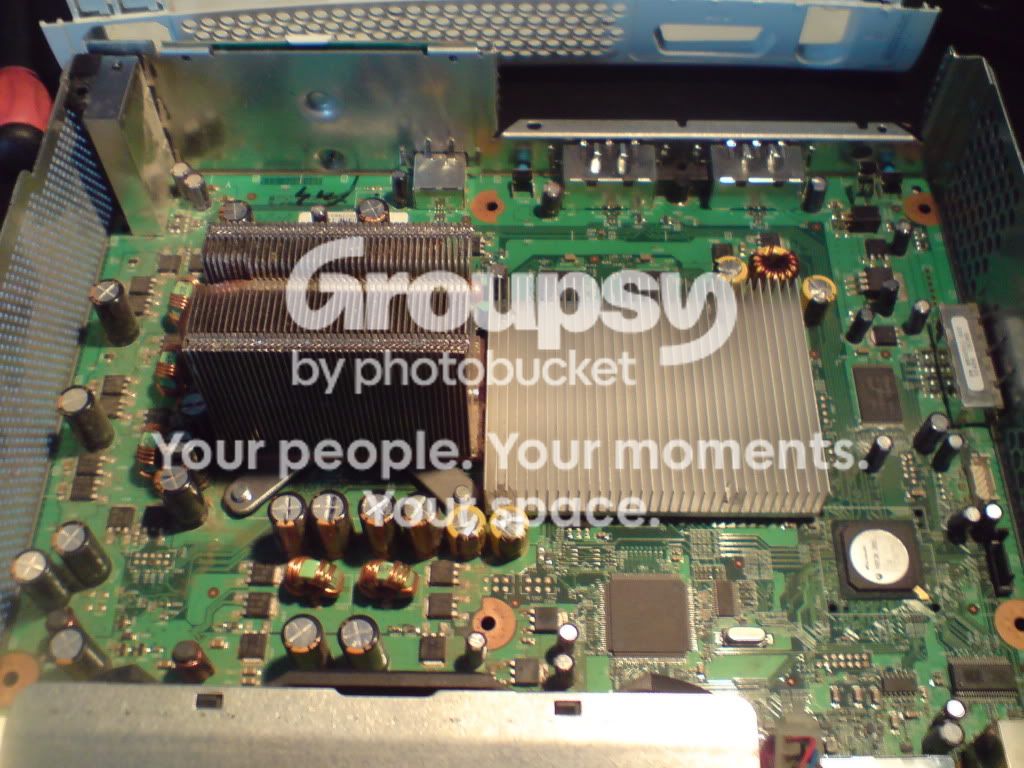

I wonder if using the xbox without the plastic case on, and possibly an extra fan on the heat sinks would solve the overheating issue. I've run several computers for several years without a case... just a PSU and a mess of cables. Without a case I've never ever had an overheating issue.

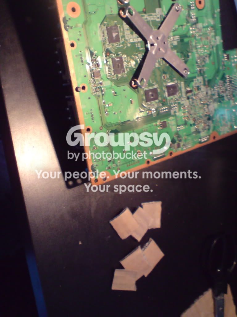

What the hell are the bits of card for?
did you try the llama bake method first?
Turbo R1
CRF450R
TUG
Joined: 12 May 2007
PostPosted: 19:05 - 19 Oct 2009    Post subject: Reply with quote
Over the RAM chips on the back? Thumbs Up

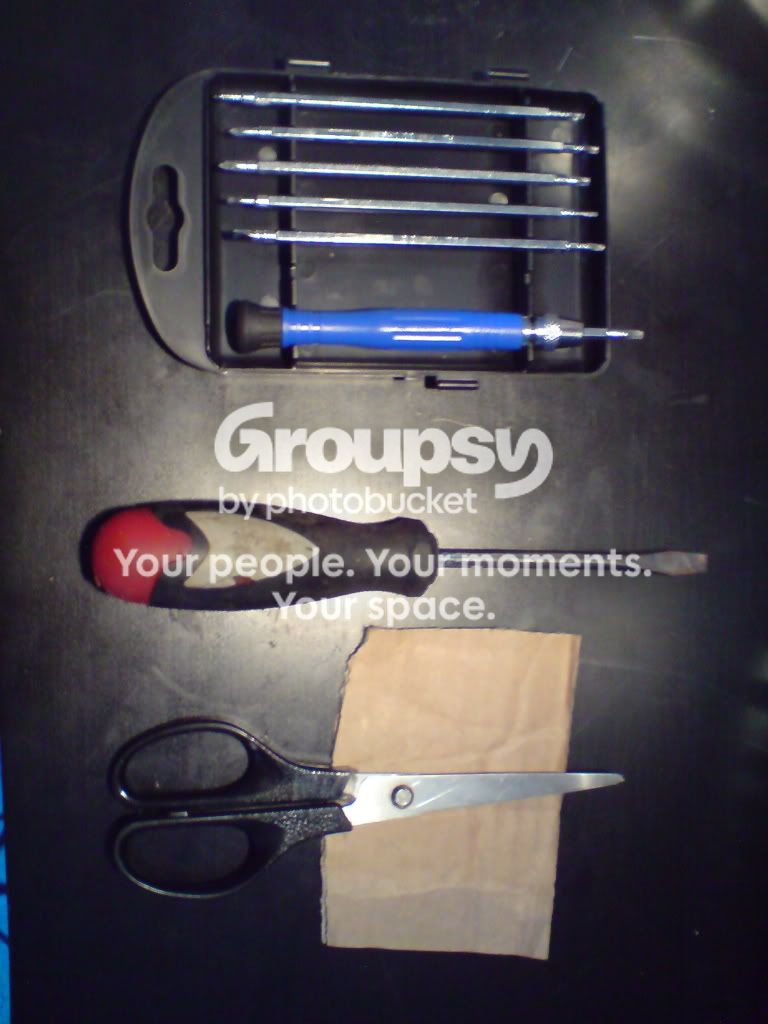

The cardboard was actually for under the x-clamps, just to see if it worked.
nothing happened, so i'm waiting on the new screws coming now Thumbs Up
When i got the xbox, it had coins glued to the ram chips...
Peeled that off and it worked fine for a whole night Laughing
Dunc

When your board is screwed into the case, the case actually push's the Xclamp points which in turn takes pressure off the GPU/CPU.
They need to be removed and replaced with bolts with a very slim head on them so the same thing doesn't happen again, I always go bolt, spring washer, board, nylon washer, metal washer, heatsink.
