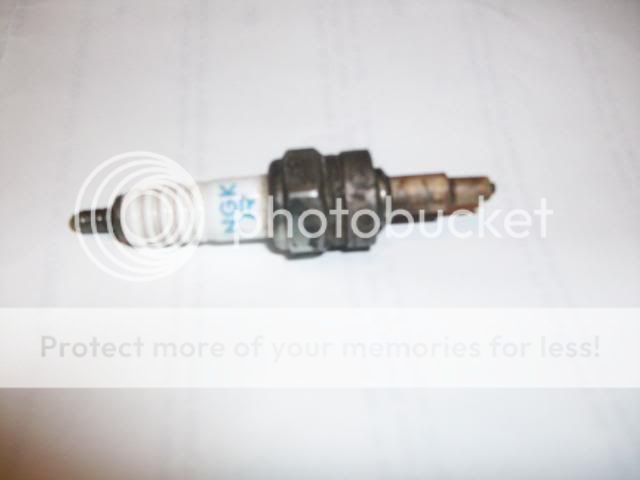

slight problem when i tried to remove a spark plug Shocked
https://i626.photobucket.com/albums/tt349/Kaiser_Damz/RVF/100_0231.jpg
https://i626.photobucket.com/albums/tt349/Kaiser_Damz/RVF/100_0232.jpg
the plug snapped when i tried to remove it, it started to move then snapped so luckily i managed to get a flat headed screwdriver to catch on the lip of the plug and twist it out.

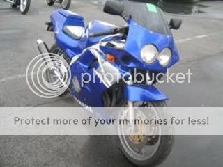

reminds me of...
https://img30.imageshack.us/img30/9468/188zet.jpg
damz
Joined: 15 Jul 2007
PostPosted: 13:48 - 22 May 2009    Post subject: Reply with quote
mattsprattuk wrote:
what type of headlight is on that? also im going to keep the mudguard as i rode the other bike without a mudguard for a few days and clogged up the radiator very quickly.
Current Bikes RVF400 - 94
Cars: RX7 FD, Eunos Roadster
MaybeGuy
Joined: 12 Mar 2007
PostPosted: 14:08 - 22 May 2009    Post subject: Reply with quote
https://img33.imageshack.us/img33/7251/197v.jpg
no idea what they are
neatbik
Joined: 27 Jun 2007
PostPosted: 16:17 - 22 May 2009    Post subject: Reply with quote
They look like Triumph Speed Triple/Speed Four lights to me.

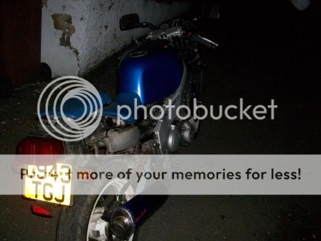

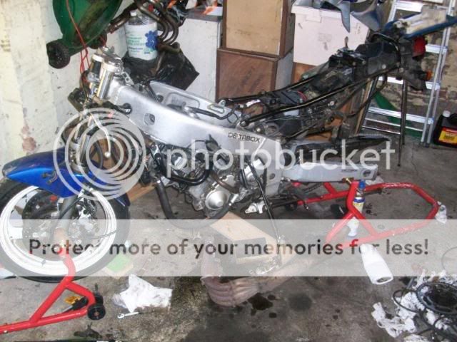

bit more work done today as i had nothing else to do.
got it down to this
https://i626.photobucket.com/albums/tt349/Kaiser_Damz/FZR/100_0305.jpg

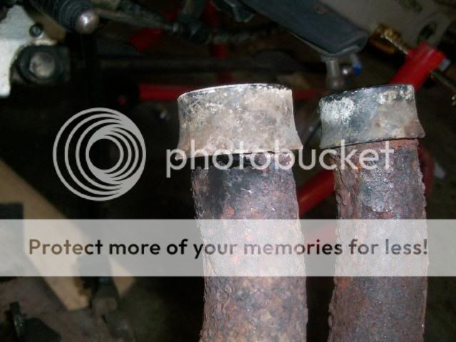

i have removed the exhaust and found this.....
https://i626.photobucket.com/albums/tt349/Kaiser_Damz/FZR/100_0297.jpg
pretty gubbed, im guessing its a total loss, however getting a replacement will be pretty dam hard as the exup exhausts for these are fairly rare.

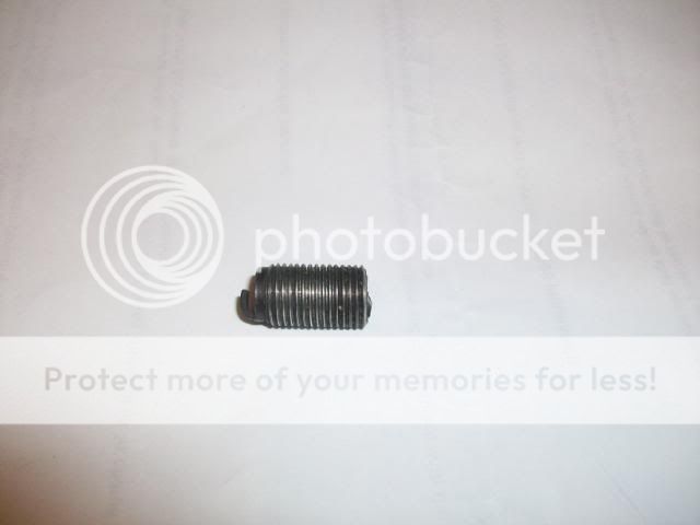

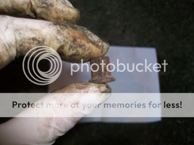

also when i removed the studs some ended up like this
https://i626.photobucket.com/albums/tt349/Kaiser_Damz/FZR/100_0312.jpg
while others came out like this
https://i626.photobucket.com/albums/tt349/Kaiser_Damz/FZR/100_0313.jpg

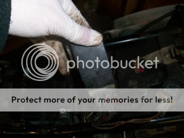

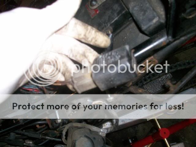

iv'e started trying to shift some of the electrics. are these two safe to move from the outside of the subframe to the inside?

thinking off getting a metal plate fabricated to run from under the seat to under the pillion seat and get it to cover the center of the subframe and curved so water shouldnt be able to reach the electrics.

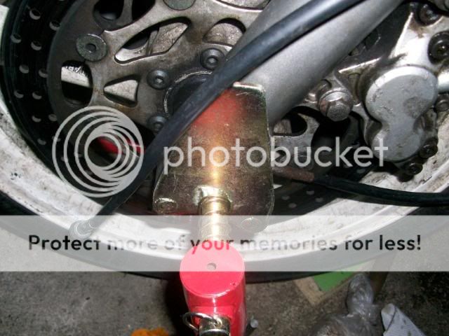

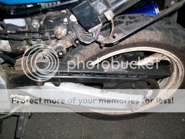

also im wanting to remove my front wheel, as you can see in the pic above i have a front padock stand however im somewhat confused how to do it as there are metal plates blocking the spindle so i cant remove it.
https://i626.photobucket.com/albums/tt349/Kaiser_Damz/FZR/100_0315.jpg

The metal plate should be facing downover, the 2 bars one sits under the leg the other supporting behind the leg.

managed to remove the front wheel and to Steve -d's comment earlier. that did not work at all, basically the fork just rolled off the metal bars making it impossible to use it that way. i took out the spindle and quickly put the stand on the way i had it before and is ok now, luckily the front end is stupidly light so the mudguard just rested ontop of the tyre.

any suggestions on what to do? i'd imagine getting new exhaust fabricated would also face the same problem of letting too much gas out and would be very expensive
PostPosted: 11:09 - 26 May 2009    Post subject: Reply with quote
That is why you need someone who knows what they are doing with the exhaust, not the local boy racers place that thinks puttign a drain pipe on a Nova will make it much faster. Probably best to just copy what is already there with correct size pipework.
To be honest the first thing I would investigate is getting that pipe repaired.
Could also be worth trying Motad and see if they make a suitable system.
Your forks are too narrow then.
My diversion was the same, would just slide straight off.
