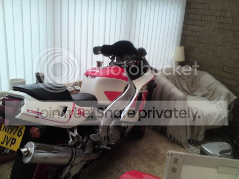

The garage dude that told me about it...was just using it to keep the damp out of the air in his garage. I will check back with him maybe tomorrow... BTW this isn't to heat my garage... it's not damp...it actually my conservatory as there is no heating there.. and I don't want to use oil etc... electricity Thumbs Up
I want to keep my YZF damp free this winter...
https://i133.photobucket.com/albums/q73/funmonkee/forums/P12-12-09_1319.jpg
