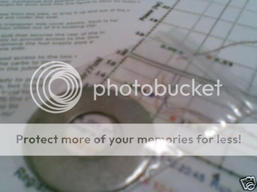

Handily, I found a picture of the washers for this very kit (someone sold one on ebay, so it's a picture of the actual kit, not just a generic picture of restrictor washers):
https://i48.photobucket.com/albums/f216/stinkwheel/restrictor.jpg
So I'll be able to work out the ratio of outside to inside diameter from the picture.
Now all I need to find is the outside diameter, so I need to know where they fit in the air inlet (measuring this should give me the outside diameter) or is it safe to assume they are the same OD as the carb choke?

I make the hole in the washer 0.84 (+or- 0.5mm) of the outside diameter. So I make a washer that is a tight fit in the rubber, measure its OD and make a hole 0.84 times that size in the middle.
Slight error on the sizes but it's a safe bet that at 24k miles, it isn't making the same power as a new one anyway, which is what the restriction will be calculated on.
