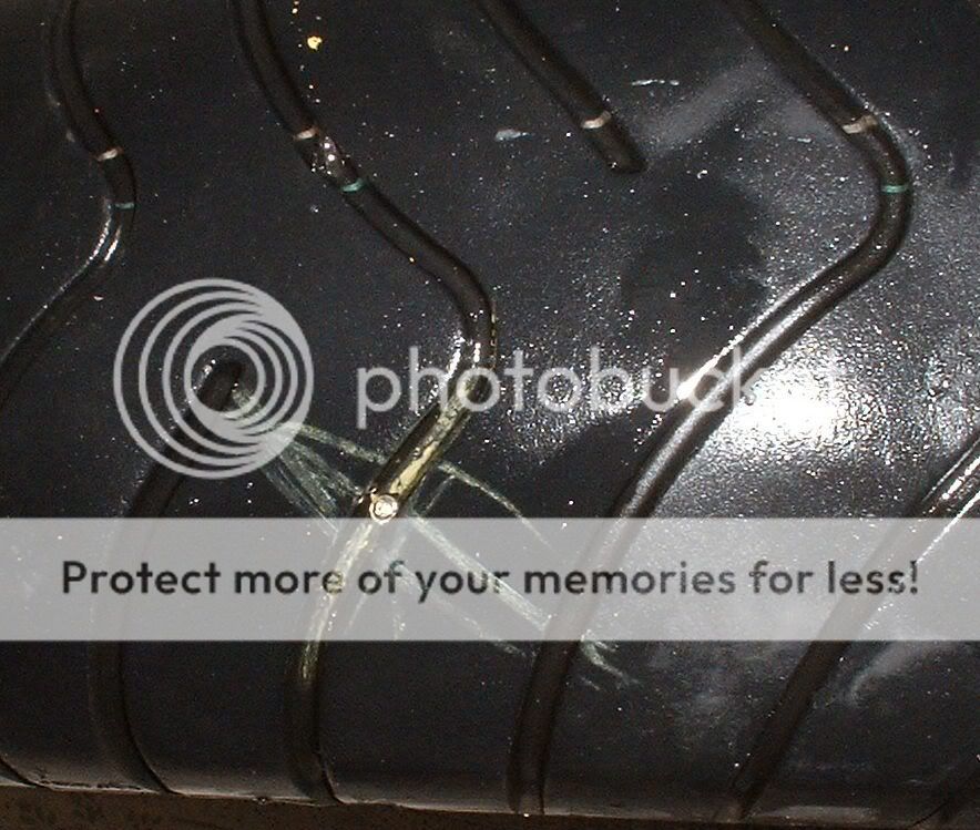

I actually repaired!? one myself like that ... but not from the outside as a temp fix like you ... I took the tyre off, and screwed a screw in from the the inside ... i.e. so the head would prevent it from coming out, worked a treat!! Thumbs Up
Basically the tyre was worn such that it wasn't really financially logical to have it plugged, but I was too tight to throw it away with that much tread left ... so I did a DIY screw repair!! Thumbs Up
I also did a outside repair that worked fine too ...
Puncture source to the right, my screw plug repair to the left (actually an RC servo mounting screw!! Laughing)
https://i208.photobucket.com/albums/bb319/blue_sv650s/puncture_3.jpg
The completed repair, a perfect seal Thumbs Up
https://i208.photobucket.com/albums/bb319/blue_sv650s/puncture_1.jpg
The puncture that finally made me give up on that tyre as I didn't have a screw big enough!! Laughing
