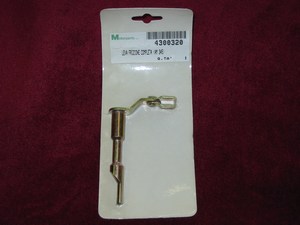

My problem was discovered when refitting the clutch cable. No matter how I adjusted the cable, it was too long, so I pulled the level going into the engine which disengages the clutch.
It moved quite a lot and actually came fully out. I have attatched a picture of it. Red line is casing of the engine, and the top bit is the little arm that the cable attatches to.
The top of this "arm" is splined so you can move the arm around for adjustment. I have done and it works now, albeit very stiff and as I pull the clutch lever this whole rod raises a few mm.
I want to know what is wrong basically. If anyone has an exploded parts diagram for this engine I would be very greatful.

I found a picture of one.
https://www.startright.co.uk/images/mini-IMG_8227.JPG
It looks just like that. Why does it raise itself out of the engine slightly when pulled? Is it possible the pushrod bearing has gone?

Clutch arm is on the other side of the engine to the clutch so it means splitting the case to find any problems.
Today I took the clutch cover side off, removed the clutch plates.
The clutch arm works by pushing a "rod ball rod" configuration. The final rod pushes the clutch open.
It seems to work fine now. I managed to snap one of the spring holders though so I need a new clutch basket thing anyway now.
