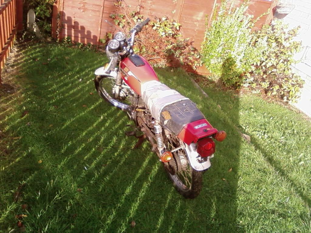

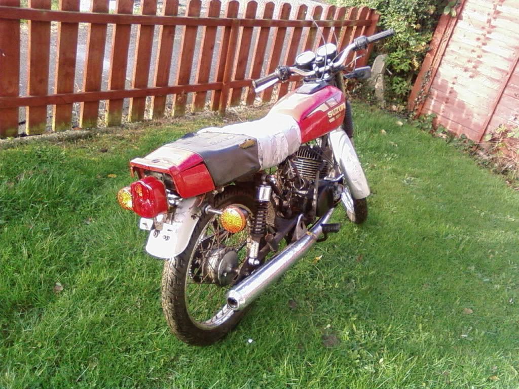

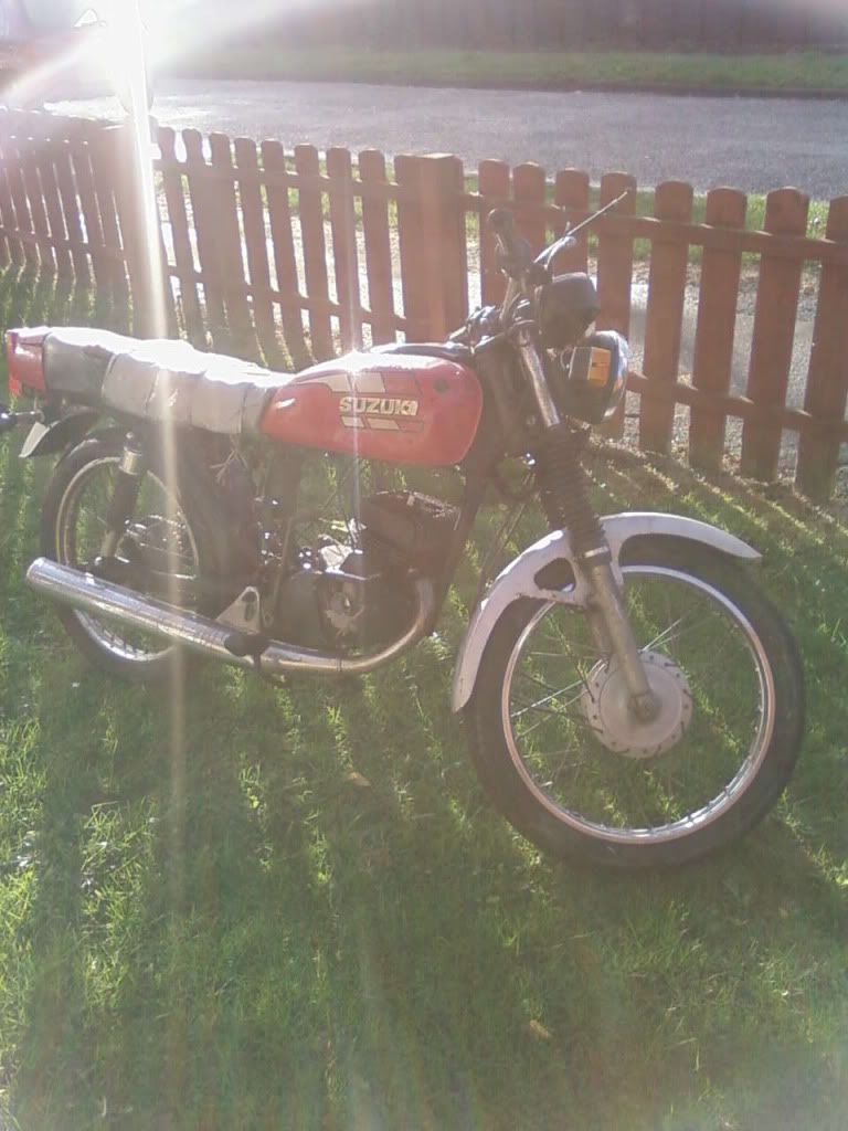

Ive recently acciered a suzuki gp100 with no v5 docs no history the frame numbers and keys are there, Its also HPI clear so ive sent off for the v5 document.
But needing some ideas on the restore as its been sat in a garden for years.
I belive its a 1972 model ive had a good look around the bike and have a small list of things i need to fix/get
seat, chain, brakes, spark plug, and a service ( to get it running )
new loom , side pannels, fork seals , battery and thats it i think
im thinking about ratting it ( as dunc told me too ) Laughing
anyone have any tips on how to go about the tasks any help on anything else that i should be aware of ?
heres some photos

That model has points, as I recall, so be careful. Loads of people holed the pistons of GP100s and 125s.
That'll be a 1982 model, not 72 Wink I take it that was a typo.
Pretty good bikes, those that haven't rusted away. My mate tuned the buggery out of one and had it doing an indicated 90. I rode it once and it felt like it was doing about 200, but was probably nearer a real 80 Cool

usually its under the seat, looks like yours may have been removed and made to run premix.
have a gander on ebay, should be a 2t tank on there, aswell as an airbox which also appears to be missing

i had compleatly forgot to update this ! Sad
well update
gp100 has had a overhaul everything works
and its now ready for it phase of ratting
