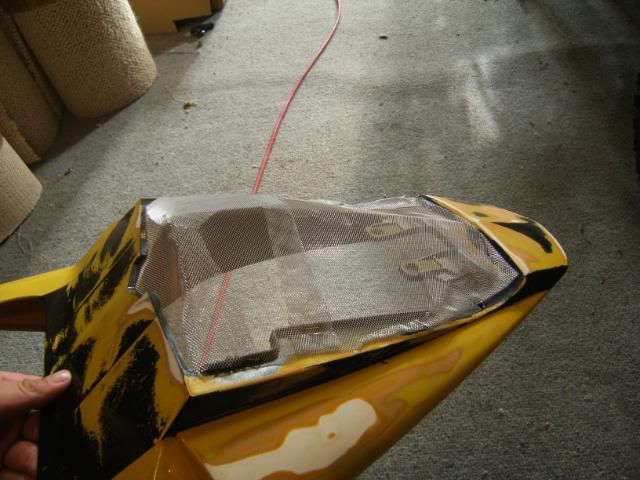

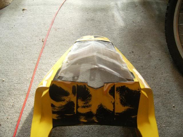

So, today I decided I want to get rid of the pillion seat, and create a one piece seat fairing.
To start I go the rough shape that I needed with some aluminium mesh, and used a staple gun to fix it in place.

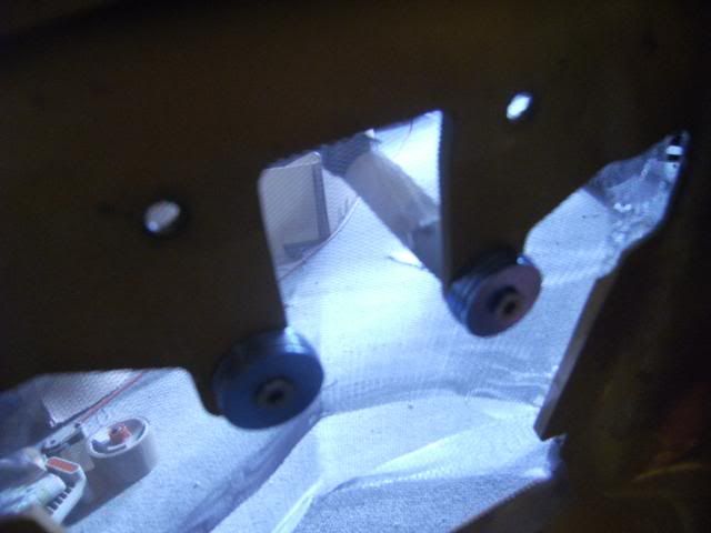

Next I used 2 bits of wooden dowel to allow me to screw the fairing on, I obviously didn't want to no be able to attach the fairing, so the dowel leaves the 2 holes needed to do this. In the future I am hoping to find a plastic tube or similar that fits in and I can glue in.
I attached the dowel to the fairing mounting points at the bottom with screws and washers, and covered the wood in a rubber glove so I can get it out when the fibreglass has set!

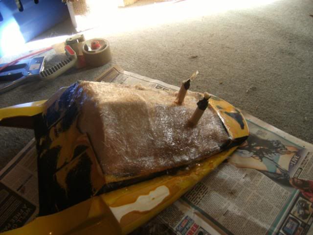

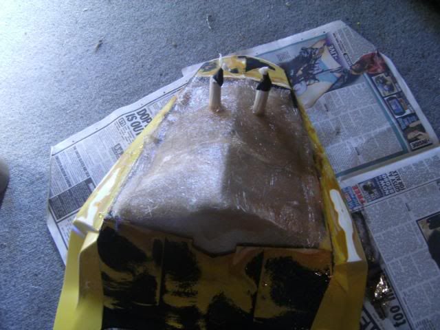

Next comes the fun/annoying part...fibreglassing. This stuff is amazing....but so annoying, it goes everywhere!
https://i6.photobucket.com/albums/y209/angelgrinder187/DSCF1907.jpg
https://i6.photobucket.com/albums/y209/angelgrinder187/DSCF1909.jpg
Will see how it looks when it's dried, then I'll see if it needs more fibreglass, or if I shall start applying the filler!
Any tips or advice from anyone?

I like the cereal box Laughing Would have probably been alot less messy than the aluminium mesh - all the resin seeped through and is everywhere!
Also, we have already reached problem number one....not enough hardener. It was still sticky yesterday, but seems ok tonight, going to give it another day to harden, hopefully will be ok to start sanding tomorrow!
Also, had a panic when I realised the subframe may not fit into the new space, but I have checked and we are all good!
