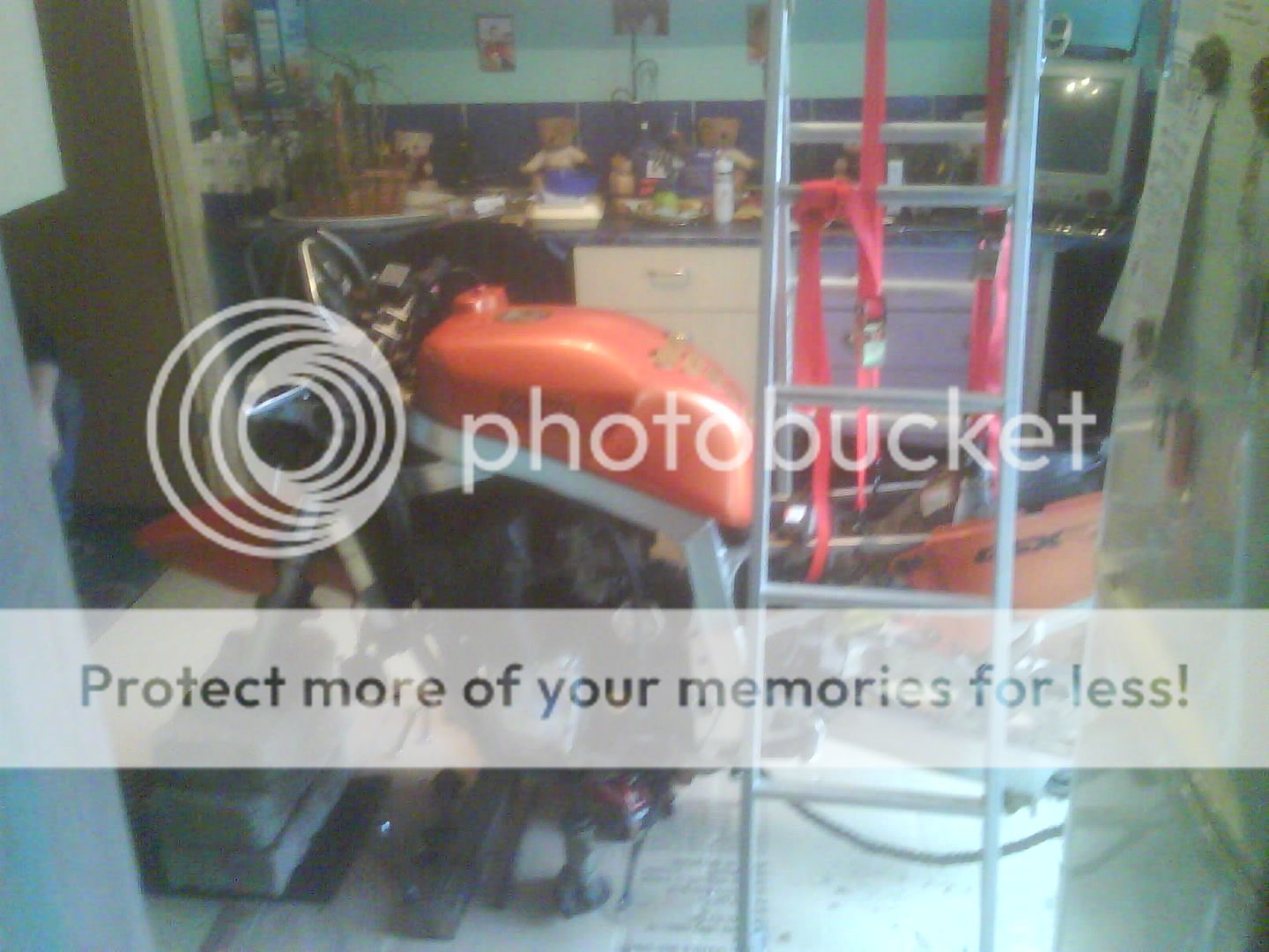

Didn't have the rear off the ground but i doubt there would have been a problem if i needed too.
https://i191.photobucket.com/albums/z170/serlant/16052009021-1.jpg

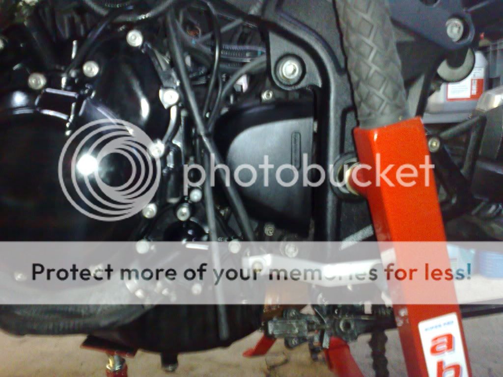

https://img.photobucket.com/albums/v295/chris-red/06052009223.jpg
Abba Stand and front lift, I think it was about £120 all in all, more expensive than axle stands but once it was delivered it took me longer to get it out of the packaging than it took to get both the TDM's wheels off the ground on my own first time. Now I can get my bikes up on the stand in about a minute less than 30secs if sombody is helping me.
