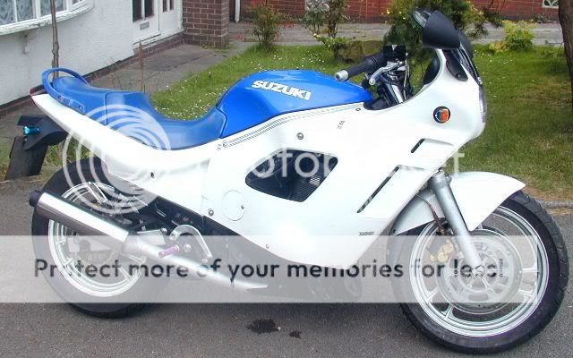

https://i93.photobucket.com/albums/l41/marki_03/GSXF/1before.jpg
No idea where I'm going but I strip down the rear end. Seems simple but it involves ripping out the battery, loom, relays, wheelarch(?) and a load of other junk. The engine was tuned some time ago so already had K&N pod filters fitted. I brought a single seat unit off a CBR600 some time ago and put that on for looks.

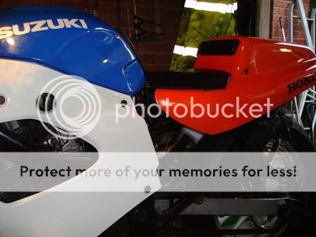

Didn't look too bad so I knock up a temporary frame to locate it while I work out how to blend to the tank. I also found a shock off something, once again not a clue I just remember it being Suzuki. Wherever it came from it lifts the back end up a couple of inches. I also had a bandit rear hugger that I managed to get to fit before deciding I didn't want it.
Looks a mess in there!
https://i93.photobucket.com/albums/l41/marki_03/GSXF/3frameold.jpg

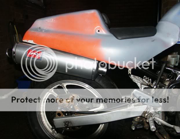

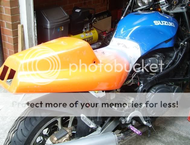

Some GRP and filler latter and its going alright.
https://i93.photobucket.com/albums/l41/marki_03/GSXF/4seatGRP.jpg

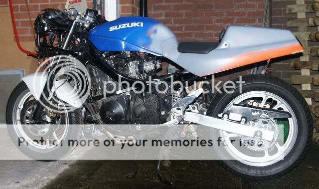

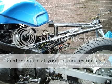

Best bit next, angle grinder. I cut the main brace off the rear end, knock up a subframe and weld it in. I use the proven method of testing my welding and jump up and down on it a few times. Hit it with a hammer and its still there so that'll do me.
https://i93.photobucket.com/albums/l41/marki_03/GSXF/5frame2sm.jpg

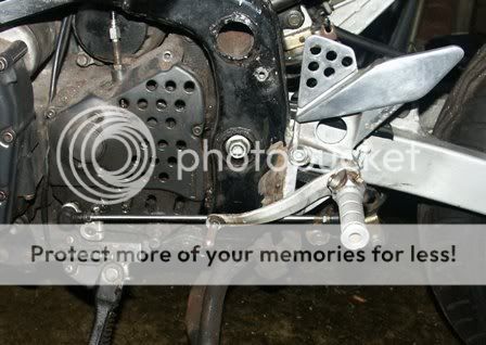

Pegs next. Only ones I've got are some damaged one which might be off a ZXR or a FZR can't remember. If anyone knows I'd be grateful since I'm probably going to have to get some better ones.
Cut the frame right back and weld in some mounting plates. Knock up a gear change rod, took ages to find my LH thread dies, and all works well. Jump up and down on the pegs a few times and nothing breaks so jobs a good 'un.
https://i93.photobucket.com/albums/l41/marki_03/GSXF/6pegs.jpg

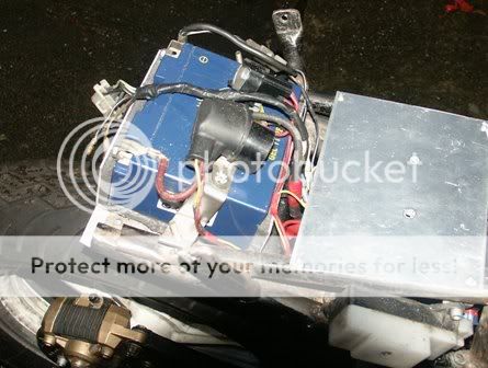

Loads of little jobs later and the gel battery is fitted and a home made loom installed. Key in, starter button pressed and the bike turns over. All the electrics are tested and work fine.

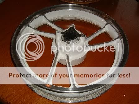

Wheels are looking a little worse grubby so quick nitromors and some enamel paint seems the way to go.
https://i93.photobucket.com/albums/l41/marki_03/GSXF/8wheel.jpg
And that's where I've got to. One of the guys at work has made me some seat pads off the templates I gave him. Nice job.

um.. bit of an update. boss is on holiday so im off work for a week.
so, im giving it a clean. this morning did the down pipes, link pipe and can.
then gave it a wash, the wheels are still covered in chain lube and road crap, but thats tomorrows job. along with re-attaching the numberplate / rear light cos the fibreglass broke and it fell off when i was going down the a49. lol.
maybe thursday or friday im going to start working on a new loom. very stripped down. running the coils straight from the battery through a relay controled by a switched live. anything that needs an earth will be fed with two core to minimise the amount of wire.
