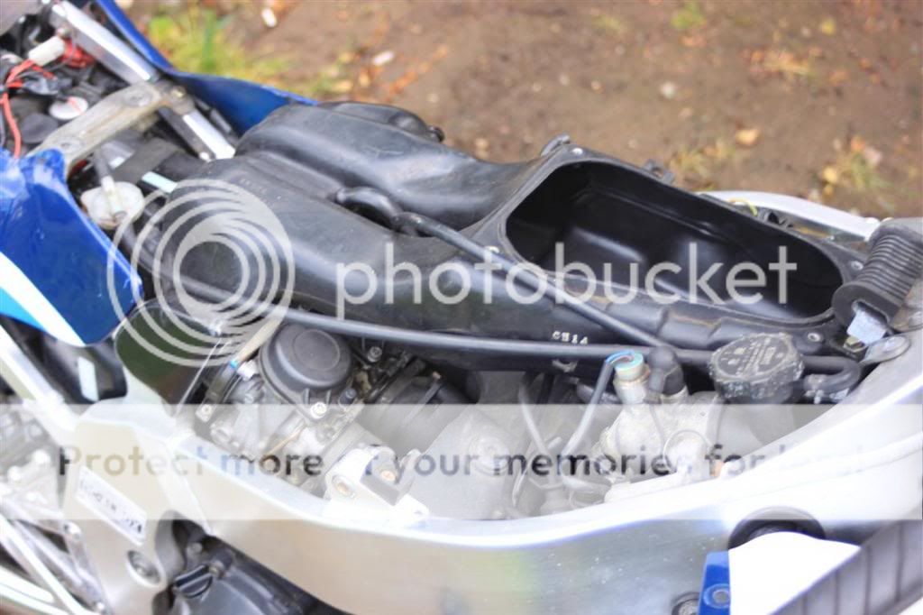

air filter out
https://i939.photobucket.com/albums/ad233/chris-bracey/GK73A/IMG_1104Medium.jpg
airbox and carbs out, was a piece of piss
