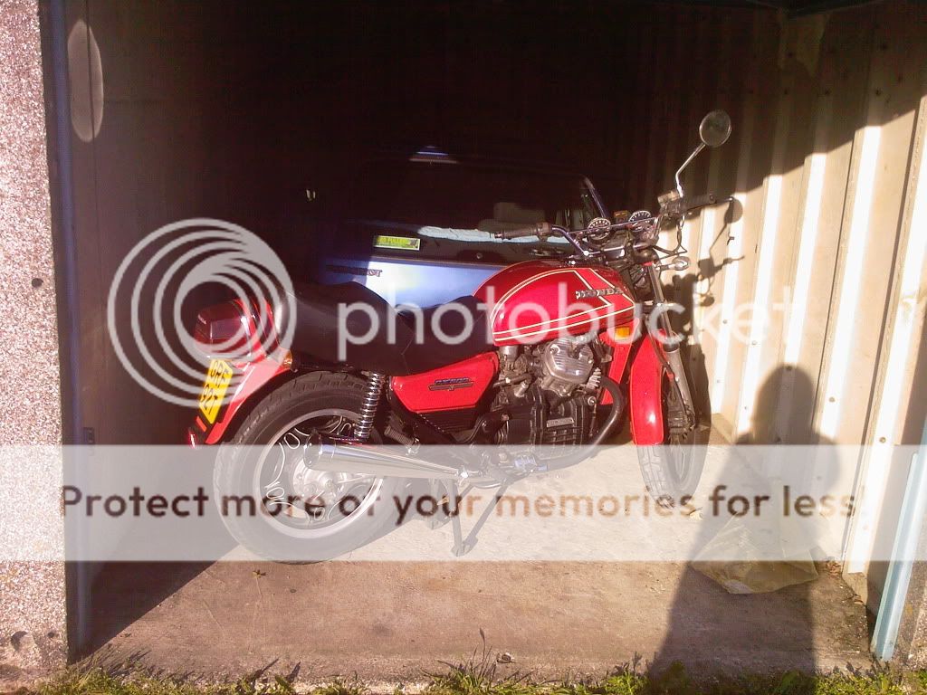

My dads bike has been sat in my garage now for some months in bits, As it wouldnt run its had new rings, new plugs, plug caps, coils, carbs cleaned, its getting air and breather have been done also. It wants to turn over but just wont fire up.
Its got a very good spark the fuel is getting there, its got good compression.
but still wont start.
My dad has told me that he rode it to work done his shift (about 9 hours) went to start it and it wouldnt. Ive tried bumping it still no go.
Any ideas ?
Also heres a picture of his bike, So you know what it is just incase.
https://i391.photobucket.com/albums/oo360/tonymini145/Photo-0128.jpg
