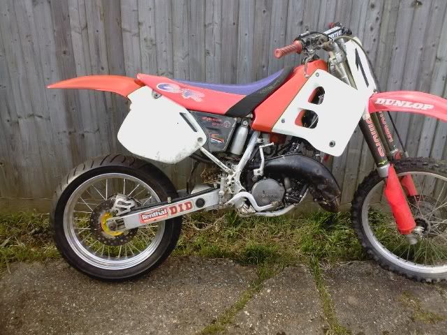

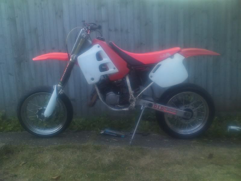

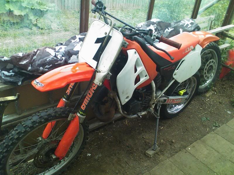

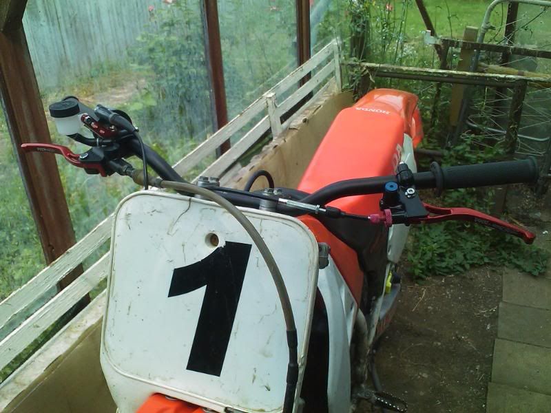

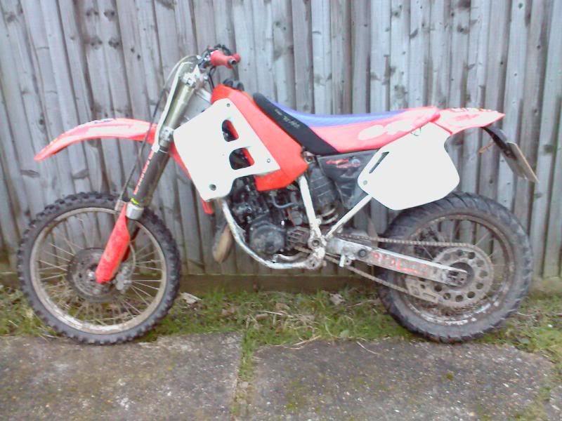

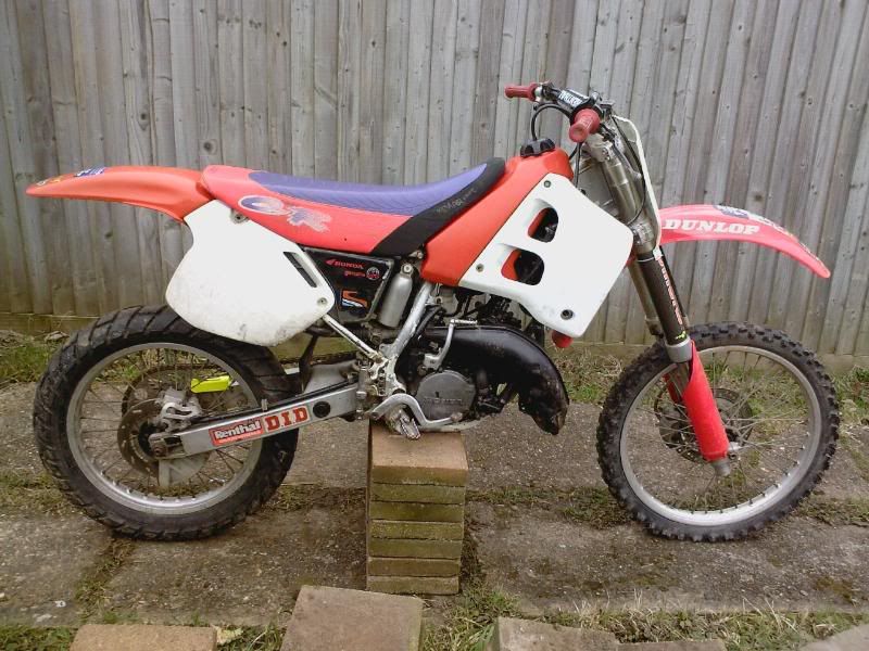

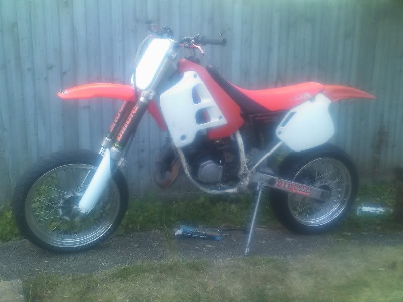

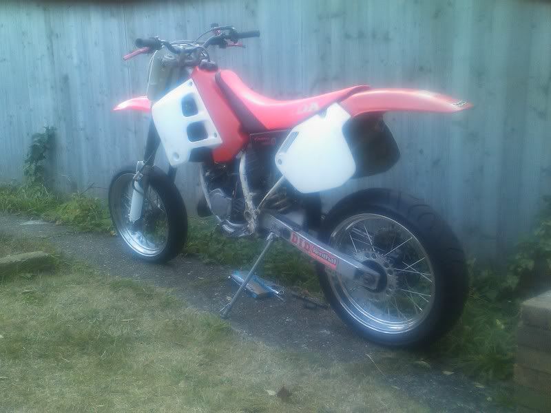

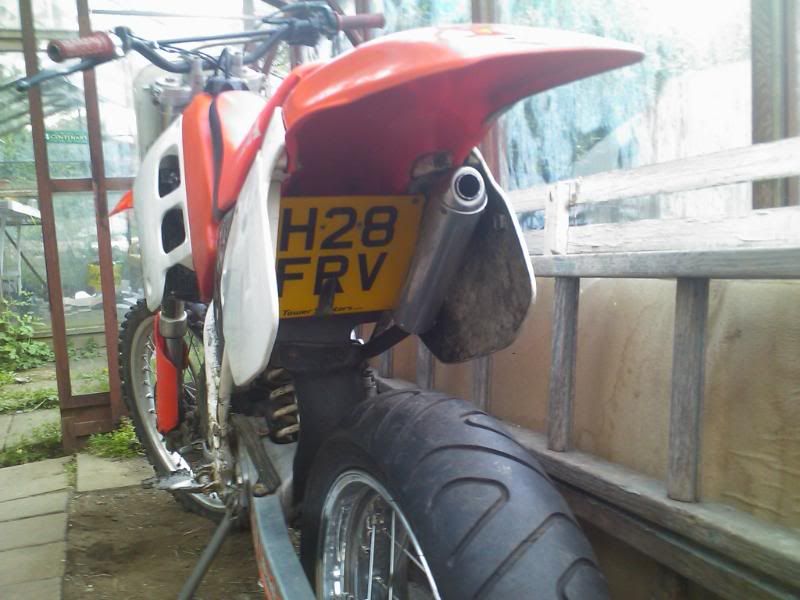

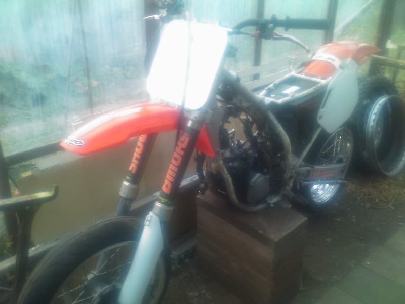

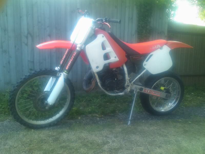

Well well, new here fella's & woman.. Wink
Thought i shall show off what i got because its trapped in my back garden & i keep poking it with new parts once in a while Neutral
Well bought this a non runner for £400 Thumbs Down mid feb this year, needing new piston n ring & a power valve cover, i wish that was all that it needed doing but always turns out to be a mega on going money grabbing £ucking project! Surprised haha so i knew i was going to build something super with it as i do with everything i buy.. its personalization!
I rebuilt the topend myself (was easy as playing with lego) i sourced a topend with recent recon & bought new small end bearing, piston & ring & full gasket set, fitted all that & it started & runned fairly well for first time. Then the project began...
little clip of it then i got it going.. exhaust didnt fit header properly & rear pipe needed repacking why it sounds pop'ish, i sold the rear pipe & bought a 93 one
https://www.youtube.com/watch?v=9PL763QJBX0
As the pixs go from old (muddy) to how it is now (with both supermoto wheels on) i've spent abit over £1100 including buying it.. not bad huh?? Neutral
https://img.photobucket.com/albums/v363/trevcannon/My%2091%20CR125%20Street%20Supermoto%20Project%20Build/Photo0252.jpg
https://img.photobucket.com/albums/v363/trevcannon/My%2091%20CR125%20Street%20Supermoto%20Project%20Build/Photo0260.jpg
https://img.photobucket.com/albums/v363/trevcannon/My%2091%20CR125%20Street%20Supermoto%20Project%20Build/Photo0303.jpg
https://img.photobucket.com/albums/v363/trevcannon/My%2091%20CR125%20Street%20Supermoto%20Project%20Build/Photo0332.jpg
https://img.photobucket.com/albums/v363/trevcannon/My%2091%20CR125%20Street%20Supermoto%20Project%20Build/DSC_0005.jpg
https://img.photobucket.com/albums/v363/trevcannon/My%2091%20CR125%20Street%20Supermoto%20Project%20Build/DSC_0016.jpg
https://img.photobucket.com/albums/v363/trevcannon/My%2091%20CR125%20Street%20Supermoto%20Project%20Build/DSC_0039.jpg
https://img.photobucket.com/albums/v363/trevcannon/My%2091%20CR125%20Street%20Supermoto%20Project%20Build/DSC_0144.jpg
How it is now..
https://img.photobucket.com/albums/v363/trevcannon/My%2091%20CR125%20Street%20Supermoto%20Project%20Build/DSC_0149.jpg
https://img.photobucket.com/albums/v363/trevcannon/My%2091%20CR125%20Street%20Supermoto%20Project%20Build/DSC_0148.jpg
https://img.photobucket.com/albums/v363/trevcannon/My%2091%20CR125%20Street%20Supermoto%20Project%20Build/DSC_0150.jpg
Still not finshed it needs quite afew more little bits doing & forks seals need doing, the front supermoto wheel on it im getting the rim built onto the cr hub, renthal r3 chain, brake pads all around, gear lever, air filter, front exhaust.. i might get a cr500 one & mod the header to fit, then sorting out my diy electrics for my horn & speedo which i am going to use two 6v rechargeable hump packs you will find being used in model R/C kitcars
christ i do go on alot & i've hardly said anything about the bike just dont want to list everythink i have done to this bike! Shocked
