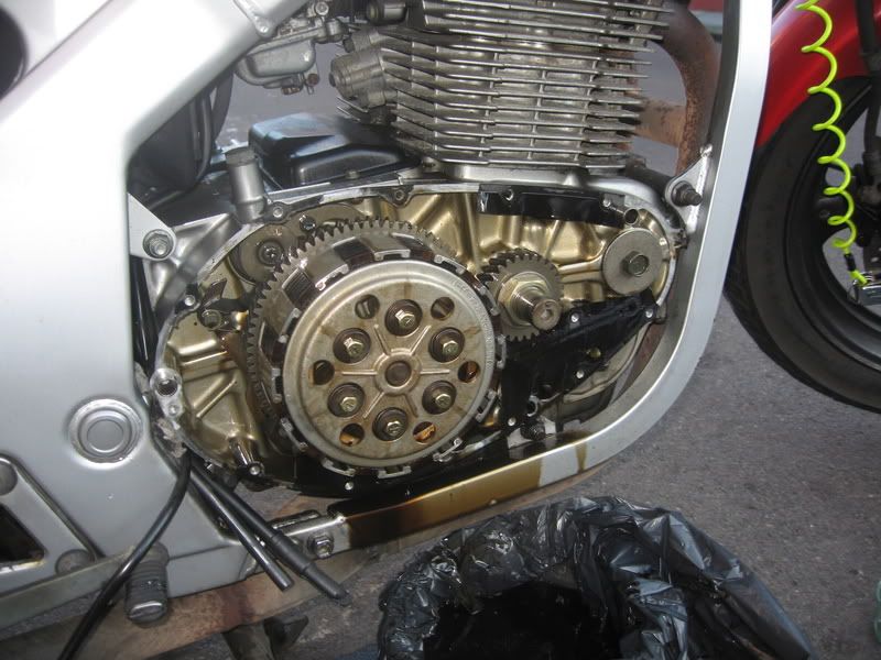

I did wonder that. He said it was a clutch cover but I agree that looks more like an alternator bolt through the hole.
If it's the alternator side (left of bike), I think the GS has a dry alternator. In which case a bit of gaffa tape will do the job as well as anything else.
PostPosted: 15:57 - 17 Dec 2009    Post subject: Reply with quote
I also wondered that but the looks to be the right side of the bike (judging by the frame) which is the clutch side but the casing doesn;t look right.
What do you think
