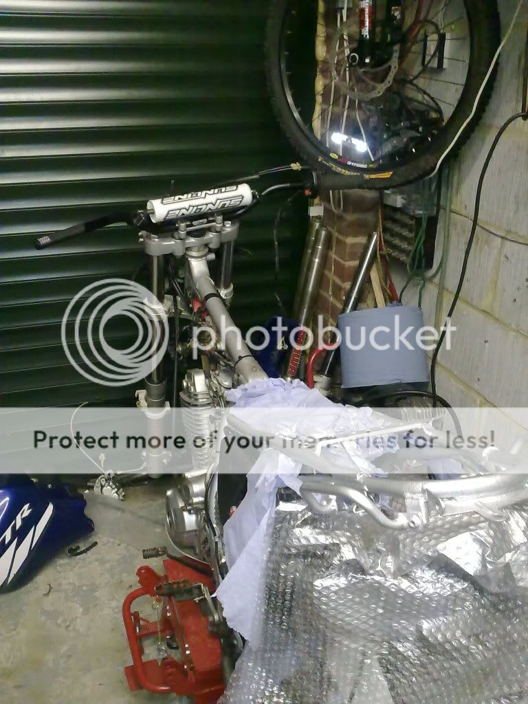

Bike has been completely stripped down, everything regreased etc. New fork bushes,seals, chain+sprocket, better bars list goes on.
https://i285.photobucket.com/albums/ll75/dr_klause/25022010095.jpg

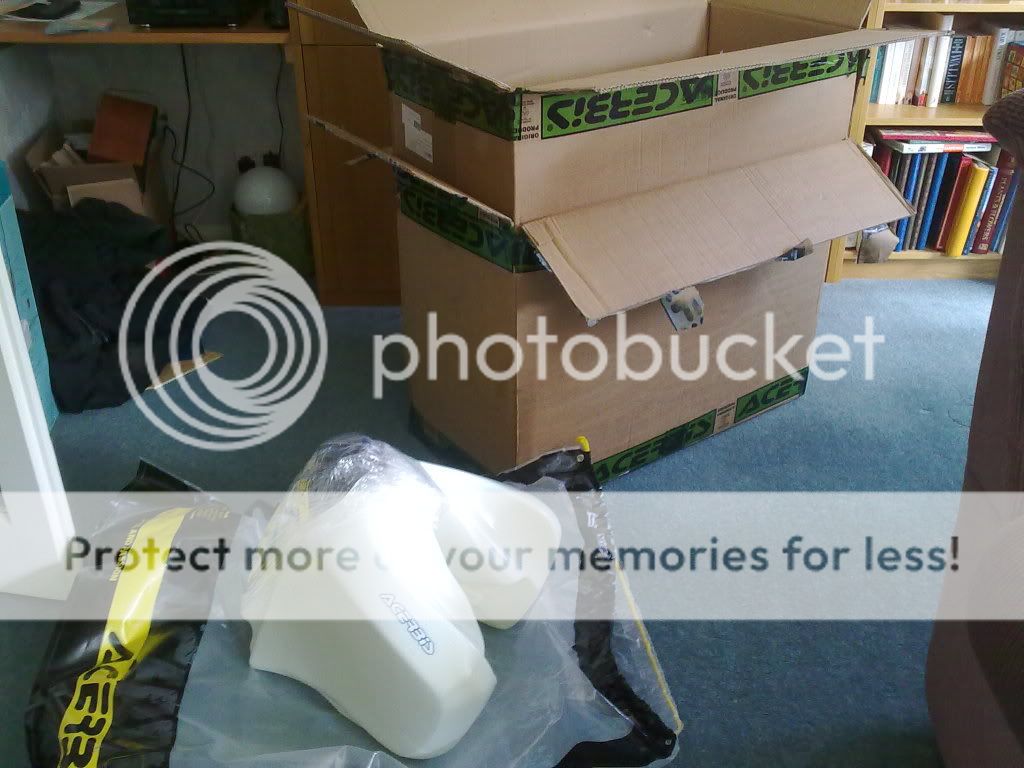

Long range tanks, 3 of them! (Mine,Stephs(gf), Lee)
https://i285.photobucket.com/albums/ll75/dr_klause/19022010093.jpg

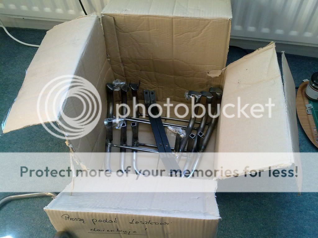

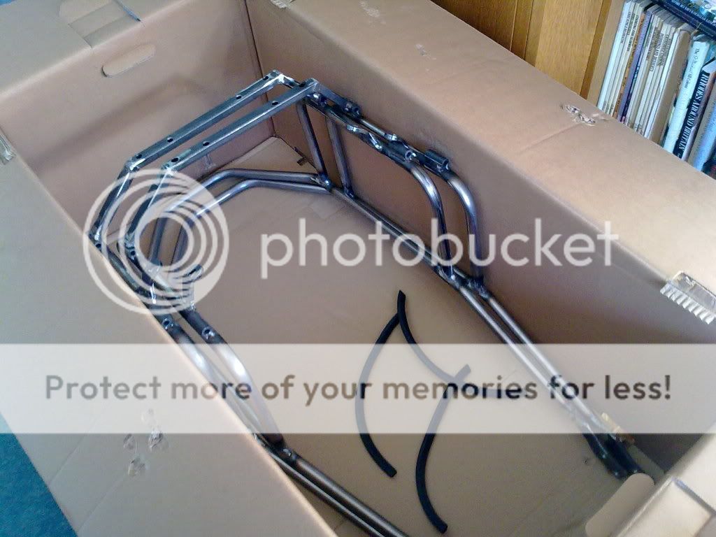

https://i285.photobucket.com/albums/ll75/dr_klause/01032010099.jpg

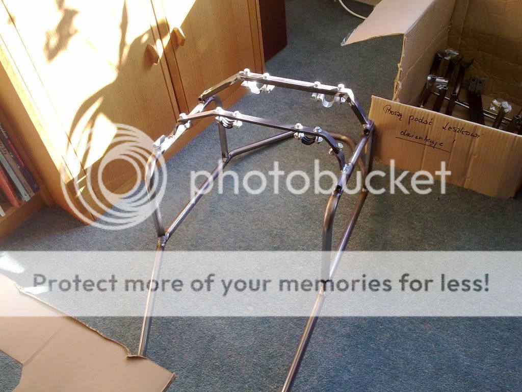

3 rack systems made to order, very exiciting!

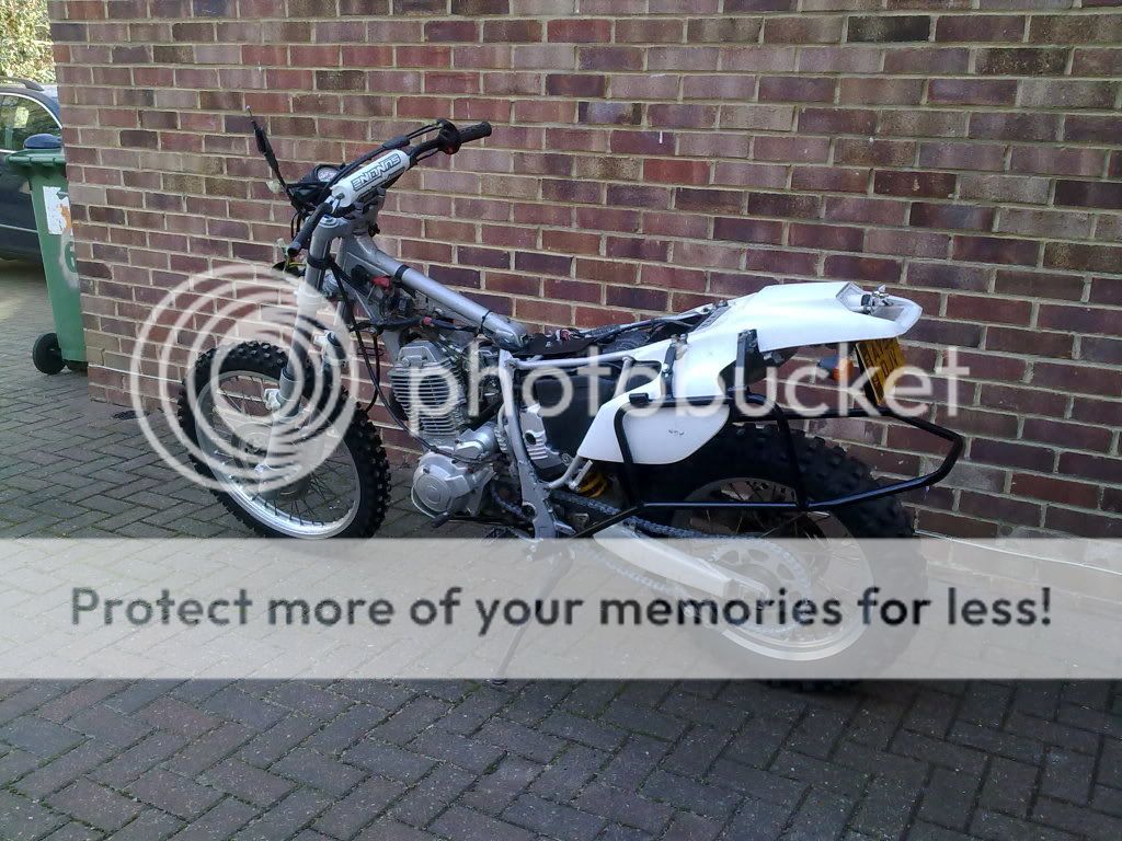

https://i285.photobucket.com/albums/ll75/dr_klause/05032010101.jpg
https://i285.photobucket.com/albums/ll75/dr_klause/05032010100.jpg
Bike is slowly getting there, Still need to prep Stephs but we've done most of that one too.
