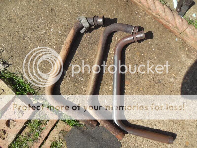

ok small update decided to remove the exhaust to see if it can be saved amazingly all the rusted bolts undid ok none snapped result 30 years old moden bike would have snapped lol
few holes and lots of rust hmmm

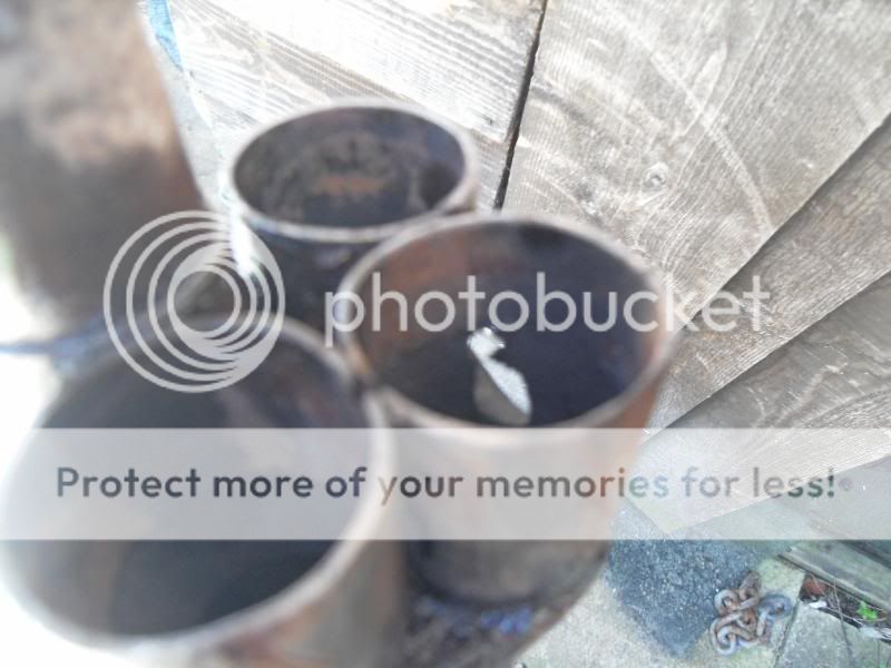

couldnt get the forth down pipe to seperate from the end can so ive soaked the join in deasel and letting it soak

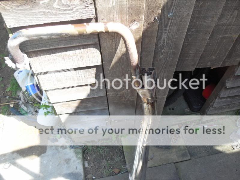

https://img.photobucket.com/albums/v336/mad4it028/SDC12239.jpg
https://img.photobucket.com/albums/v336/mad4it028/SDC12240.jpg

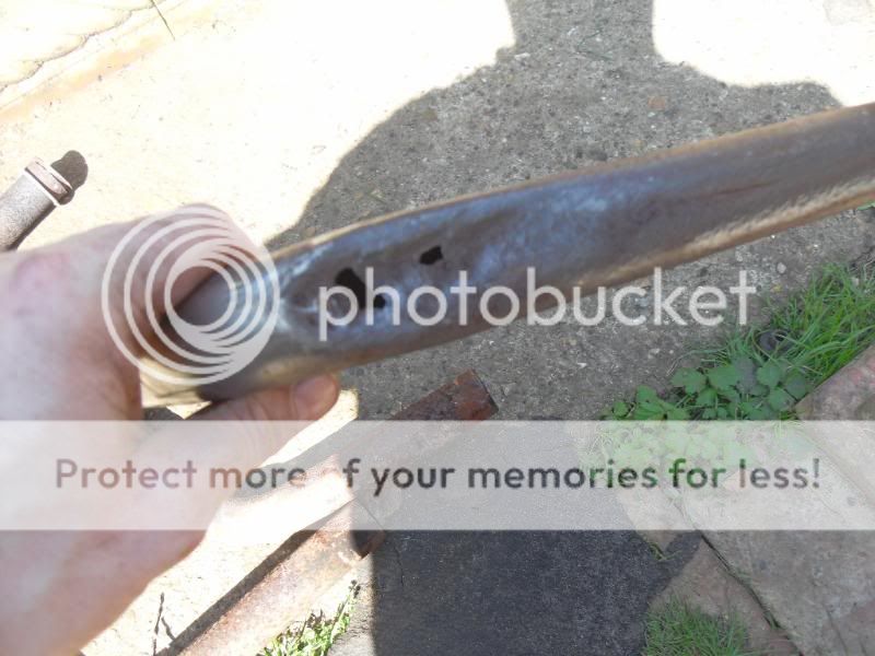

only 1 of the down pipes has holes
https://img.photobucket.com/albums/v336/mad4it028/SDC12238.jpg
im going to clean up and weld up the end can that will go again
but i think the down pipes are for the scrap altho my brother owns a powder coaters well half of one and says he has some nice high temp silver and black so this may do until i find some at the right price £250 is the cheapest ive found on ebay so far and i really dont want to pay anywhere near that at this stage of the project so for now weld up and powder coat will do it costs me nothing so worth a try and iif i get the bike how i want it towards the end i'll staRt shelling out some real cash
