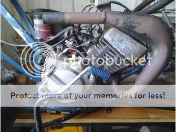

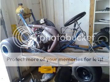

i have 2 photos of the kart to see anyone could spot what engine i have, that would be great, thanks
https://i34.photobucket.com/albums/d129/ll_sarah_ll/283807478.jpg
https://i34.photobucket.com/albums/d129/ll_sarah_ll/283807476.jpg
PostPosted: 13:00 - 02 Feb 2010    Post subject: Reply with quote
It is an H100S or S2 engine.
Put a filter on the carb. At the moment any grit will go in and cause damage, and the back tyre will probably fling grit straight at it. Will also run a bit lean due to the lack of filter which won't help things.

Just a thought, whats the gearing like? Idling fine, then having no power at all and cutting out in gear could be caused by being very overgeared (unlikely with the tiny wheels, but it may of been overcompensated)
PostPosted: 14:19 - 02 Feb 2010    Post subject: Reply with quote
Good point.
That looks like a way larger than standard rear sprocket. Possibly 15 teeth between the "spokes" of the sprocket so a 60 tooth sprocket (standard is 35, front is 15 and you can't squeeze in anything bigger).
Stock gearing an H100 does about 20mph at 8500rpm in 1st gear. 60 tooth sprocket would knock that down to 11.5mph. An 11" tyre diameter would knock that down to 5.5mph.
Could well be running out of revs at little more than walking pace in 1st.

i will head out and count teeth on the sprocket and ill get a few more pictures etc

alex25 wrote:
i believe the sprocket used is the H100
H100s use tiny rear sprockets (and still run out of revs). That looks way bigger than standard. Can you count the number of teeth?
Get hold of a strobe light and check the ignition timing. But also check the reed valves.

i think its up in high 50's , i take it that its wrong? its pretty hard to count when the chain is on lol
its been put on with a ton of weld also, lol
PostPosted: 17:32 - 02 Feb 2010    Post subject: Reply with quote
Way too large. Flat out an H100 does about 60mph. The wheels being smaller will lower the gearing by about 50% anyway, bringing the top speed down to about 30mph. Going from a 35 tooth (stock sprocket size) to one in the high 50s will almost halve that again.
Or put it another, the combination of larger sprocket an smaller wheel will land up making 5th gear lower geared than the stock 1st gear.
