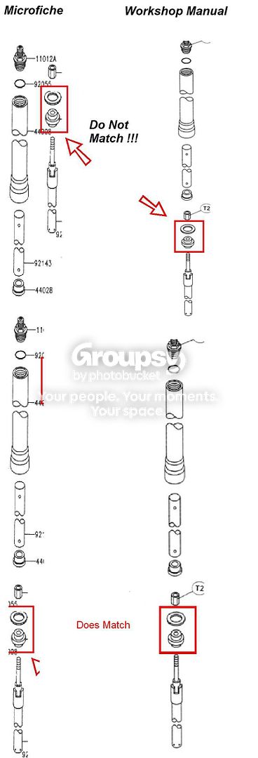

Can anyone else see this cock up?
CaNsA
Joined: 02 Jan 2008
PostPosted: 01:54 - 19 Feb 2010    Post subject: Can anyone else see this cock up? Reply with quote
Kawasaki microfiche Vs Kawasaki Workshop Manual
USD forks
https://i47.tinypic.com/2yv564i.jpg
https://i48.tinypic.com/30lcpvp.jpg
hmmmnz

I fail to see the difference other than the microfiche diagram is placed side by side rather than all inline, no doubt to save space on the microfiche. The parts are all the same and they're in the same order.
Billing
Joined: 12 Mar 2009
PostPosted: 04:59 - 19 Feb 2010    Post subject: Reply with quote
whoever put those together has put the washer and plastic bit the other side of the tubey bit. thats the only thing i can see thats different in the pictures.
the manual and microfiche show the same parts in the same order, but as said above, side by side in onw to save space Smile

The function of the pictures on the parts fiche are to make it easier to identify part numbers. It shouldn't be used as an assembly guide but having said that, the diagram makes perfect sense anyway. Thumbs Up
PostPosted: 12:00 - 19 Feb 2010    Post subject: Reply with quote
It just looks like the microfiche diagram has been elongated.
PostPosted: 12:06 - 19 Feb 2010    Post subject: Reply with quote
Agree with Phoenix. Both show exactly the same thing. Just that the fiche is showing it as 2 columns, so you go down the first column then down the 2nd column.

If anyone had only seen the workshop manual and tried to put the forks together, they would have screwed up their forks.
the workshop manual is very misleading and wrong
Pedd
Joined: 24 Mar 2008
PostPosted: 12:54 - 19 Feb 2010    Post subject: Reply with quote
Nope as said manual and micro fiche are the same (albeit fiche is side by side ) so if you can follow a diagram correctly then there would be no problem.

i cant even begin to guess how you misenterpreted the drawing.
PostPosted: 14:02 - 19 Feb 2010    Post subject: Reply with quote
Am I being dense it looks fine to me, looks like the person took built the fork in a photo has never followed a manual before.
PostPosted: 14:14 - 19 Feb 2010    Post subject: Reply with quote
Agreed, and would say if you put it together according to the fiche photograph (rather than as the fiche and manual say) then the plastic supporting bush (looks like it is there to support the damper rod half way along its length) and washer are going to be useless.

I guess its hard to see where its wrong unless you can see the diameters of each part.
Nothing will fit over the outer tube, the plastic spacer bit is supposed to just cover the end of the tube.
at least this thread shows who can see these diagrams in 3D Laughing
Is it? Because neither the parts fiche or the workshop manual show that.

Look at it this way
https://img.photobucket.com/albums/v295/chris-red/2yv564i.jpg
Chris - smarter than all the ZXR400 owners, in the wooooooorld.
Cool

the parts dont fit in that way,
and i like how you moved bits to make it work.
Rolling Eyes

I moved them into them into the same order as the workshop manual, so it might be easier to understand.
It is how you are suppose to read the mircofiche, look down the left tube them the bottom of that goes into the top of the right.
I'm pretty sure you are just being thick. Laughing

Maybe not, but that is the way both the manual and the fiche images you have posted show it.
That you are not meant to jump between the column on the fiche to get the order right is far more obvious when you look at the full fiche which has the forks in 3 columns (if you tried it the fork spring would sit on top of the fork).

exploded diagrams are read linear, not staggered.

this is how its done correctly, the way the microfiche shows.
Bear in mind that the 2nd column on the microfiche diagram shows what slides inside the outer sleeve, and dont forget they are USD forks.
https://www.zxrworld.co.uk/coppermine/albums/userpics/IMG_9815.JPG
PostPosted: 21:46 - 19 Feb 2010    Post subject: Reply with quote
Both diagrams are exactly the same. Look at Chris' post.
