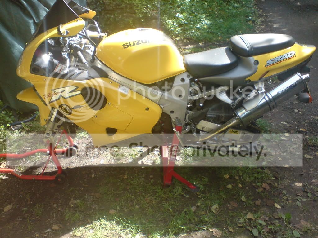

Like this......
https://i302.photobucket.com/albums/nn82/mr_fisty/DSC00967.jpg

PostPosted: 21:15 - 28 Feb 2010    Post subject: Reply with quote
mr_fisty wrote:
Just looking at the way you have your Abba stand set up. I use mine the other way round, ie the bike moves forward onto the stand, not back. Is there a right way and wrong way or doesn't it matter?
Triumph Trophy Launch Edition
PostPosted: 21:30 - 28 Feb 2010    Post subject: Reply with quote
You're doing it right, mr fisty is doing it wrong.
The weight of the bike is forwards from the stand, therefore the supporting legs at the bottom of the stand should be facing forwards.

The way the stand is angled, means the weight of the bike is behind where the stand is on the floor. It's the same way the bike would be supported if it was a fitted centre stand.
https://img175.imageshack.us/img175/3506/abbastan.jpg

I know i put the abba stand on the wrong way but there is a reason for it.
The front stand i never realised i was using it wrong but it does beg the question. How are you meant to remove the front axel with the metal plate in the way?

Abba stands: Polarbear is doing it right, mr fisty is doing it wrong.
Basically, do not put your bikes on an abba stand the same way as shown in the picture of that yellow TL because it is wrong.
I've just checked on the abba stand website and they have nice pictures showing how to correctly use an abba stand:
https://www.abbastands.co.uk/Images/Products/Display/superbikestand_2.jpg
https://www.abbastands.co.uk/product_details.asp?id=1
