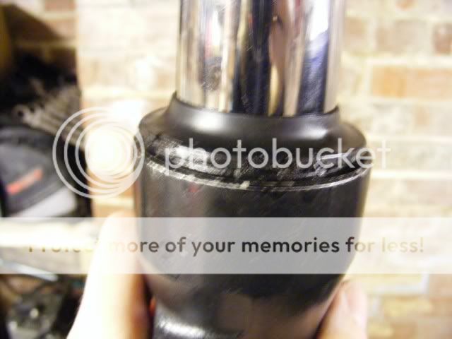

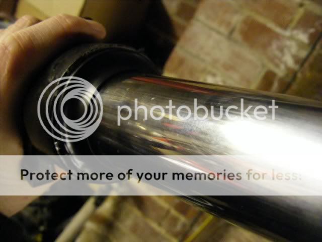

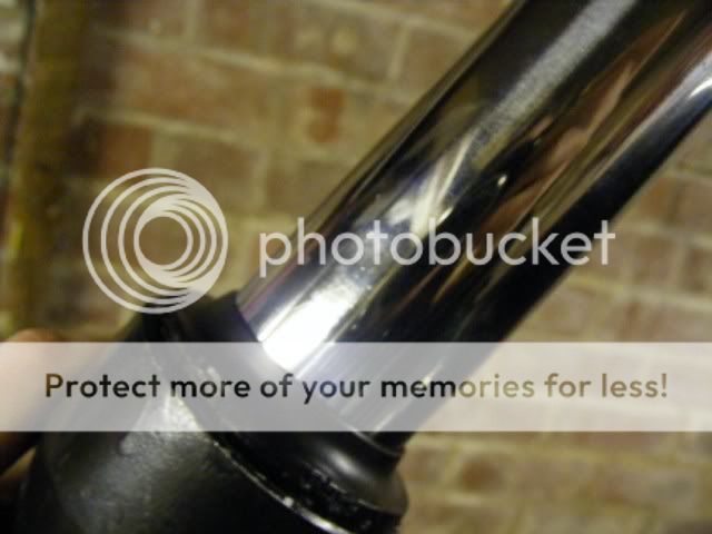

Right, I've got them off. The pits on them are very small, and you can only really feel them with your fingernail. Would pits this size still ruin a seal quickly?
https://i47.photobucket.com/albums/f186/markjackson13/DSCF0628640x480.jpg
https://i47.photobucket.com/albums/f186/markjackson13/DSCF0627640x480.jpg
https://i47.photobucket.com/albums/f186/markjackson13/DSCF0626640x480.jpg
https://i47.photobucket.com/albums/f186/markjackson13/DSCF0625640x480.jpg
For some reason the seal has been attacked on the right fork Neutral I sense trouble...
