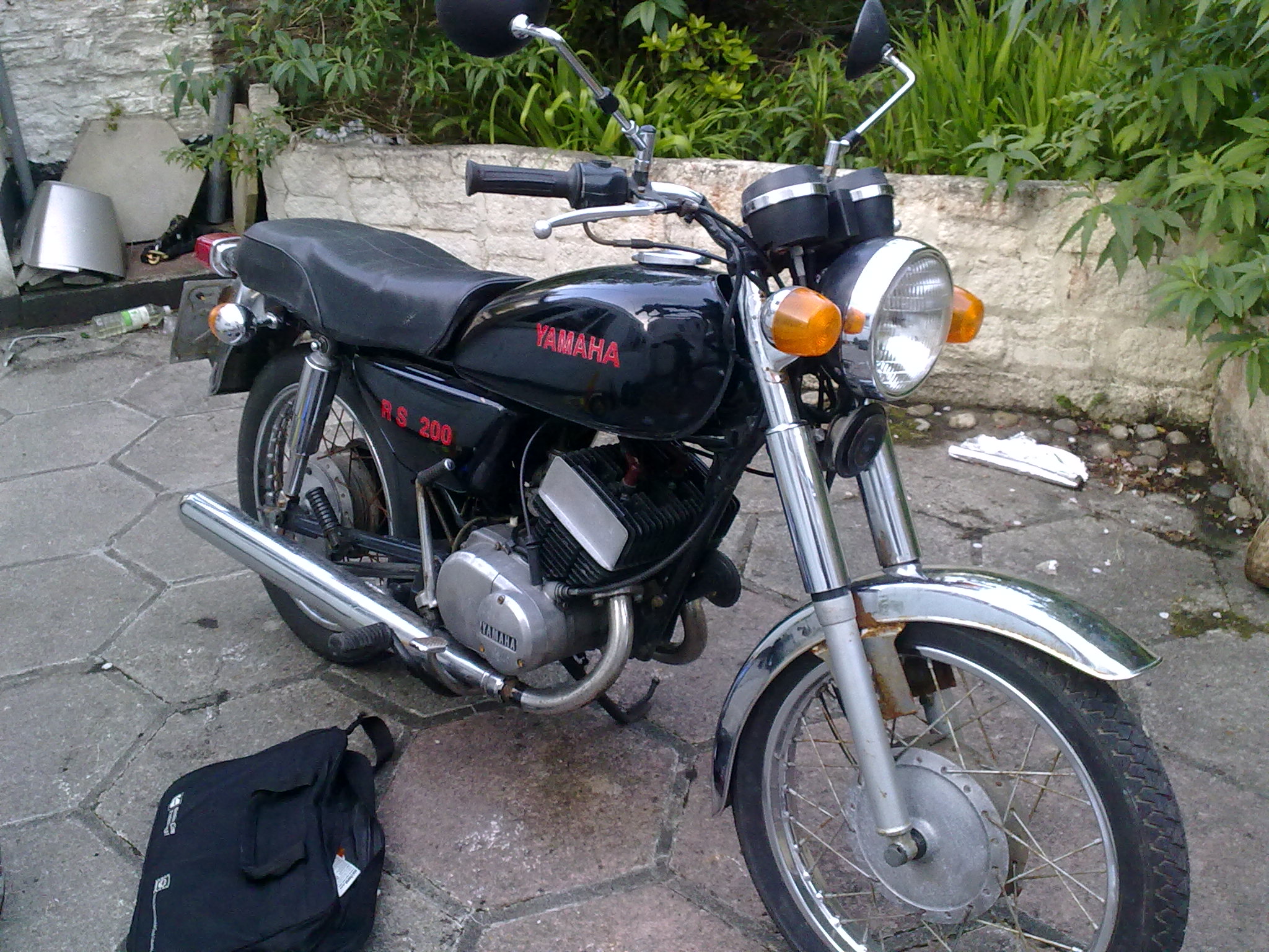

Spotted this thing in the local bike breakers and at £200 tax and tested it seemed like a worth while investment or something to play around with at least. Once i figured out that the fuel tap was off she fired up with a few kicks, the little twin cylinder two stroke motor made a fantastic little popping sound which made me smile like a little Japanese school girl.
