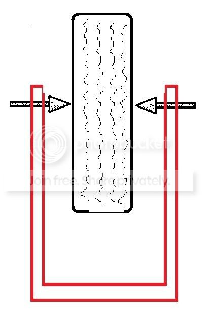

PostPosted: 21:19 - 23 Mar 2010    Post subject: Reply with quote
you could just make 2 tapered points that way it doesnt matter what size the bearings are

PostPosted: 22:00 - 23 Mar 2010    Post subject: Reply with quote
Thats the second option we figured getting the right sizes will make it more stable
PostPosted: 22:03 - 23 Mar 2010    Post subject: Reply with quote
That's what I was getting at, but personally I'd have them so they slide along a rod or threaded bolt rather than two separate ones.
Have them so that you can tighten them reasonably.

PostPosted: 22:58 - 23 Mar 2010    Post subject: Reply with quote
On professional balancers they just have 2 cones as in hmmmz's pic on a threaded bar with a nut behind so you can clamp the wheel in tight. Thumbs Up

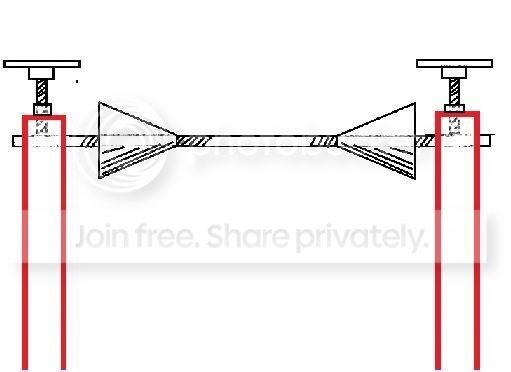

PostPosted: 00:34 - 24 Mar 2010    Post subject: Reply with quote
G wrote:
yeah that would be alot more stable, a 14mm threaded rod would work nicely

PostPosted: 00:43 - 24 Mar 2010    Post subject: Reply with quote
Unless they were the 10mm ones Kieth mentioned Smile. Suspect the front for the DNA 125 was under 14mm.

PostPosted: 00:48 - 24 Mar 2010    Post subject: Reply with quote
the only trouble i thought with having tapered ends would be that it would be too easy to over tighten it, but not tight enough and the wheel could move about.
if the part is in steps then it could slot into the bearing and not go anywhere.
i agree the tapered idea is easy so long as it isnt too much hassle to set up. although how often do you balance wheels at home??

PostPosted: 01:55 - 24 Mar 2010    Post subject: Reply with quote
just need some ultra mega low friction bearings and the rest is easy
how could you possibly over tighten it??
you would be tightening against your wheel bearings,
and between your wheel bearings there is a spacer,
well there is that, Very Happy 12mm threaded rod
the distance between the 2 tapers isnt huge, so probably wouldnt need a hell of a lot of strength

steven_191
Joined: 31 May 2009
PostPosted: 17:57 - 24 Mar 2010    Post subject: Reply with quote
yeah i was thinking about 10-12mm rod, cut 2 tapered parts and then secure them with grub screws. you would only really ever need to remove one.
id like to make it all out of stainless as well so it dont go rusty.
ill put up a thread when i get round to doing it.
the reason i was thinking of overtightening was because of a threaded rod. instead a straight rod and grub screws would be a perfect fit everytime. probably. Laughing
PostPosted: 18:04 - 24 Mar 2010    Post subject: Reply with quote
The only 'issue' to overtightening would be if your cone caused damage - otherwise wheels are designed to be tightened pretty tightly.
I doubt grub screws would manage to hold it quite so well, not that it really matters and it would be quicker to release.
PostPosted: 21:31 - 24 Mar 2010    Post subject: Reply with quote
Would depend on the cones. Make them too "sharp" and the stand a chance of jamming into the bearings.
steven_191
Joined: 31 May 2009
PostPosted: 18:57 - 26 Mar 2010    Post subject: Reply with quote
im doing a cut of 30 degrees and see how that goes. i realised about the tightneing up, it will easily take the pressure.
at the minute ive got a legnth of silver steel (1/2") and have cut and reamed a 1/2" hole in a test piece, and its a sexy fit. that should be accurate enough
was also thinking about grinding or milling a flat into either side of the shaft for the grub screws so that it wont damage the surface that the parts will be running on and it really is that close a fit it will bind. i had to clean up the shaft with some dishwashing cloth to get the surface clean enough for it to fit lol.
