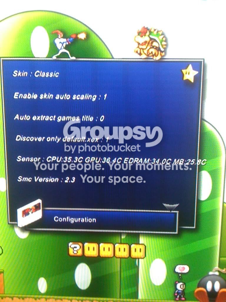

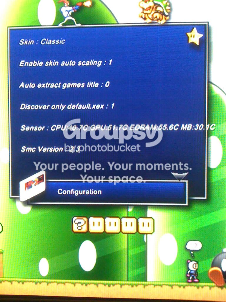

Tested by playing FFXIII for 10 mins, then quicklaunched to XexMenu to check the temps.
Most important one is the GPU due to the poor heatsink it has.

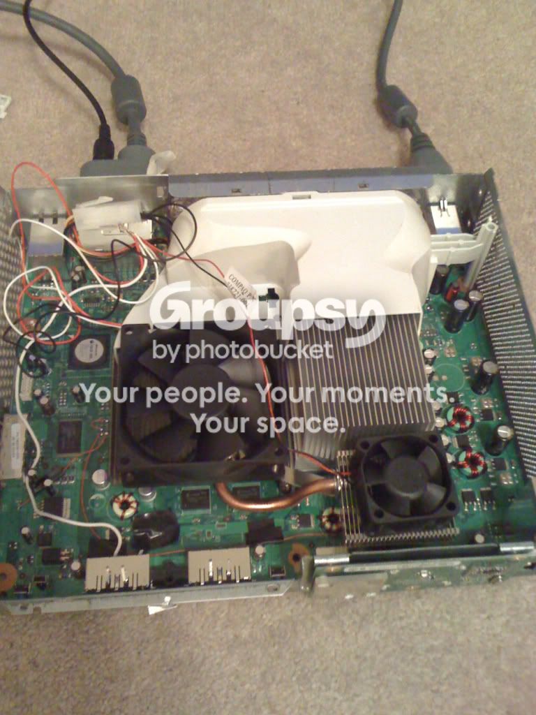

First job, X-clamps off, and old MS crud removed, heatsinks wet n dried, and a thin layer of silver arctic 5 paste, all bolted back in place.
next, an 80mm 35CFM fan for the GPU.
and a 40mm 20CFM for the secondary GPU.

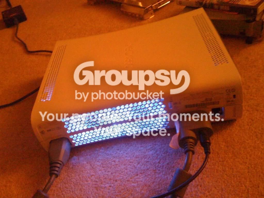

at the rear a set of Talismoon 46CFM blue exhaust fans.
These were modded to run at 12v rather than 6v.
Result.
https://img.photobucket.com/albums/v707/lllN30lll/4a679345.jpg
A little messy in this pic, but tidied up once refitting the case....

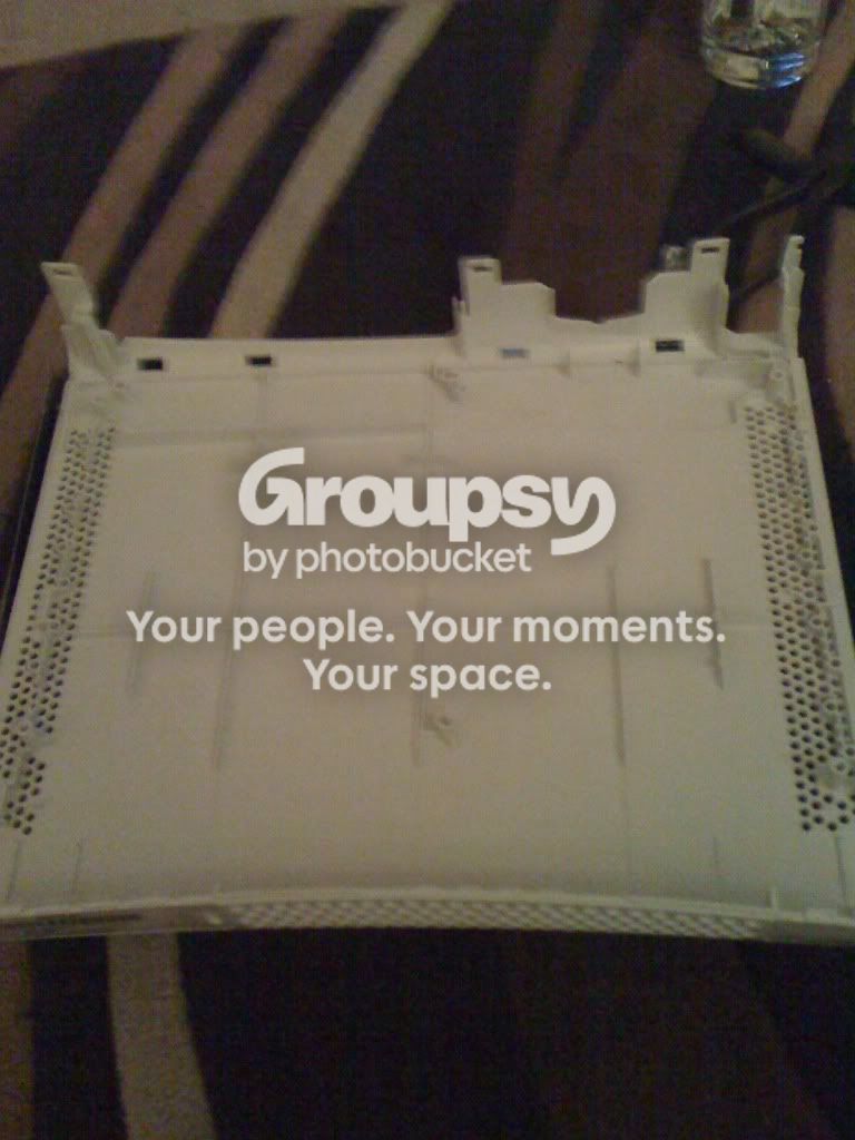

reflective shielding removed, and top shell modified to allow the secondary GPU fan to not get crushed.
https://img.photobucket.com/albums/v707/lllN30lll/2509b6b9.jpg

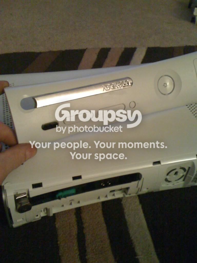

Front facia modified so there's no gaping gap where the DVD drive should be.
https://img.photobucket.com/albums/v707/lllN30lll/c8c955f5.jpg

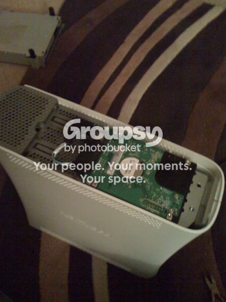

500gb drive internalised, the grill then fits over the top. ( i need somewhere to fit another 250gb too)
https://img.photobucket.com/albums/v707/lllN30lll/1d8d2783.jpg

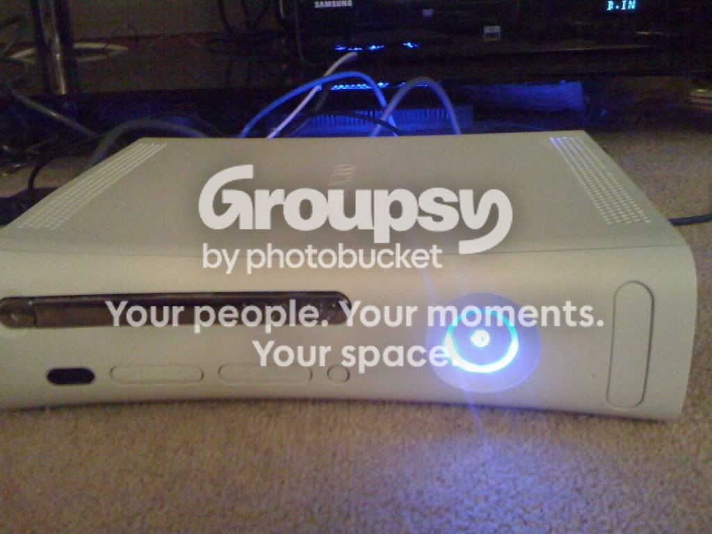

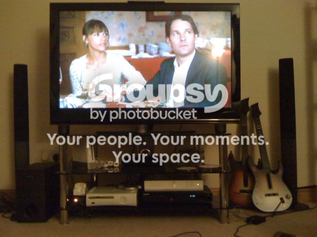

All back together, SORTED
https://img.photobucket.com/albums/v707/lllN30lll/52da1d7b.jpg
https://img.photobucket.com/albums/v707/lllN30lll/fc5e3699.jpg
https://img.photobucket.com/albums/v707/lllN30lll/eb9d33fe.jpg
end result after a bit of stress testing.
https://img.photobucket.com/albums/v707/lllN30lll/39c0f082.jpg

as for the screws being too tight, I experimented, forcing them as tight as they go set my temp to 61, loosening them off so they're just nipped up dropped it to 50.
