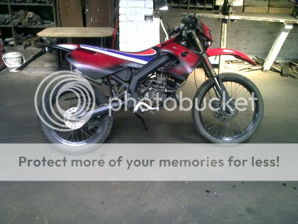

right back in mid 2009 i got may hands on a couple of derbi sendas both running like shit but was at the right price and came with loads off spares so snapped them up.
https://i293.photobucket.com/albums/mm73/alexwuk1/11082009116.jpg
wen i got home other the next week i got 1 running and mot ready and took for mot it was passed only after changing a folk seal and this bike had not been used in over a year so not bad, any ways i after a few weeks of ridig round on a standard bike i got board an got me self a few mods bigger mk carb 21mm and mk exhaust so was happy with this for a few month's and then i started researching this bikes on net 2 notice only a few that were heavily moded if any in the uk so i set my self the task of 1 building a 1 off and 2 burning a very big hole in my wallet (LOL)
frist thing i did was jot down some ideas on what was wanted and the main things that came to me was ktm, off road, show bike, 33bhp (high but trust me)
as i new i wanted my bike to be a 1 off i new that i was gonna spend every weeks working penny on it and a lot of my free time doing this bike.
my main parts i wanted 2 add was 80cc big bore kit uprated crank
koyo bearings,1 off frame, powder coating mad and a few other bits and tweeks.
keep your eye out for more info as i get chance to blog it

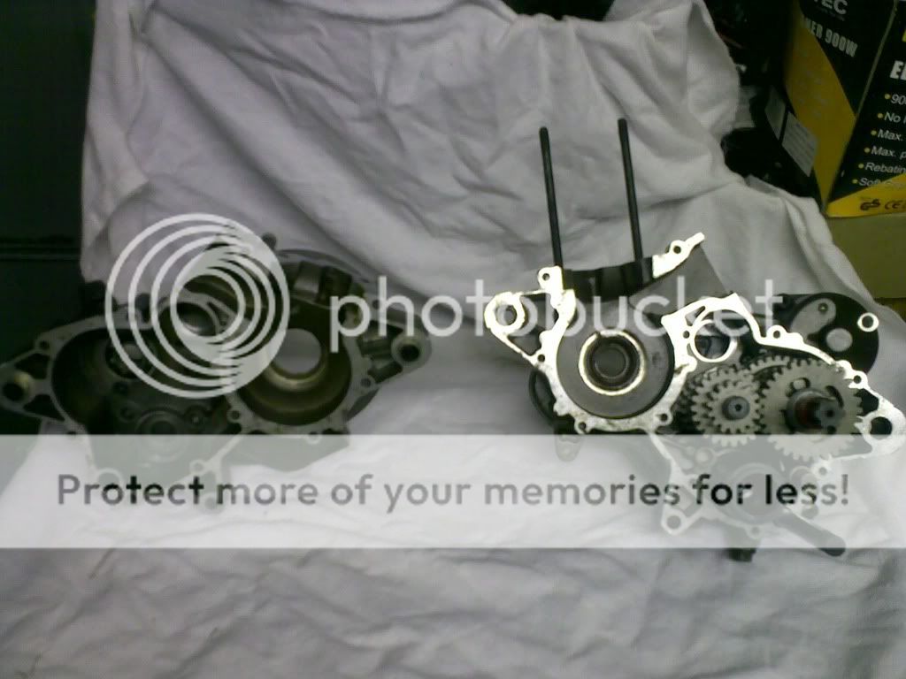

so while my frame was away i ordered new barrel kit 80cc polini 150 squid an lower end race kit with webbed and weighted crank koyo bearing ang all lower gaskets another 150 quid so while i waited for these 2 be delivered i riped old engine bear and took all componets 2 work 2 put in or wash of bay did this and they came up like new the day after i returned home from work 2 find a few parcales waiting they were all of the above while inspecting then i noticed the porting on barrel was twice as big as that on the crankcase so out came mr dremmal and i matched the ports and polished the crankcase and barrel
https://i293.photobucket.com/albums/mm73/alexwuk1/derbi%20senda%20ktm%20rep/03092009138.jpg
before
https://i293.photobucket.com/albums/mm73/alexwuk1/derbi%20senda%20ktm%20rep/04092009139.jpg
nearly done bits off ploshing left the finshed item was like a mirrow it was that polished

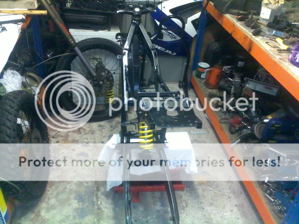

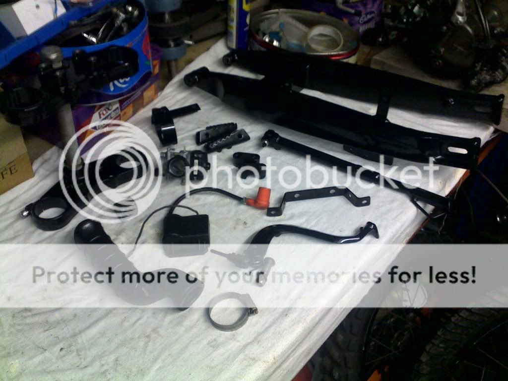

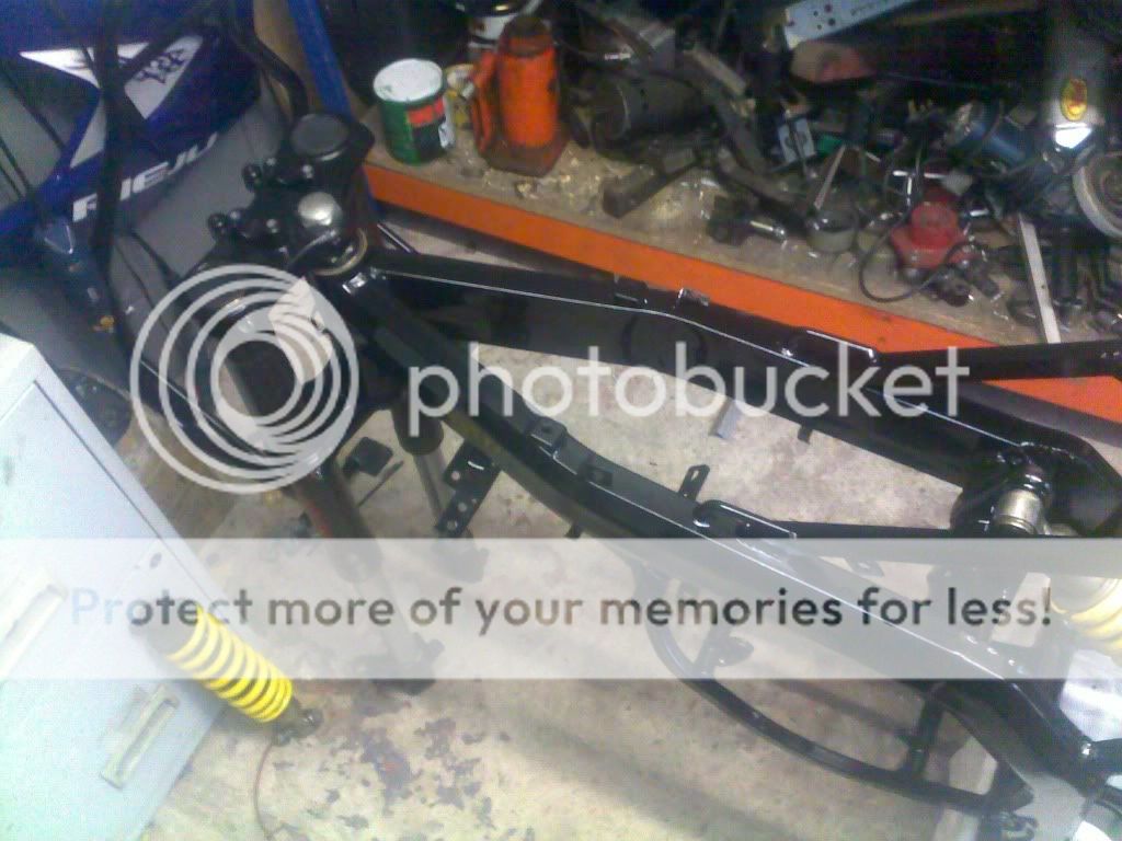

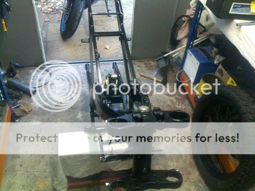

after i finshed porting i re built with new crank bearings and gaskets also added heavy duty clutch,seals, bore kit, small end race roller bearing by koyo again, crank,polini reed valves,15tooth front sprocket for now,21mm rubber inlet.
next was frame back
https://i293.photobucket.com/albums/mm73/alexwuk1/derbi%20senda%20ktm%20rep/20112009019.jpg
now the rebuild can start Very Happy Very Happy Very Happy
https://i293.photobucket.com/albums/mm73/alexwuk1/derbi%20senda%20ktm%20rep/20112009020.jpg
https://i293.photobucket.com/albums/mm73/alexwuk1/derbi%20senda%20ktm%20rep/20112009021.jpg
https://i293.photobucket.com/albums/mm73/alexwuk1/derbi%20senda%20ktm%20rep/20112009022.jpg
https://i293.photobucket.com/albums/mm73/alexwuk1/derbi%20senda%20ktm%20rep/20112009023.jpg
https://i293.photobucket.com/albums/mm73/alexwuk1/derbi%20senda%20ktm%20rep/20112009025.jpg

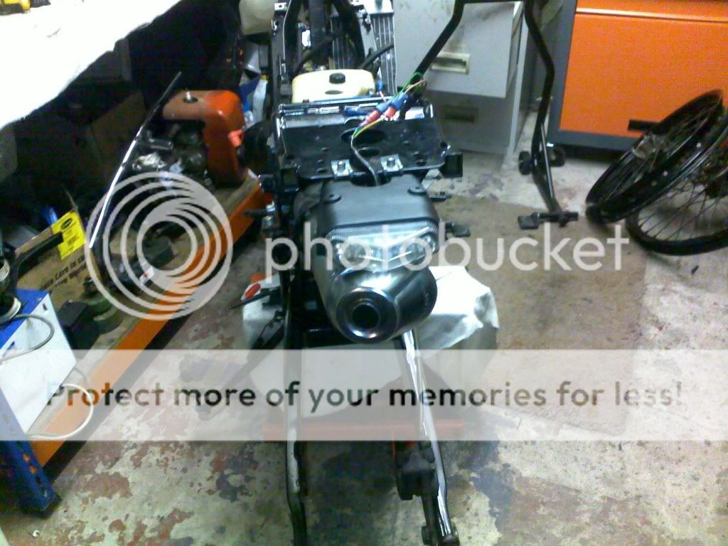

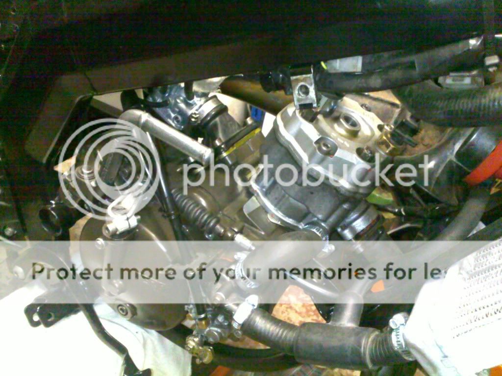

then the power plant was fitted
https://i293.photobucket.com/albums/mm73/alexwuk1/derbi%20senda%20ktm%20rep/02122009067.jpg
fitted just nicley

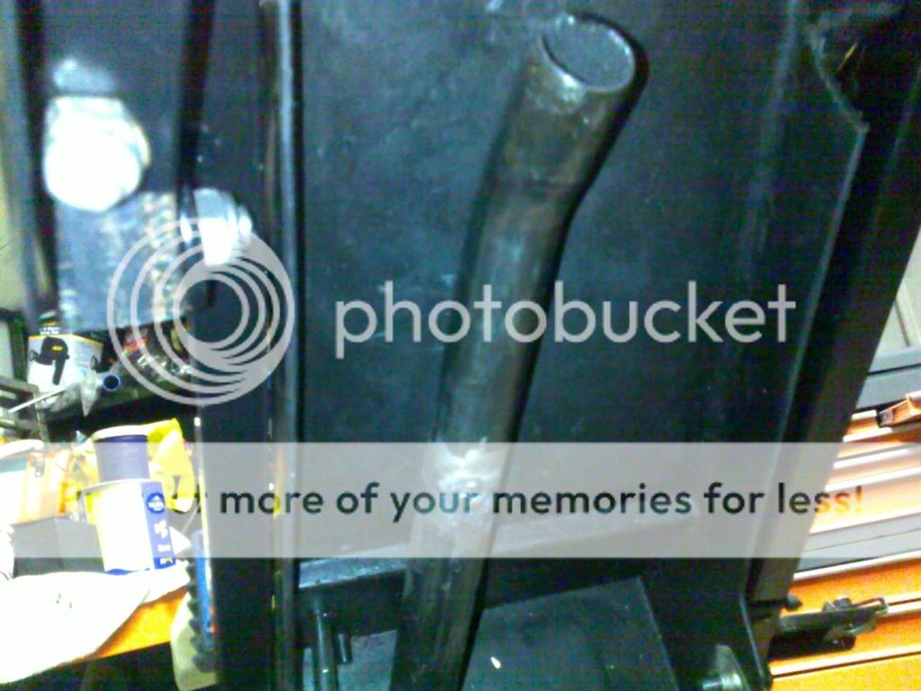

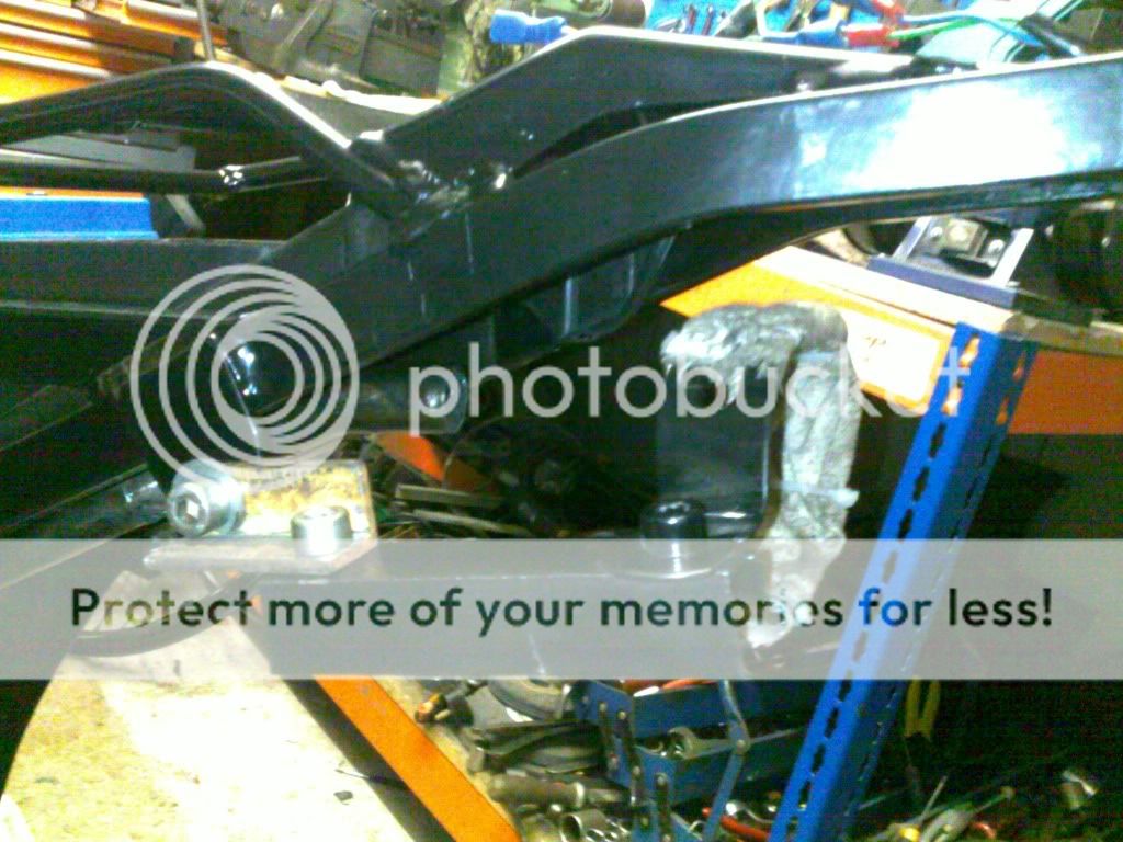

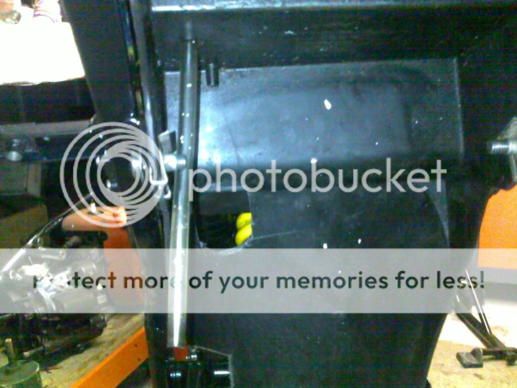

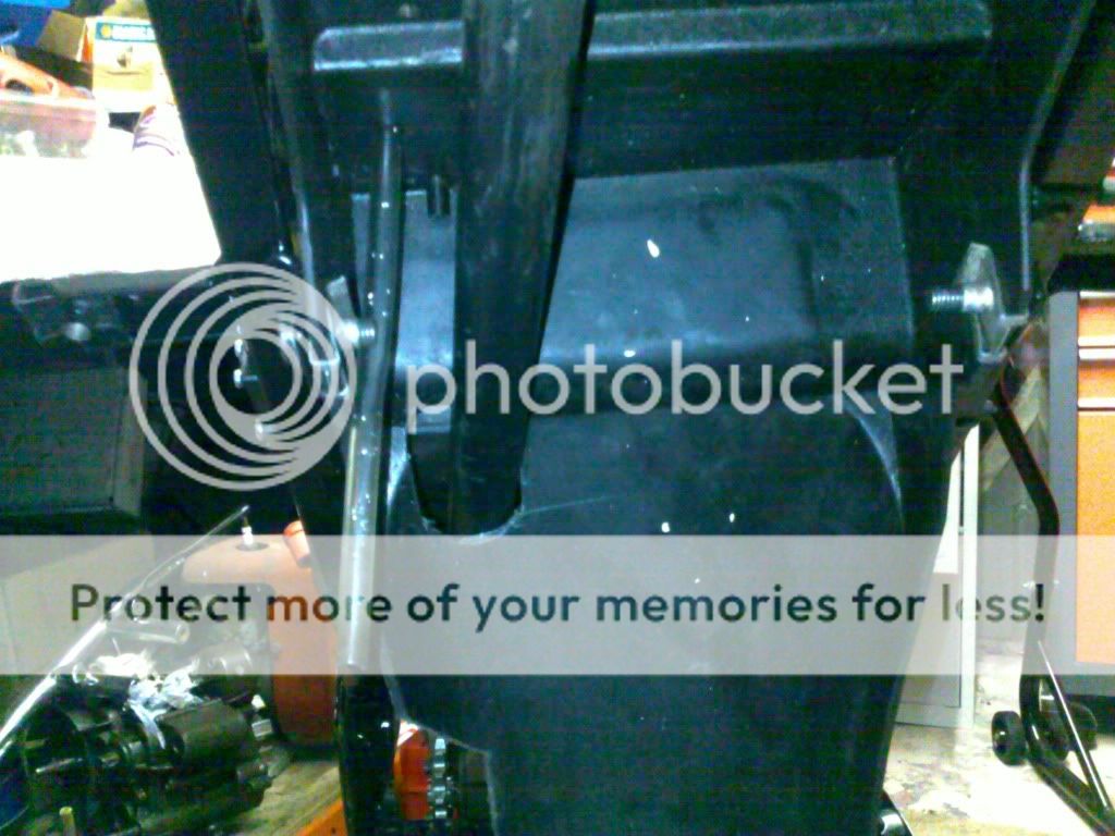

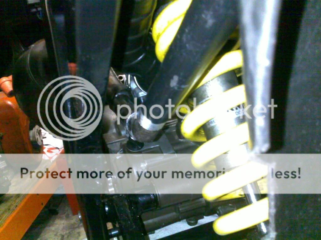

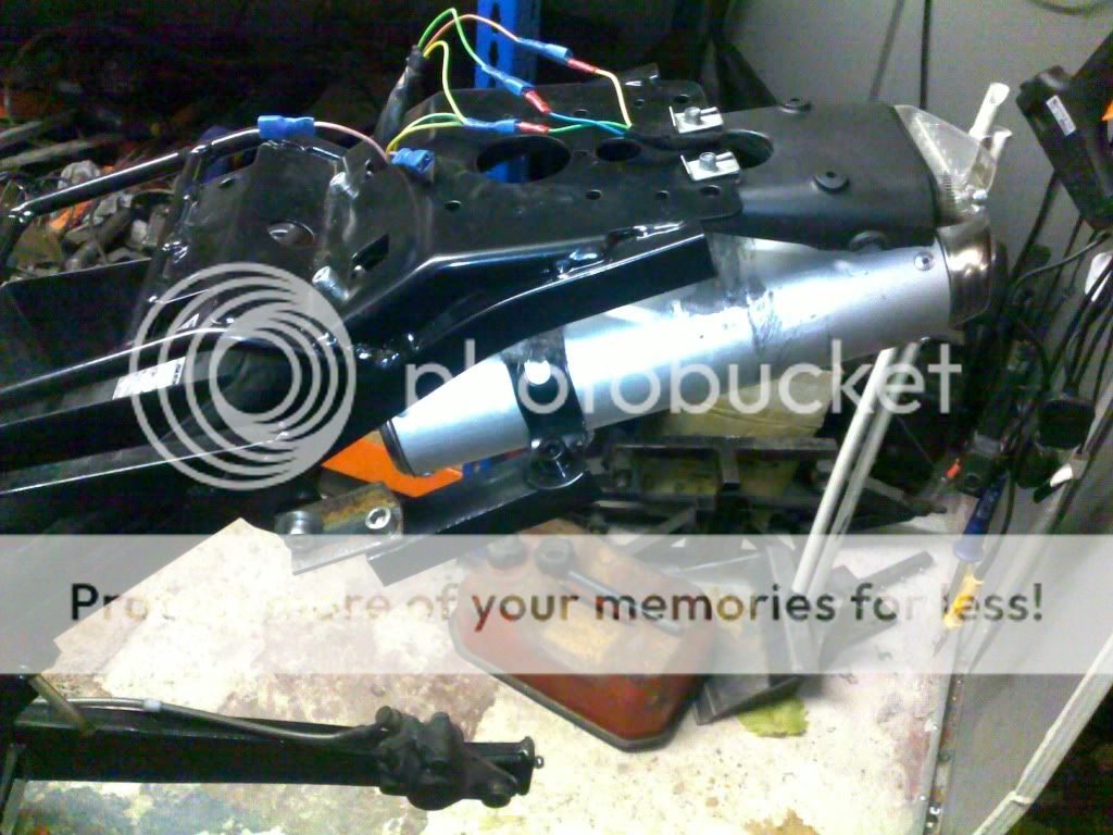

right so next up was my 1 off exhaust, this was going to turn out bad or look the dogs. i always wanted to make an custom under seat exhaust so that i did cutting and welding pipe so it would join the expansion to the end can
https://i293.photobucket.com/albums/mm73/alexwuk1/derbi%20senda%20ktm%20rep/02122009056.jpg
frist step was to cut hole thuoth rear inner gaurd for pipe to run up to the can
https://i293.photobucket.com/albums/mm73/alexwuk1/derbi%20senda%20ktm%20rep/02122009060.jpg
tacking up first bend
https://i293.photobucket.com/albums/mm73/alexwuk1/derbi%20senda%20ktm%20rep/02122009059.jpg
https://i293.photobucket.com/albums/mm73/alexwuk1/derbi%20senda%20ktm%20rep/02122009058.jpg
https://i293.photobucket.com/albums/mm73/alexwuk1/derbi%20senda%20ktm%20rep/02122009057.jpg
tacked to rear bend
https://i293.photobucket.com/albums/mm73/alexwuk1/derbi%20senda%20ktm%20rep/02122009062.jpg
https://i293.photobucket.com/albums/mm73/alexwuk1/derbi%20senda%20ktm%20rep/02122009063.jpgthen made a bracket for rear end can
https://i293.photobucket.com/albums/mm73/alexwuk1/derbi%20senda%20ktm%20rep/02122009064.jpg
https://i293.photobucket.com/albums/mm73/alexwuk1/derbi%20senda%20ktm%20rep/02122009065.jpg
wala tacked up and then welded up fully
i then took all parts to work and used our flexy dremal to power flow the expansion and the pipe i mad for maxium flow.
i then gave the expansion pipe 16 coats of vht clear and the center pipe and end can 10 coats in vht black, just left the crome end tip.

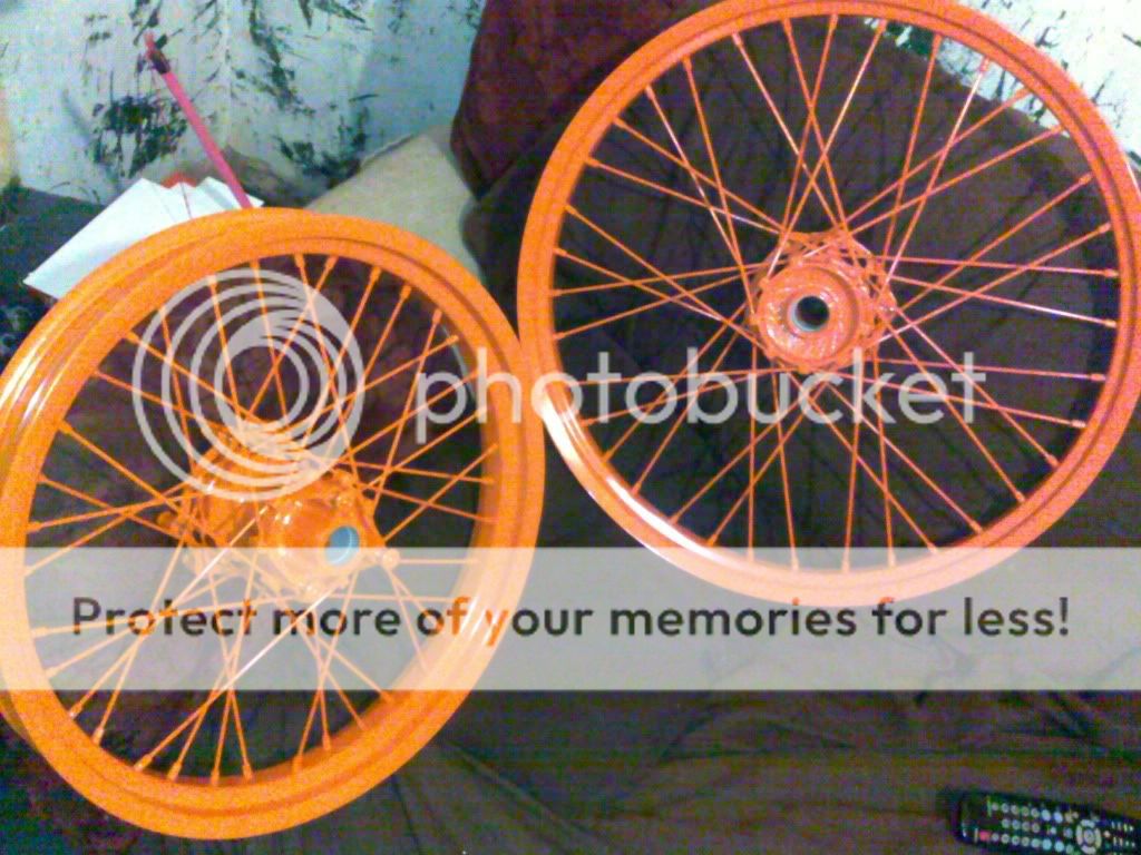

next came the wheels, i striped them down cheeked for buckals and sent of to imf darlo to have them powder coated orange. came back looking stunning and only cost 50 quid for the pair
https://i293.photobucket.com/albums/mm73/alexwuk1/derbi%20senda%20ktm%20rep/15122009116.jpg

Isn't your under seat plumbing going to melt your rear light and probably loose you a fair bit of power. 2 stroke exhaust systems are pretty exact things and length, width, angle etc are all precisely worked out to give optimized power output.
Dave
alexwuk
Joined: 05 Jan 2010
PostPosted: 22:37 - 09 Jan 2010    Post subject: Reply with quote
Dave
hi dave no rear light and inner mudguard are gonna be coated by heat foil as for performance a man in the states did simular and his performed better so it might be pick of the draw an that 1
PostPosted: 23:26 - 09 Jan 2010    Post subject: Reply with quote
This.
Plus you said you dremeled the exhaust for better gas flow yet I can see an awful straight cut in it at the rear shock which would do it no favours.
