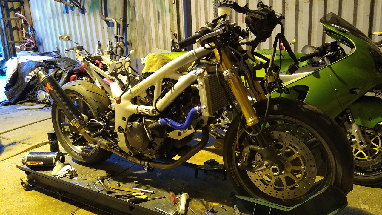

Motor is in the frame and bolted with carbs in place, have been doing lots of little odds and ends when I have time.
https://i.postimg.cc/vmqSc7ph/IMG-20191211-151737275.jpg
It doesn't look very much further on but it's vastly further on than it was. Exhaust is mounted up, it's a bit of a lash up but is only missing the rear hanger. This is to get it fired, an M4 system is on the shopping list.

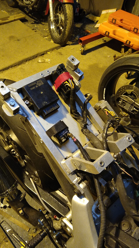

I made a sheet aluminium undertray for it and have the components in place. I'm in the middle of chopping/repairing the loom to fit.

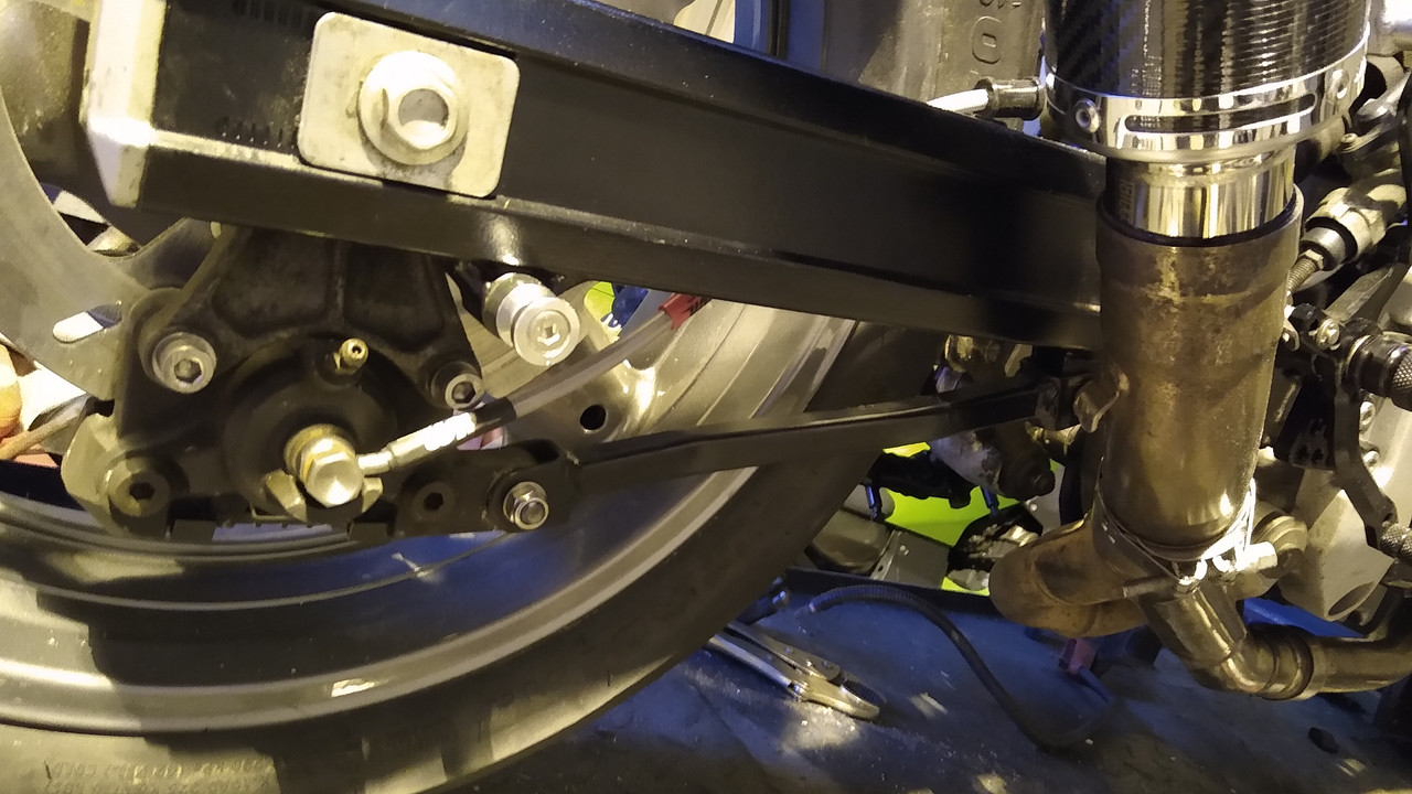

Stripped and painted up the rear torque arm for the brake and got it refitted with a new braided line.

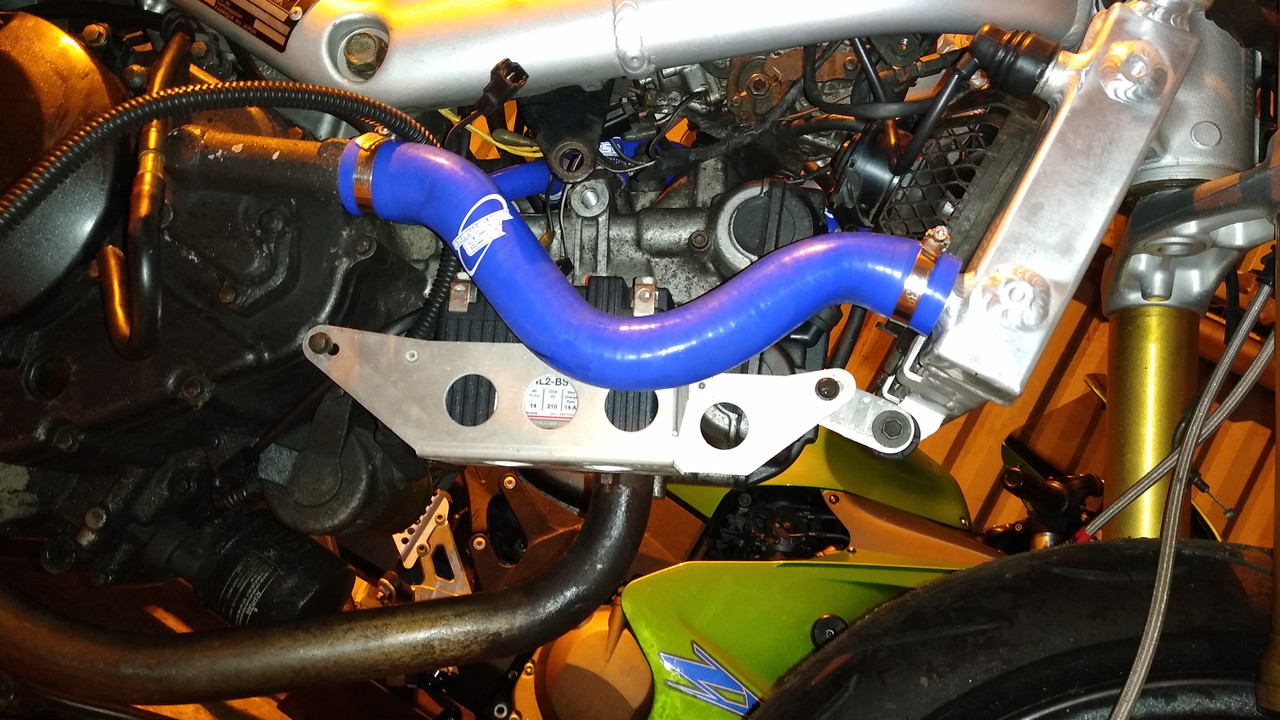

Front cylinder battery tray mounted, with an extra little bracket to retain the rad as it is a slightly enlarged item over stock and doesn't sit as far back as the original. Rad also has the fan/temp switch moutned now. I may remove it if it doesn't run into cooling issues though, to save weight.

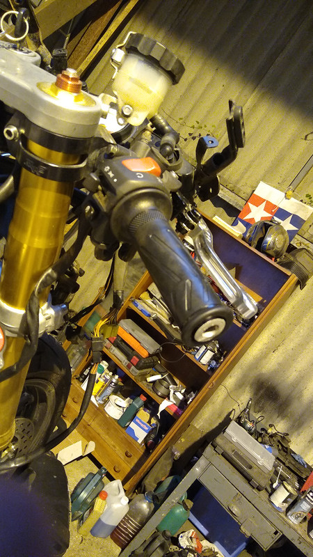

Cheap hack 1/4 turn throttle tube installed. It's a 2004/5 R6 -5slb?- tube which fits in thev standard housing but has a larger cam, dramatically cutting down the SV's 'learner friendly' throttle travel.

Gotta say, I'm not keen on those blue rad hoses. Or are they designed to handle higher pressures or something?
lilredmachine
Joined: 24 Jan 2005
PostPosted: 23:58 - 13 Dec 2019    Post subject: Reply with quote

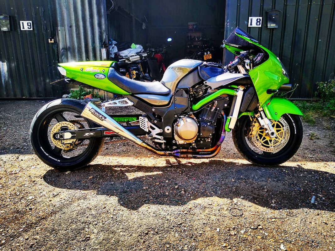

Pretty much. You ever seen the green ones on my Kwaka? Laughing
https://i.postimg.cc/TPzhjdYB/67877639-10157531631673485-2160713092164485120-o.jpg
