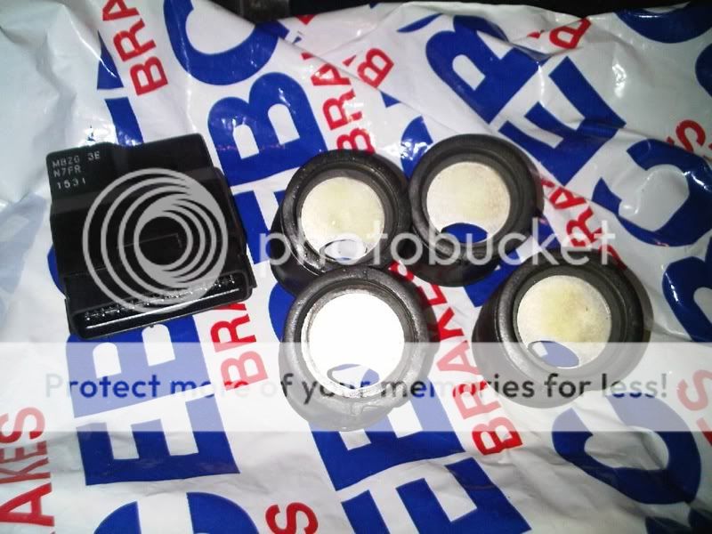

i dont know exactly, but if the carbs are the same then i suppose...
heres a pic of my ones in case you want to compare.
https://i2.photobucket.com/albums/y41/doovydoo/kit.jpg

hmmm they look the same ish

btw where can i get a cdi? did you ever run 33bhp wit normal cdi to compare with the 33bhp one?
Doovy
Joined: 21 Jul 2008
PostPosted: 16:03 - 03 Apr 2010    Post subject: Reply with quote
yeah they are the same.
i dont know where to get the restricted CDI from seperately, mine came with the rubbers from the local Honda dealer.
unfortunately i didnt ever run it with JUST the restricted washers with a normal CDI, only ever restricted rubbers/restricted CDI and then normal rubbers/normal CDI.
i know people do run with just the washers though, the CDI is only really to make the bike run healthier at 33bhp instead of trying to force too much power through i.e it is limited electronically too.
should be fine tbh.
but dont ride the bike de-restricted and then put the washers in, or you will feel so depressed.

i replied on the hornets nest Smile
its just taking tank off, airbox off and swapping the carb rubber inlets and swapping the ECU.
