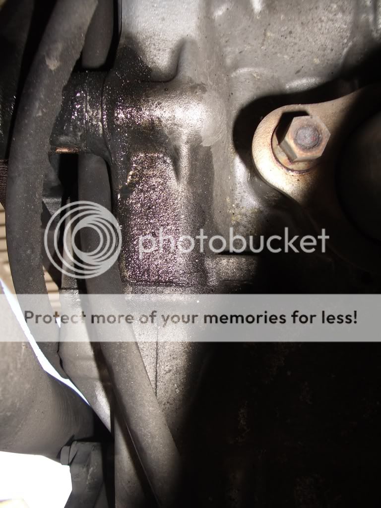

I noticed a few weeks ago that my oil had started to get low. I don’t check it very often because it’s never used any throughout my ownership. That should have been enough to ring alarm bells.
Anyway I kept it topped up and finally got around to an oil change today. Took off the right hand panel to give access to the drain plug and oil filter and saw this:
https://i221.photobucket.com/albums/dd227/serendipity_uk/CBR954RR/IMGP6774.jpg
Just next to where the R&G attaches to the upper engine mount it seemed to be all damp with oil. Looking from below it can only be coming from the head gasket right?

Doesn’t look like much oil, but I suppose some could be leaking into the cylinder and getting burnt off.
So is my guess right? Is the gasket? Do I try and fix it myself of give it to my local dealer and wave goodbye to a stack of cash? Cheers.

I would degrease it first then check it again to see where it's coming from.
oil doesnt go up.
When in a mist and wind assited it can. That's what I saw when the head gasket went on my Divvy a few years ago...
However, your words have a ring of good sense to them. I will degrease the area and check again in a few days.

Probably, you can sort it (assuming the head gasket is at fault) buy getting the cam cover off and retorquing the head bolts.
